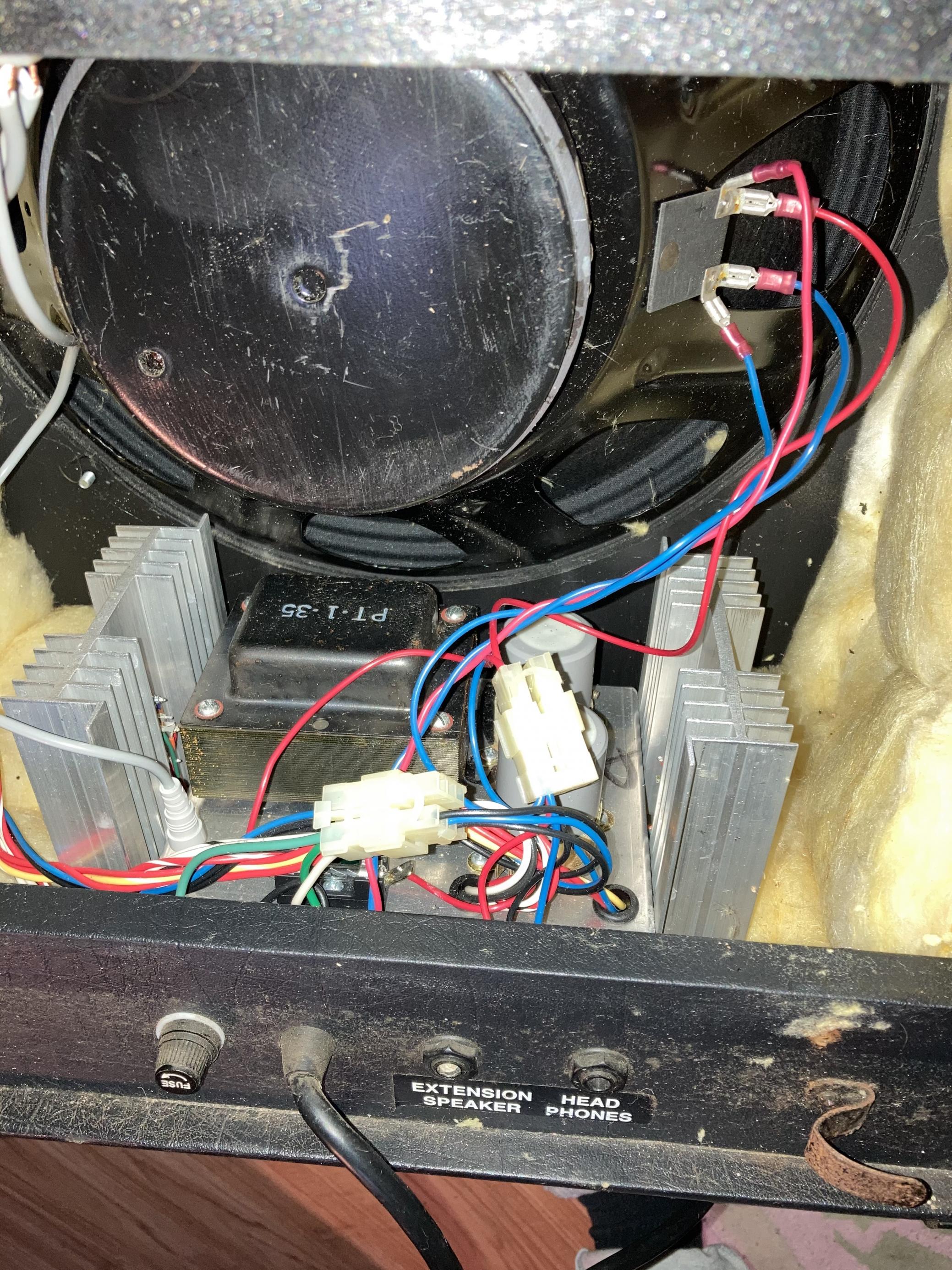

I want to connect my Polytone MiniBrute IV combo to a Polytone Pro Series Cabinet I found.
My question is, is my plan good, how to improve my plan? Thank you.
MY PLAN:
cut and resolder/shrinktube the 4 wires that make up the existing parallel circuit to the internal 15" and the EXT OUT jack, from that junction add a new pair of leads for the SERIES loop to the internal 15" and a NEW JACK w/SHUNT (1/4" switchcraft w/shunt). I will leave the HEADPHONE jack wired, but will stow it securely inside the box. The NEW JACK will go in the hole labeled HEADPHONE. I will add a label that says SERIES OUT.
I don't know why, move more air, fill out the tone, or just because it seems like these two old PTs belong together and there are some funk parties on the horizon
AMP:
Polytone 100w 3ohm
there's a single 15" 3ohm speaker in the combo.
"EXTENSION SPEAKER" jack [parallel to the 15" internal speaker] and some other jacks, I'm thinking of highjacking the HEADPHONES jack for an additional extension in SERIES (see below)
CABINET:
2 jacks
1st reads 8ohms - connected to a 8ohm 12" Eminence
2nd reads 4ohms - connected to a 4ohm 8" + 2x 8ohms tweeters​
Some calculations (courtesy geoffthegreygeek) show the most effecient (and safe) way to plug them all in would be to connect in:
SERIES the 15" 3ohm and Jack1 cluster (8" 4ohm +2tweeters in parallel 8ohm each = 4ohm) For 7ohms
and
PARALLEL the 12" 8ohm, 8ohms
My logic: this arrangement evenly distributs the power of the amp across all speakers, and the output Imp is 3.73 - only .73 over optimal
Is this a good idea?
Thank you

Probably not.
Just because you have a reading of the DC resistance of your drivers doesn't mean you have a complete impedance plot. At certain frequencies, drivers can draw much more current than the DC resistance would indicate. If this is an instrument amp, as the moderators have decided, then a single frequency may be the intended load.
It appears is if your device has 4 output transistors, this may not be 2 ohm capable. So you might damage them.

If I only add the 12" 8ohm I get a Total Imp = 2.18ohms
72% internal speaker, and only 27.3% power going to the 12" extension
If I add plug in the 12" 8ohm in parallel AND ADD the 4ohm 8" in series I calculate a Total Imp = 3.73ohms
and the drivers get 22, 30, 46% power respectively, seems more even.
Is this safe to try and experiment with?

No, only your own output transistors. Only $5 apiece, plus all the upstream components they can blow with rail voltage released from the base terminal.

My CS800s amp that is capable of 2 ohm loads, two parallel 4 ohm speakers, has 5 pairs of output TO3 MJ15024/25 transistors, per channel. How many pairs of output transistor do you have? One? Two? TO3, TO247, or TO220?
In this string, the beefy Fifteen is getting 3/7 or less than half of the power. Actually since the tweeters *must* have series caps, over most of the range the mighty Fifteen takes 1/3rd of power, the small Eight gets 2/3rd. The Eight will melt before the Fifteen speaks well.
If the internal speaker is 3 ohms, I would suggest not to add more speakers. This may probably damage your amp at high volume levels (and also the party?) Go with another amp to use these speakers. OR disconnect internal speaker to use the external ones. Regards.
