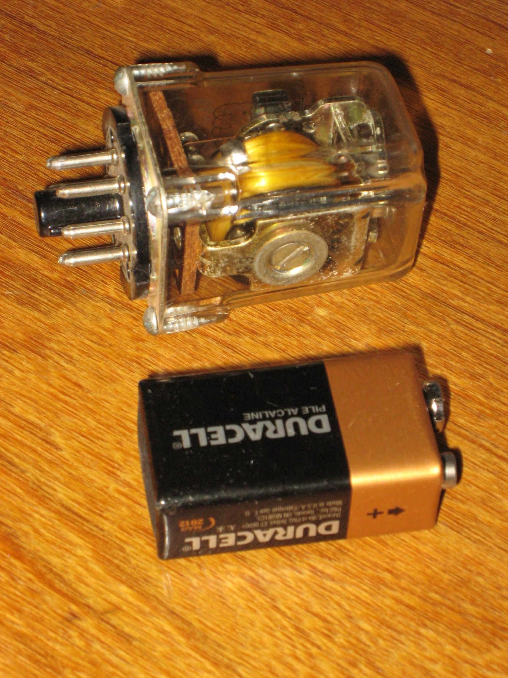

Next is a single pole relay in an old tube/valve socket, Potter and Brumfield KRP 5D 24V DC. No idea of current rating, age, or anything, but they probably have a twin for this if I look hard enough. (9V battery shown for scale.)

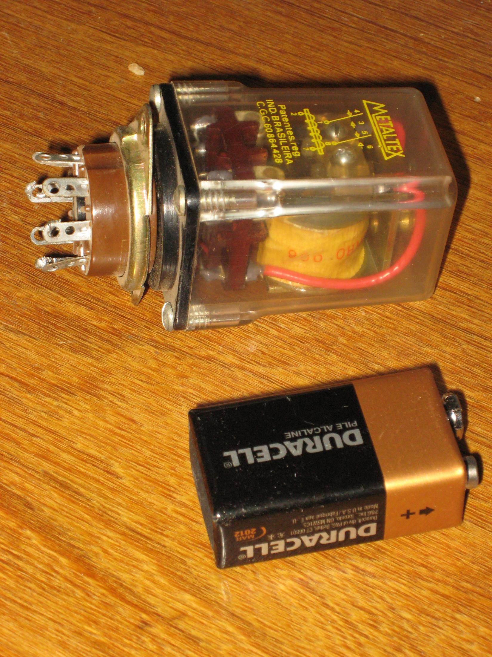

Just a little larger than the last one, this is a Metaltex (Brazilian brand) relay, marked OP3 RA1. They have loads of this brand, in one- two- and three-pole versions, with slightly different codes. As far as I can tell these are still actually new, in the box. The three-pole one is marked "6 V. A. C. " on the bobbin, the two pole one says "12-24 CC" and "900 ohms" on the box and on the bobbin, code OP2RCTR. They have dozens of these, so it would be cool if they are appropriate, or if they have some other interesting use.
All of these fit into tube/valve sockets. Were they originally for tube equipment?

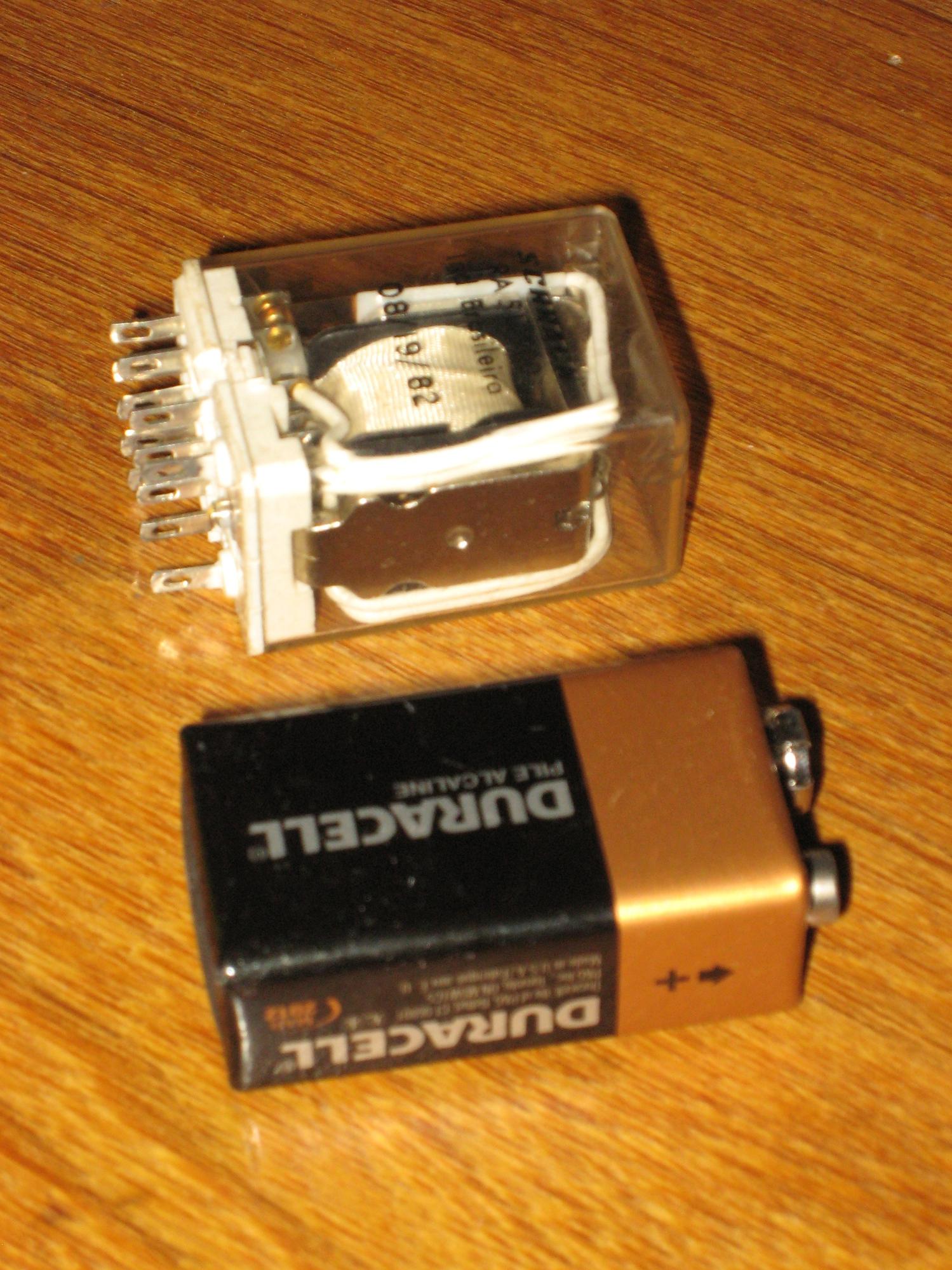

I've got more photos, though! Smaller ones, both Brazilian made - the brand is called Schrack, but I don't know if that is itself Brazilian or not. The one on the left is a one=pole job, marked "10A 250V~", and "110V~" for the bobbin (DC ratings are lower than this, right?) but it looks a little dodgy, and I don't think they have another. They have dozens of the ones on the right - these appear to be four-pole, but look less hefty... Only info on the relay is the code 109P182N, if that means anything to anyone.

109p182 is a XEROX part number. I may have an old used one at home somewhere. I have been retired for some time now. so I "can't" get a new one. The coil is probably 24vdc the contacts I again can't remember. I may have used a similar relay in a tri amp chasis. I used 2 pole for the bass in parallel and single poles for the mid and treble amps. Stay away from the AC curent coils. You can use dc on an ac coil but not AC on a DC coil. Having replaced hundreds if not thousands of relays over the years especially the early years I have used an AC relay as a substitue for a DC relay till a proper spare was available. The Mercury relay is a fantastic find. You may have to operate the relay in a particular orientation, mercury is a liquid. Don't open it. The contact rating is generally lower for AC voltages because they are generally used at 110volts or 220 volts. DC contacts is usually rated at 24 or 48volts dc on the contacts. Get the highest curent rating for contacts. Use 2 24volt dc relays in series, for stereo, one for each channel. Most relays will energise at a lower voltage and hold the contacts closed at an even lower voltage. The hold voltage can be as low as 12volts on a 24volt dc relay. This reduces power in the relay and increases reliability. And the relay will deenergize quicker.
Thanks multisync, that's very helpful, although it does raise a few further questions which you may be able to answer. (I haven't used relays before so I may show my ignorance here and there, but there's no point in doing a safety circuit which doesn't work because you didn't ask the right questions, right?)
Any idea of the current rating on the 109p182? It's quite possible that Schrack made these parts as a supplier for Xerox, right? The other number on the same relay is RA 512900, does that ring any bells? Part of my difficulty with this one is the proliferation of connections on the bottom. It appears to be a four-pole relay (which matches your use of it you mention above) so I imagine the pins are in four groups of three, one group for each pole, with the last two for the coil. (Right?) From your last remark I udnerstand you thnk the other is an AC relay, but I can probably getaway with it if I want/need to.... correct?

The octal base plug in format is very common, still produced today, usually used in the likes of process control switching.
The 109p182 is a 24DC (coil) 4 pole double throw relay. Contacts are rated at 3amps at 110 volts AC and 3 amps at 28Volts dc.
If you find a 109p384 it looks exactly like the 109p182 and has similar ratings except it has a diode across the coil so be careful wiring it up.
If you can find a 109p397 that would be a good one as well, 24vDC on the coil and 10 amps on the contacts.
Just about every relay in the junk box has its ratings printed on it. Old Xerox stock or not.

This is also a help, especially the last one. I took a look at that schrack link earlier yesterday, and they have no info (that I could find) on the relays I have on hand. The Metaltex site I had also looked at, but I didn't understand the codes on the relays - I thought they would work like part numbers on transistors and suchlike, but in fact you have to read them in steps. Once I did that I found a lot of information on them. Same basic idea worked with the Potter and B site, once you had me pointed in the right direction. Thanks.

There are various Metaltex relays (not only available, but in my car 😀) - all have contacts rated at 12A, with various DC ratings on the coils, but all reaonable. (22.5-50 VDC on one, 12-24 on another, and so forth). They all fit into 8 pin sockets (except the 3 pole ones, which I don't need for the time being.) and conveniently come in one-pole and two-pole models; perfect for monoblocs or stereo boxes.
So, I think I'm going to try a dc protection and muting board on the mini-aleph-J, using the circuits from P33 on the ESP site and the Metaltex two-pole relay, unless anyone has a better idea. If it goes well, a pair of boards for the F5.
