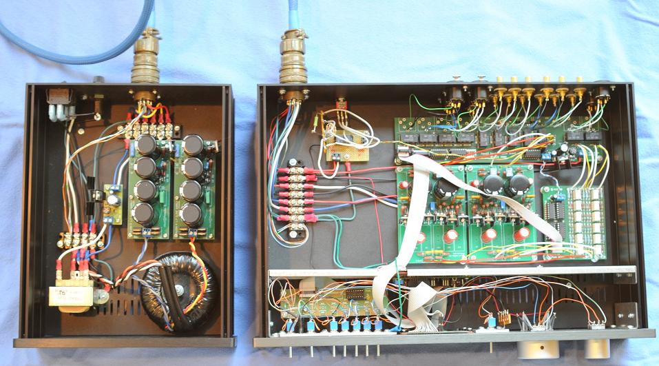

You'll love the Aleph P 1.7. I also used Dantimax boards and am very, very satisfied. I used 10 pin Amphenol connectors for my 2 box AP17 build but only used 7 of the pins (Hot and Ground for each AP17 channel (4 pins), Hot and Ground for the Dantimax power supply (2 pins) and system ground (1 pin)). While pricey, the Amphenol connectors are clearly built to last.

Thanks for the tip, Scott. Your build looks great! Modushop boxes?
I just checked Amphenol, and see that they also have XLR connectors. Interestingly, they state that the max. service voltage is 133V. In a footnote it mentions that the limit is 50V in a domestic situation. So, the connector will handle it, but probably regulation does not allow the use of these types of connectors above 50V in the home.
I guess the same must be true for Neutrik (cannot imagine their high-end all metal connectors being any different as they are designed for the same market).
So, it looks like 4 or 5 pin XLR should work fine.
Thanks for your comments about the AP and Dantimax. I look forward to hearing how they sound in a few months time!
Albert
PS I wanted to keep as much "junk" away from the amplification circuit, so I am placing the Control2, Frontpanel (with switches/knobs) and OLED display in the PSU box. I will only have RelVol3, Input2 and the Aleph board in the main enclosure.
