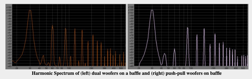

Which case are you referring to? The audioroundtable.com link provided by Norman Bates indicates it's comparing dual woofers on a baffle to push-pull woofers on a baffle (figure attached). I'm probably misinterpreting your post. Apologies in advance.

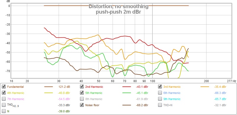

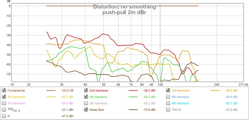

In my post I had in mind post #758 on this thread. I've attached screenshots of the push-push and push-pull measurements compared there.

The posted measurements were of course made with a driver where the effect is extreme. Also it should be noted that the 5th and higher harmonics increased, may be because of the magnet and frame causing reflections.
