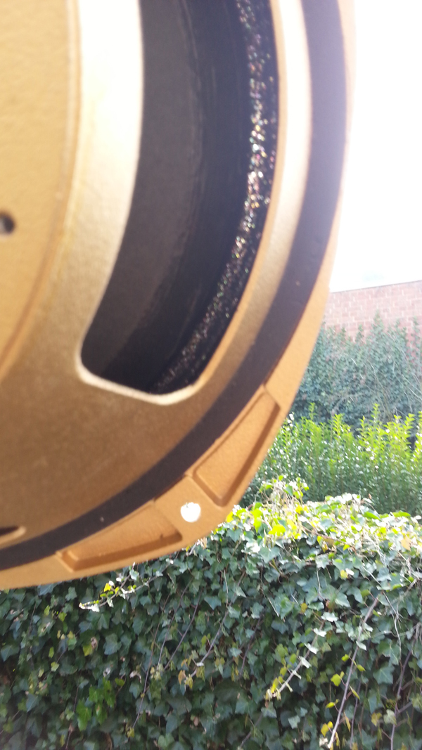

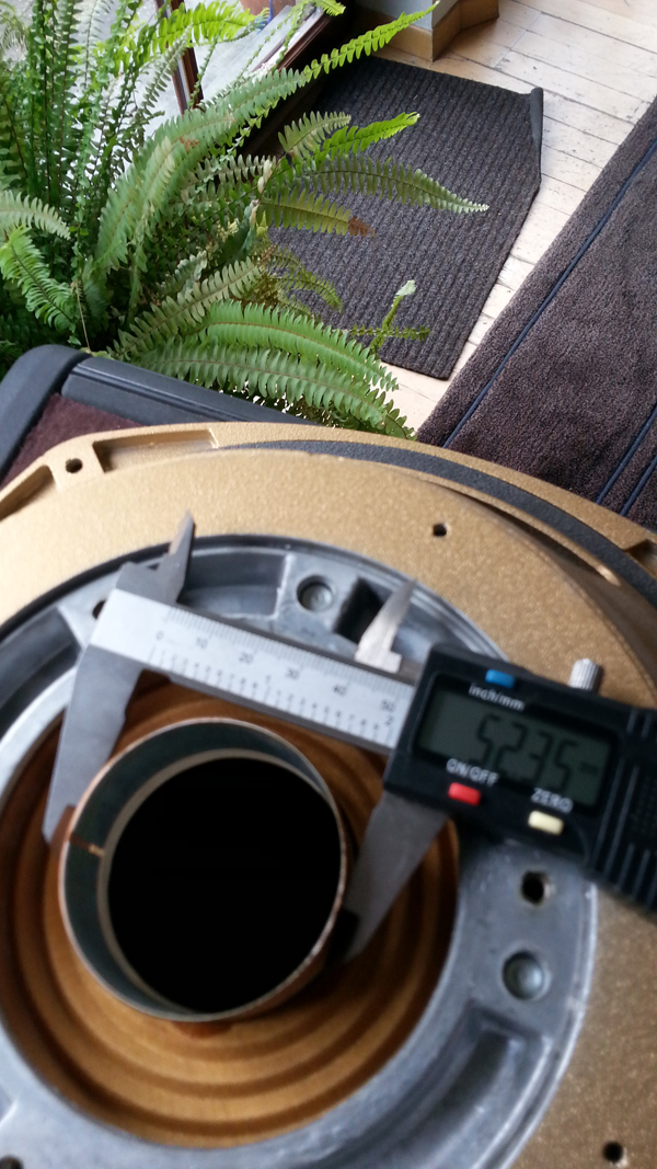

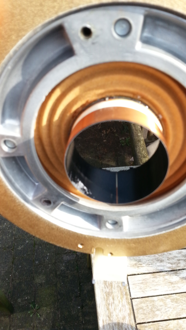

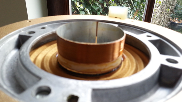

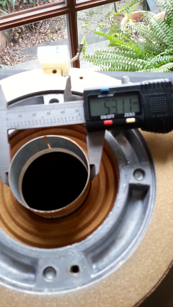

Now for the issues- the first one has the VC rubbing if not pressing by hand perfectly symetrically on either side of the membrane. Voice coil mesures 06 ohms and looks ok - no traces of discoloration from burning or bad scratches just a voice coil former gap wich is about 2 mm that i find a bit big? The voice coil measures (inner of VC) 50,61 on one axis and 51,36 on the other so it looks it's ovalised somehow.Pics show the external Dia.
The second has been reconed by a pig, Leaving a dirty mess where the dustcap is glued. Voice coil measures 51,4 mm on both axis- there's a bit of traces of rubbing inside the VC former ( easy to see as the former in this one is black) near the bottom.
The Magnet gap for VC is around 2mm.( a bit*h to measuse because of the magnetic field on the caliper)
Has anyone an idea how i could re-shape the slightly ovalised VC ? In his terrific blog zen mod (Zen Mod's blog adventures with Tannoy K 3809 FFL’s Tannoy K3809 adventure (revitalization ………. again !?! ) | Zen Mod Blog) says he uses a cup and does it by hand, not too sure about that?

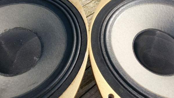

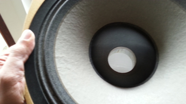

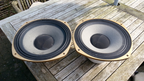

Different suspension profile de "m" profile come from the reconed one, and looks exactely as "current" re-cone kits stated for 3169 and 3149 but looks to me as a 3169. Harder suspension, the first wave takes most action, the second (most outside) barely moves. it has only a few mm travel before touching the basket. Flat edge wire, black alu former
The other one looks like a 3149, round Voice coil wire. clear aluminium former.

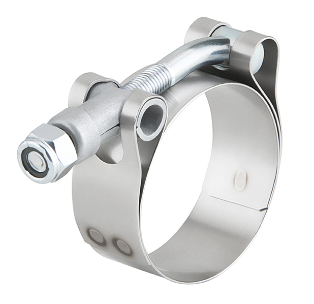

Trying to locate rat-glue over here... t-Bolt on its way- hope to use a glass inside VC that has OD of 50-50,8 mm slide it inside VC and tighten outside wit the bolt, putting dab of exoxy in gap to settle it, not sure what type of epoxy to use, can get really hot there?

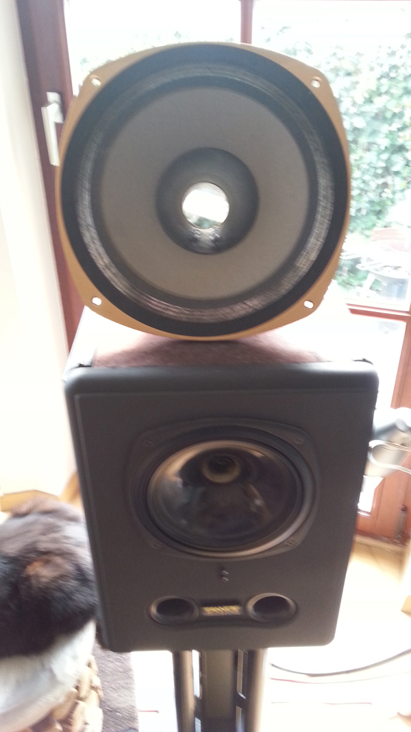

More on surrounds...
as you can see, the softer (3149-like surround) is light fabric that lets light pass through. (Pic taken on my faithful Tann actives) while the harder "m" profile (3169) let almost nothing (pic taken facing sunlight) .
Anyone changed their fabric surrounds on these 12" DC? Any idea where i could find them?
Think I'd like to get the 3149 type on both.

I used a cup as caliber - easier to check shape of VC former than by tricky caliper measurement
also - former being of Al sheet - I just pressed it with fingers (iterative process) , rechecking with cup , to form it back to more proper circular form
cigaret paper - being really thin , I used it as shield for glue , to not let glue goes between former and cup
you can oil it (paper) slightly , so it will not stuck to glue
however - I used glue strictly for (in that case necessary) re-bonding of VC to former in area of former split , not as measure for re-forming

Well it turned out the spider of the 3169 is out of shape, doing the hairdrier trick does straighten him up a bit but then it pushes the first wave of the suspension out.
Contacted Lockwood they can only be reconed as 3149. Recones ordered.
