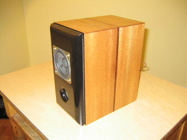

I'm looking for a driver that will fit the hole in this enclosure. The inside measures 9.5 cm x 18cm x 20cm, or 3420 cm2, so I figure about 3 liters? with driver and port materials. The port tube is 1.25 inches diamter x 3 inches long.
The driver hole is 7.8 cm. So I can go up to that size. All I know of right now are the 3" Fostex drivers, the FE83E and the FF85K. I think these will fit with a little work as they only require a hole of 7.2 cm.
I want to use these eventually as surrounds in a home theater, so bass extension is not so important. I have four boxes built so far, and I wonder if I can improve on the Yamaha drivers in them now. Although they sound okay and will play into the low-80's, the midrange is lacking compared to my Fostex FE108's, and the tone is all wrong.

If I'm reading the spec sheet correctly on AuraSound's web site, the hole required is 7.55 cm, which should work without too much trouble. They have a most impressive Xmax. The efficiency is not too good, though.
The price is within my budget (up to $30). How do they compare to Fostex's drivers, sound-wise? Brighter, mellower?

Further reading on the Aurasound driver, and based on what others are saying, makes me think it would work just fine. I can't be too picky, given I'm putting them into existing boxes.
Does anyone reading this think either Fostex 3" driver would work in these enclosures? I'm too ignorant still to interpret driver parameters for a given enclosure.

Okay, I downloaded WinISD and started playing around with it. It looks like the Aura NS3-193-8A is the only driver I have looked at that will work in this enclosure. Actually, the plot looks really flat down to 50Hz. According to the program, the Fostex's are completely unsuitable (which makes me want to buy one just to see what it sounds like
Anyway, I'm going to order the Aura's and see what happens. Thanks for the advice.

joensd said:The Hi-Vi B3S could fit your enclosure as well. (sealed though)
It´ll have a slight bump that should sound alright for surrounds;
alternatively you could use a series cap to flatten it out and squeeze a tiny bit more bass out of it.
