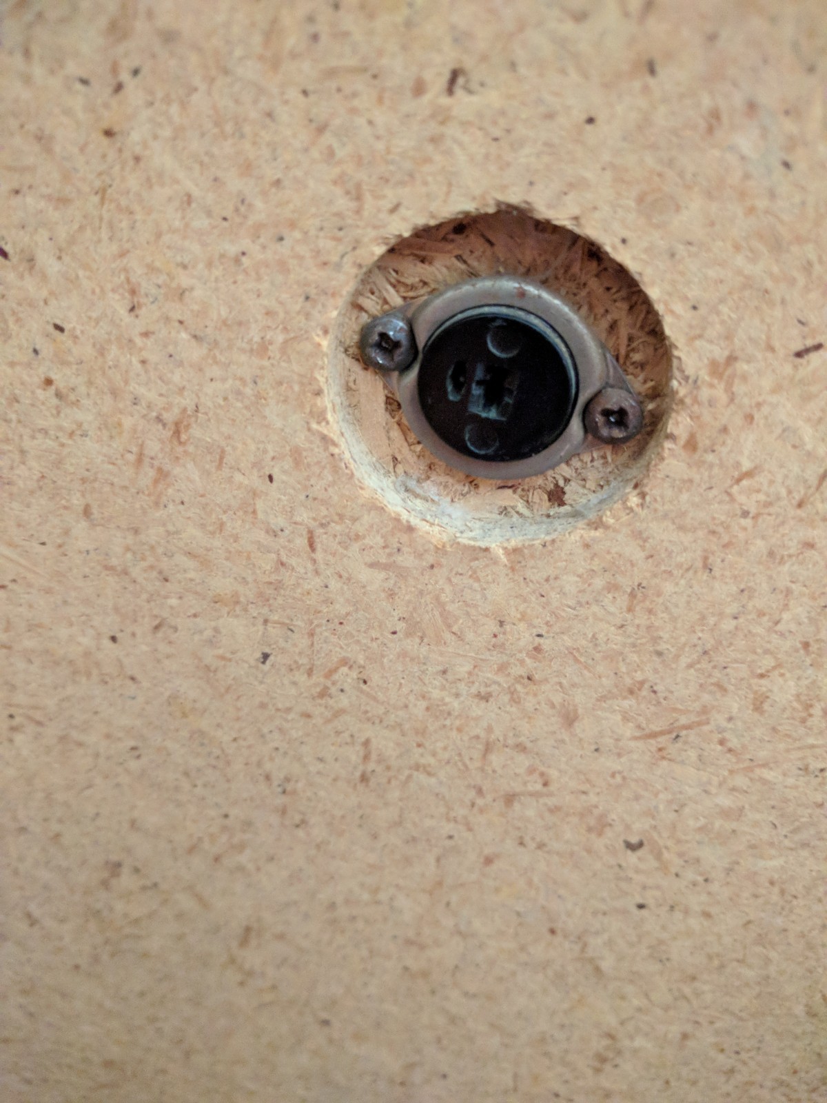

Hi All.
I'm tidying up the speaker terminal arrangement on a pair of Interdyn Loudspeakers.
Currently they have flush circular terminals which I'll be replacing with non iron banana type terminals.
I was hoping to learn which would be the the best way to fit the new terminals.
Should I flush fit them?
This will leave them sticking out quite a bit and make shipping and storing more awkward and lead to possible damage.
Or should I cut out a section and flush glue a panel on the inside of the box, onto which the terminals could be fitted?
This will allow the terminals to be less proud by the thickness of the rear panel, but will be more involved to fit and possibly compromise the box
Any thoughts?

Unfortunately, DUG, it is not stated what material the connectors in your link are made of.
If you read Cliff's other posts, you will find he desperately wants to avoid iron and other magnetic materials.
@ Cliff. Your suggestion of a panel inside the box is fine, such a small aperture will not compromise the integrity of the enclosure.
Can you show a photo of the 'banana type terminals' you are going to use? The originals are DIN type speaker sockets.
A terminal cup would be my suggestion.
I would have said round, just larger than the hole tge DIN plug is sitting in.
Posts like DUG suggested (ie dirt cheap, low metal, plastic caps). If you are anal you could just use the cup and replace with something better.
We used hundreds of cuos that used a 2” D cutout and posts similar to those DUG posted.
But guessing at te quality of your box, probably overkill.
