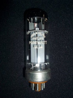

I took a picture of them, heres one of them:
To specify a bit more:
Valve 1: Philips Miniwatt, Metal base made in holland. SY1 57E. Measured 76mA with AVO MkIV.
Valve 2: Philips Miniwatt, Metal base made in holland. SY1 57E. Measured 82mA with AVO MkIV.
Valve 3: Philips Miniwatt, Metal base made in holland. SY1 57D. Measured 82mA with AVO MkIV.
Valve 4: Philips Miniwatt, Metal base made in holland. SY1 57E. Measured 72mA with AVO MkIV.
Valve 5: By Mullard, black base made in great britain. XF2. Double halos. Measured 81mA with AVO MkIV.
Valve 6: Philips Miniwatt, Metal base made in holland. SY1 57E. Measured 78mA with AVO MkIV.
Valve 7: By ??, black base. Double halos. Measured 90mA with AVO MkIV. (same as Valve 5?)
Valve 8: Siemens black base measured 65mA with AVO MkIV.
Valve 9: Siemens black base measured 66mA with AVO MkIV.
Valve 10: Siemens black base measured 75mA with AVO MkIV.
Valve 11: Siemens black base measured 95mA with AVO MkIV.

You've got some really nice ones for sure. The metal based ones whether mullard or mini-watt will sell for really big bucks. These are perhaps the most sought after and desirable of the lot.
I disagree with another poster here and have found the various incarnations of mullard/valvo/mini-watt EL34's to sound better in my designs than anything else I have tried. U.S. made 6CA7 aren't even close in my estimation, but again this is my opinion.. It is probably a question of design, component quality and system matching issues.
I would consider keeping a quartet of these, I think you'll really regret selling them later. No current production tube is close to these in performance or sound quality imho.. Just slow down and save your pennies - hard to do and I am not a good taker of my own advice.. 😉
I would keep all of the mini-watts and sell the rest. Siemens are also a trendy type and should fetch a good price.
