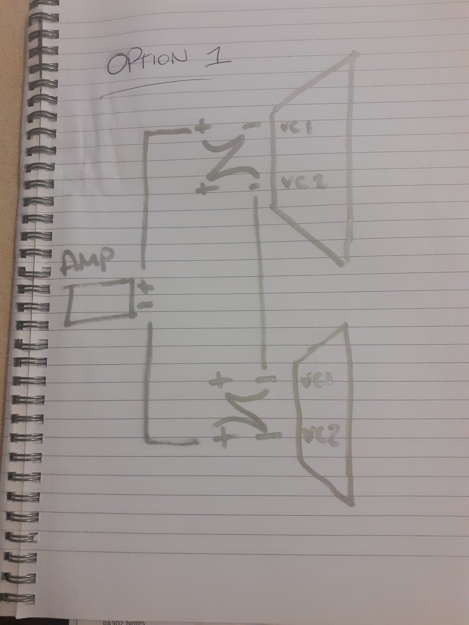

Option 1 (per side)
  • 2 x Dual 2-ohm Voice Coil subwoofers, each driver rated at 1000 watts RMS
  • Voice coils and drivers wired in series, resulting in 8-ohm impedance
  • Single mono amplification @ 1600 watts RMS into 8 ohm (powering both drivers, ie 800 watts RMS per driver)
  • Question 1: If this option is preferable, how do I wire one driver out of phase when wiring these drivers’ dual voice coils together AND wiring the drivers together in series? A diagram (or a link to one) would be great.

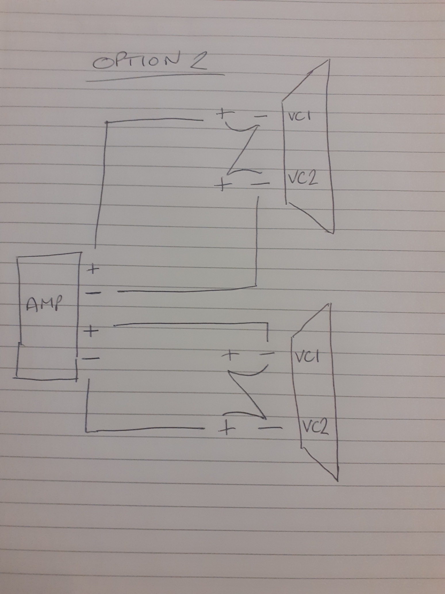

Option 2 (per side)
  • Each driver has its voice coils wired in series, but drivers are not wired to each other - resulting in 4-ohm impedance per driver
  • Dual mono amplification @ 3000 watts RMS per mono channel into 4 ohms
  • I would use a balanced splitter to duplicate the signal coming out of my active crossover to feed identical signals into the dual mono amp
  • Question 2: If this option is preferable, how do I wire one driver out of phase when wiring its dual voice coils in series? Again a diagram/link would be appreciated.

The method you have described works when the basket of one driver faces the cone of the other (push pull) If you have the cones facing each other you'll need to have both drivers in phase.
Here's a quick sketch of your 2 options.

Ok, here you go.
Speaker individual wiring: what Rob said. This makes each speaker a 4 ohm load. Less resistive heating loss per wire. Works great for home theater, where higher impedance speakers are the norm.
Question 1: rigging (leading towards all the others.)
For me, I would use whatever I had on hand to determine the wiring. Combined with the isovent configuration, it will tell you. For instance, if speaker on the inside of the sandwich quits, it's not easy to troubleshoot in the field. However, with all 4 speaker pairs running out the box into a distribution block, or individual speakers running straight to a 4 channel amp, troubleshooting becomes trivial.
This leads to the conclusion that if you're running a channel per speaker, it's cheaper to run each speaker 1 ohm instead of 4. This means heavier speaker leads, due to the 4x current situation. But a 1000w monoblock amp that's 1 ohm stable is common and not overly expensive. You may even find a 2000w monoblock that's 2 ohm stable for not hyper pricey. This is clean, 1%, pro audio, continuous power rating, not max music peak power. Car audio guys lean heavily this way. Unless they're sponsored, in which case they have to have at least 6 amplifiers in a rack somewhere.
One amp per isovent pair, half the troubleshoot by RCA input. Speaker wire cheap, amplifier power not cheap. Home audiophiles love this cuz 2 speakers per channel, big old anvil PA amps love 8 ohms. Pro audio gear usually exceeds the nameplate specs by a little for durability.
