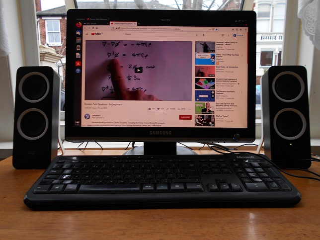

Multiple drivers can be more directional and pump less overall power into the room for a given SPL. Hence less reflected sound. But carpets and drapes always help.
I use this principle on my computer speakers. Theoretically 3dB less power to the room, so annoys the neighbours less:
