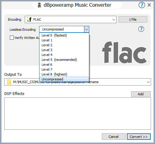

Yes - the FLAC code can be adjusted to enable an uncompressed mode, where compression is completely disabled.Do I miss something?
The only commercial implementation of this is in dBpoweramp. It should be noted that the developers of FLAC, the Xiph.Org Foundation, do not endorse this.
Why would you want an uncompressed FLAC? Because FLAC is a much more reliable format than WAV for tagging. When I started using Music Player Daemon years ago, any WAV's in my music library which were ripped by EAC, then tagged by Tag&Rename showed up in the MPD database just fine, but WAV's created by any other application had corrupt listings in the MPD database.
So I am now using FLAC just as a container format, without any form of compression.
Correct, no compatibility programs. I've played those FLAC's on any/all programs on Linux, Windows, Mac.
Think about it, the playback application looks for metadata flags indicating how/where the audio data has been compressed, it finds none of those flags, so the decoder does nothing.
As to "wasting hard drive space" I work in television production, using digital audio workstations since the mid 1990's. I'm simply accustomed to having all of my audio files uncompressed - as WAV or AIFF.
