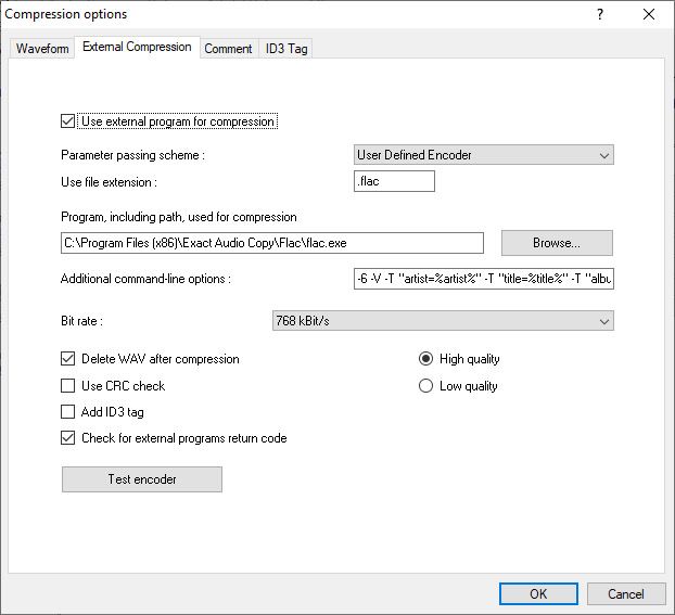

If you use FLAC Frontend, that's a 2-step process:
i) EAC to rip to WAVs
ii) FLAC Frontend to convert WAVs to FLAC.
It's more straightforward to configure EAC to compress with FLAC, then it's a one-step process. (Actually it's still a 2-step process, but EAC does it all).
I believe the latest version(s) of EAC already includes the FLAC encoder application. To check, go to C:\Program Files (x86)\Exact Audio Copy
and you should see a "Flac" directory containing "flac.exe". If not, download flac-1.3.2-win.zip and and extract it to that location.
Now launch EAC and in the menu go to EAC > Compression Options... > External Compression
Select "Use external program for compression"
For "Parameter passing scheme:" in the drop-down menu select "User Defined Encoder"
For "Use file extension:" .flac
Then for "Program, including path, used for compression" use the "Browse" button to select the flac.exe file mentioned in the previous step.
For "Additional command-line options:" leave the default values, as this will help with tagging.
Finally select "Delete WAV after compression" otherwise you will fill up your hard drive with the first-stage WAVs.
With your audio CD inserted, the rip process is started with -
Action > Copy Selected Tracks > Compressed...
