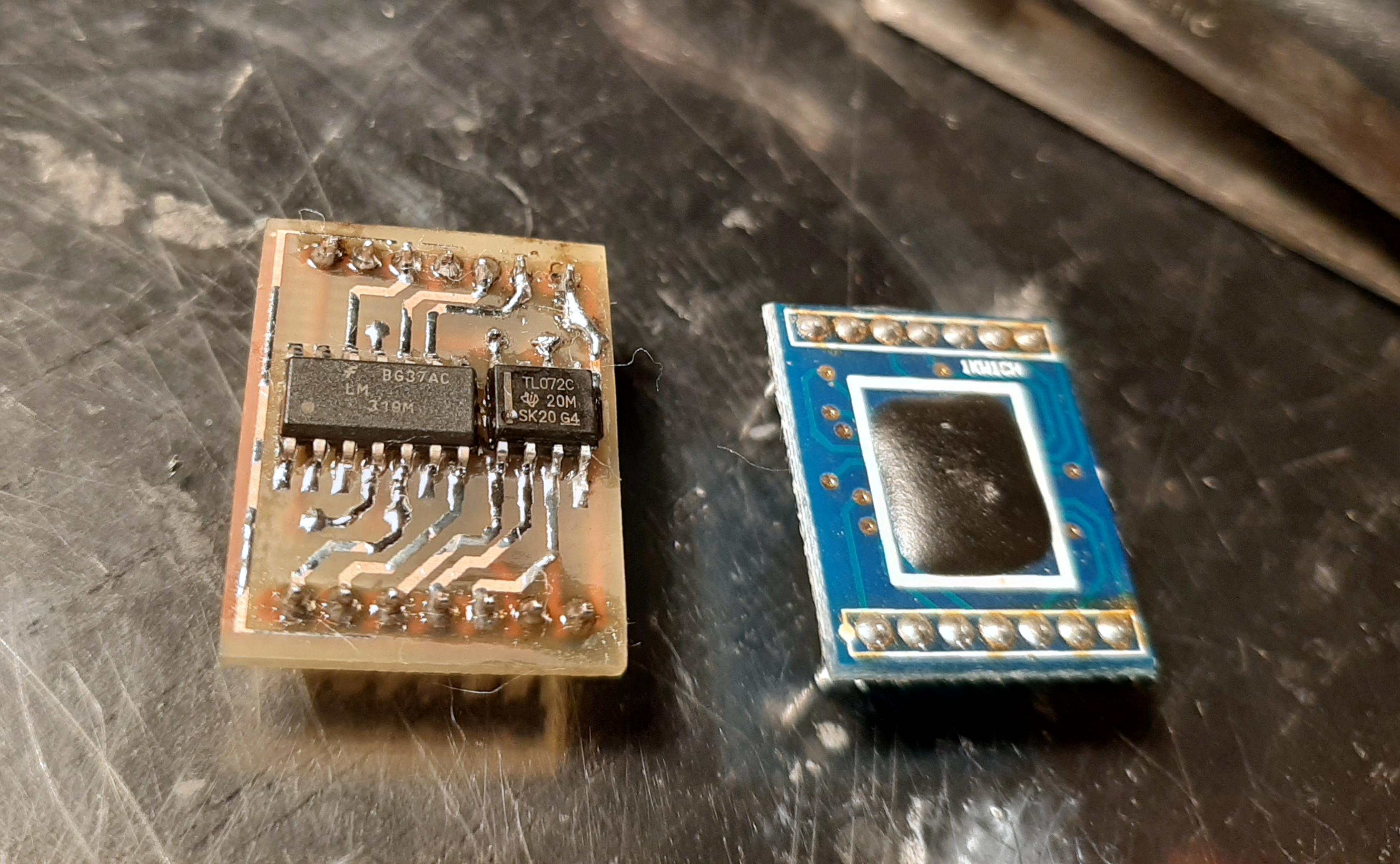

Input signal is present ok, it's a drive square wave that is absent.
Input signal is coming to the driver board on the "IN" terminal, goes into add-on board to a tl072 opamp, and at least that half of opamp is working as i can see an amplified signal on it's output pin (according to jacampb2's schematic)
I'm going to trace other voltages and signals on the driver board to determine if there is something wrong with it.
I'm not sure if this driver could work without the feedback loop and this complicate things even more.
Maybe, just maybe, it's a good moment to stop here as I don't believe that I will be able to fully understand this self-oscillating driver thing any soon.
I could try to replace an opamp/comparator board blindly, and if that will not help just go and replace everything on the driver board.

Well, no luck with this.
I've replaced the board and it does "something" as I can see the oscillation on the output fet gates with no fets soldered, but the moment I solder in the output fets it all goes to ****, power rails all over the place, power fets heating up, the amp no longer in protection mode, but it definitely doesn't work as it should.
May be those "1kw1ch" boards are wired differently, I don't know.
I think I will wrap up here, unless I'll get my hands on a working dlm board to compare.

I returned to this amplifier after a break.
I've spent some time to learn how the dlm4500 work. It turned out that this is not a self oscillating modulator, but a more traditional pwm with a fixed carrier freq.
It has a triangular generator circuit which consists of a schmitt trigger (one half of lm319) and an integrator (one half of tl072). This generator should work either with or without input signal.
My problem is this generator doesn't produce a triangular wave.
Instead of 100kHz triangular wave with amplitude of 9v it produces a tiny amplitude square wave biased to -9v
I checked all related passive elements and they measuring ok.
I will remeasure them and if this will not reveal the problem, then I tempted to replace ICs. Again. There is a small chance that I killed the ICs during soldering.
At least "fixing a standard triangular generator" instead of "fixing a proprietary modulator board" sounds much more manageable to me.
