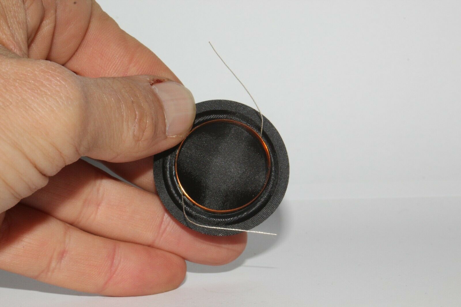

You can learn more positively from this, Cliff, by dismantling the tweeter as shown in the service manual.
Removing the four screws (part 12) allows access to the diaphragm/copper wire/voice coil former assembly (part 3/6/7).
You can then look to see if the voice coil is burned out or if there is an obvious break in the connecting copper wire.
I don't want to encourage you to spend even more money on these budget speakers, but the diaphragm/copper wire/voice coil former assembly is replaceable (see attachment) at a cost of around £30 the pair. However, it may prove fiddly to fit for someone with no previous experience. There are YouTube videos out there showing similar replacement jobs if you search for them.

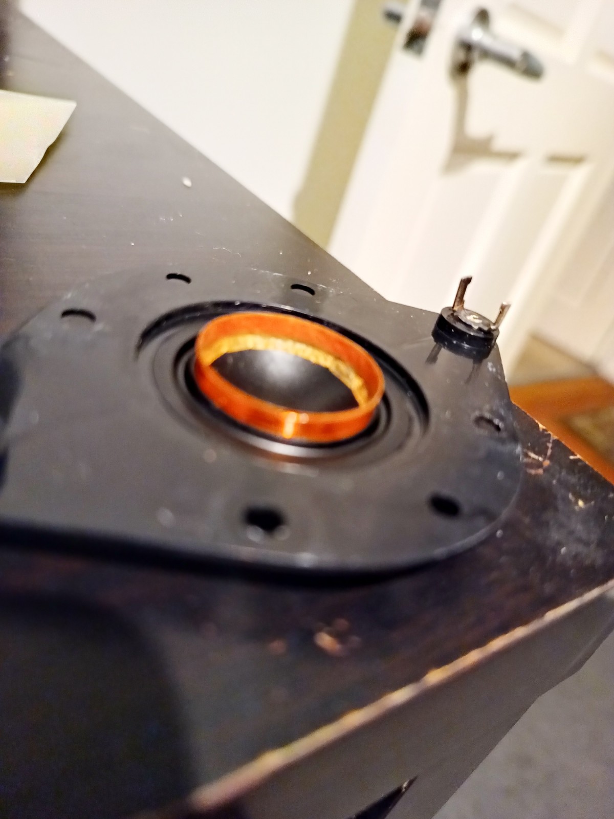

Thanks Galu
The copper voice coil looks in very good condition.
It appears it's the wiring from the terminals to the coil which is the issue.
I can't get signal from the coil to the terminals.
I don't want to encourage you to spend even more money on these budget speakers.
