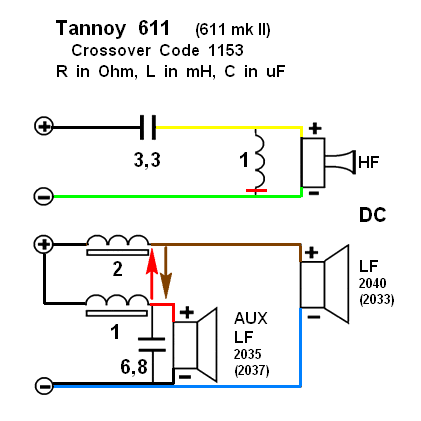

The resistance data that you measured refers to the Re, which is the DC resistance ( of the coil). It goes that the nominal impedance ( resistance at AC...) is 8 Ω for the MA and 6 Ω for the Tannoy.
Yes, you can leave the present part of the crossover that goes to the woofer - lowpass @ 400 Hz- and arrange a matching ( mirroring...) high-pass for the MA.
If the actual filter is 2nd order for the woofer, you can experiment with 1st order for the MA. If excursion is too high, try 2nd order ( also if the steepness of the two curves is no good,i.e. they don't match, like too much overlap or "holes" in between etc. ).
But first, I would analyze the present crossover ( if you have it..!?) and see how it is conceived.

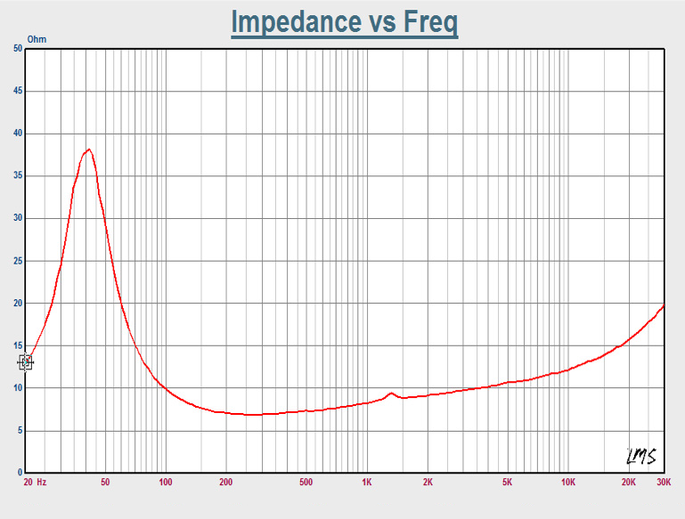

Pluvia11 parameters listed below.
Impedance plot attached alongwith
Crossover schematic from 3-way Tannoy 611.
Some online posts suggest 400 hertz too high for woofer xover and suggested lowering to 150.
Can't find any parameters for the Tannoy woofer at all. Would you advise replacement with a driver of known specs?

" suggest 400 hertz too high for woofer xover " - no it's not, but as I hinted above, I'd base the crossover freq. on your baffle width. So the crossover frequency would be (115/ baffle width in metres). Next, you need to find the impedance of each speaker at that frequency, to use in your parts value calculations. If you look at the graph you posted, you'll see that most drivers in the low hundreds have an impedance slightly above the measured Re, so you can use that for your Tannoy calculations.
For a simple first order crossover, Rod Elliot gives these formulas here: Passive Crossover Network Design :
C = 0.159 / ( Z × fx )
L = ( 0.159 × Z ) / fx
where Z = (actual) impedance of the speaker in ohms
