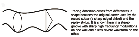

Tracing loss can be defined as the difference between the path
the stylus takes and the path the original cutter took whilst
cutting the record.
The tracing loss of of a spherical stylus is well documented, as
is the advantages of elliptical and more advanced profiles.
Critical to this tracing loss is the physical pitch / angle of the
signal to be traced on the record. It is well known a spherical
stylus shows a treble loss of ~ 2dB at the centre of a record
compared to more advanced stylus shapes.
Tracing loss increases with the frequency and modulation of the signal.
Referring to any signal on a 12" record :
On the outside of the record radius ~ 140mm, at the centre ~ 80mm.
So at the centre of the record the physical pitch will be 43% shorter
for a given signal.
Or in other words a 14KHz signal on the outside has the
same dimensions as a 8kHz signal at the centre, or the
dimensions of a 20Khz signal at the centre are equivalent
to a 35Khz signal at the outside of a record.
If a stylus has lost its profile it shows more tracing loss,
which is worst at the centre of a record, as stated.
Its a pity for classical music which often ends with loudest and
most energetic movements they didn't make LP's play from the
centre outwards to the rim.
🙂 sreten.

No you have not read me correctly,
and its not related to the tracking error of a pivoted arm.
Your second paragraph is true but does not tell the whole story,
it neglects the reduction of tangential surface velocity towards
the centre of a record, the squashing of the groove.
Tracing loss is intimately connected with the shape of the groove ,
the turns the stylus has to make as it changes direction, the physical
abilility of the stylus shape to sit correctly within the physical shape
of the groove.
This is because the physical size of the turns is aproaching the
physical size of the spherical stylus, the shperical stylus cannot
follow the path taken by the cutter.
For the same signal these turns are tighter at the centre of a record,
Tracing loss thus increases towards the centre of a record.
Or another way of looking at it is 45rpm LP's physically stretch the
shape of a groove and thus have less tracing loss than 33.3 rpm.
Equivalence here is easy, a 20Khz signal on a 45 rpm will show
the same loss as an equivalent 14.8kHz signal on a 33.3 rpm.
The size of the centre of an LP is mainly related to this issue,
and to a lesser extent the tracing angle error of a pivoted arm.
My estimations above are not accurate, 145mm and 65mm are better :
A 20Khz signal at the edge will have the same tracing
loss as an equivalent signal at 9Khz at the centre.
That is the physical shape of the groove will be identical.
A 20khz signal at the centre will have the same groove shape
as an equivalent 44.5Khz signal at the edge of a 12" record.
Tracing loss increases towards the centre of a record - fact.
This applies to parrallel arms as it does to all others.
🙂 sreten.
