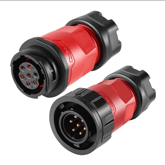

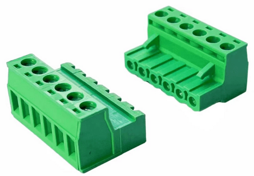

Some suggestions for your consideration:
https://www.amazon.com/gp/product/B0CLYMCRJR
https://www.amazon.com/CNLINKO-Industrial-Waterproof-Connector-Circular/dp/B0CNPJWC3R
