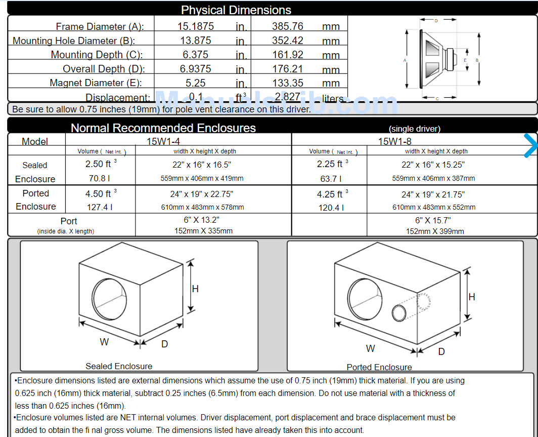

I have two of the jl subwoofers with one currently in a box. Both subs are old and have not been used for 15 years plus. I had purchased them for a car back when I was in high school.
Box cubic feet appears to be 1.71, which is below the recommended size for the woofer.

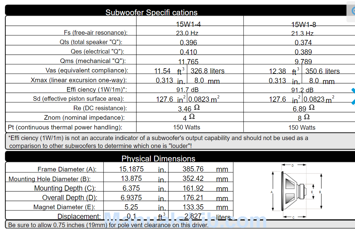

Greets!
As you can see from the plot it's designed for lots of room gain if not vented and it needs to be up to nearly 10 ft^3 tuned to Fs or lower depending on room location to effectively use EQ and/or drive it to movie LFE SPLs with only 150 W.

Yeah, even assuming it's a bogus rating, the driver is likely only going to be able to ~ safely use +3 - 6 dB (3 - 600 W) and even then only on 'fast' (time wise) transients.
Basic BR math shows that Qts' dominates until Vas becomes quite large, so with a high Qts' for a vented alignment where @ ~0.4 Qts' (and likely higher, measured), then Vb = Vas, Fb = Fs, so with a very high Vas also it's got to be big to get the most out of it, so the smallest I'd normally recommend is the pioneer's Vas/1.44 tuned to Fs.
Vented net volume (Vb) (L) = 20*Vas*Qts'^3.3 (Ft^3 = (Vb)*~28.31685)
Vented box tuning (Fb) (Hz) = 0.42*Fs*Qts'^-0.96
(Qts'): (Qts) + any added series resistance (Rs): http://www.mh-audio.nl/Calculators/newqts.html
