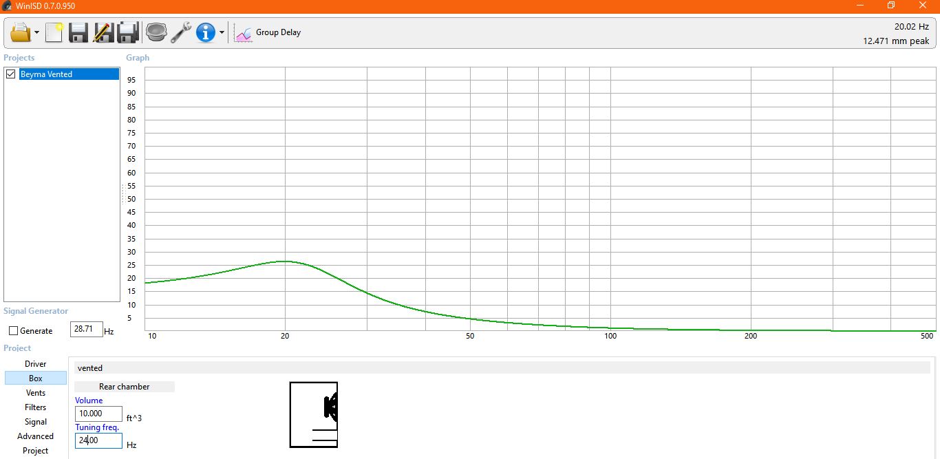

2. Currently I have tuned the enclosure to 24hz (pls see pictures) with 400w signal. The cone excursion exceeds around 20 hz - will I run into problems here with moderate volume levels? Please also look at group delay and port velocity and suggest what can be improved.
3. Having said above, I have seen folks suggesting to tune way lower like 20hz and below. Can I tune lower too? but although I understand the disadvantage of tuning lower is we will lose so much SPL which requires lot of EQ to recover back, I do not how that could work. If I apply some Parametric filters, the cone excursion exceeds - Its relational theory I guess and in summary, you have to give up / compromise on either SPL / tuning frequency but would be good to know how to build a balanced system.

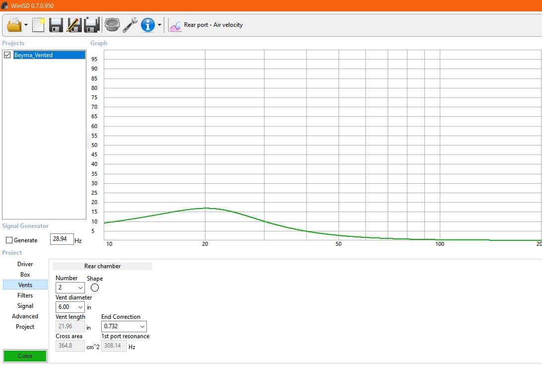

Sorry I forgot to attach the port velocity - please see the port velocity picture.
What I am also very much concerned is about the Group Delay and boominess. Is there a parametric range that decides where the boominess is expected? please see attached and how it can be tackled if not completely avoided in a system?

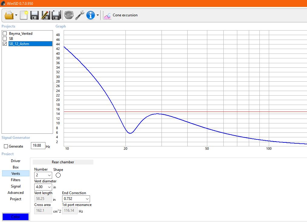

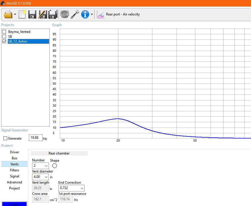

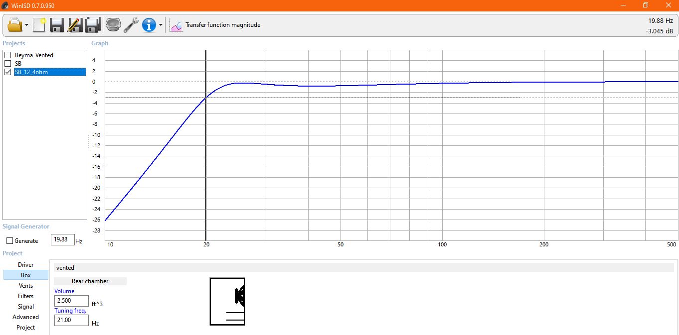

I have also simulated (pls review) the SB Acoustics 12 inch woofer (probably comes at similar cost to Beyma's 18 inch). SB Acoustics looks far more better in terms of linear response below 30hz at 2.5 cubic feet.
Given the room size (21 x 21 feet all 4 sides), I just dont know if single or even dual 12 inch would shine over Beyma's 18 inch.

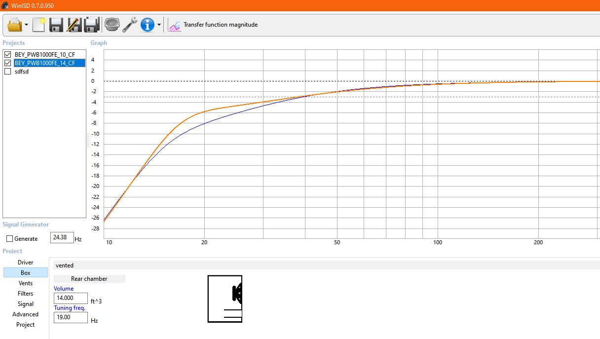

I have attached the curves for 19hz tuned at 2 different enclosure levels.
With 400w as input,
1. 10 cubic feet - Blue line
2. 14 cubic feet - Orange line

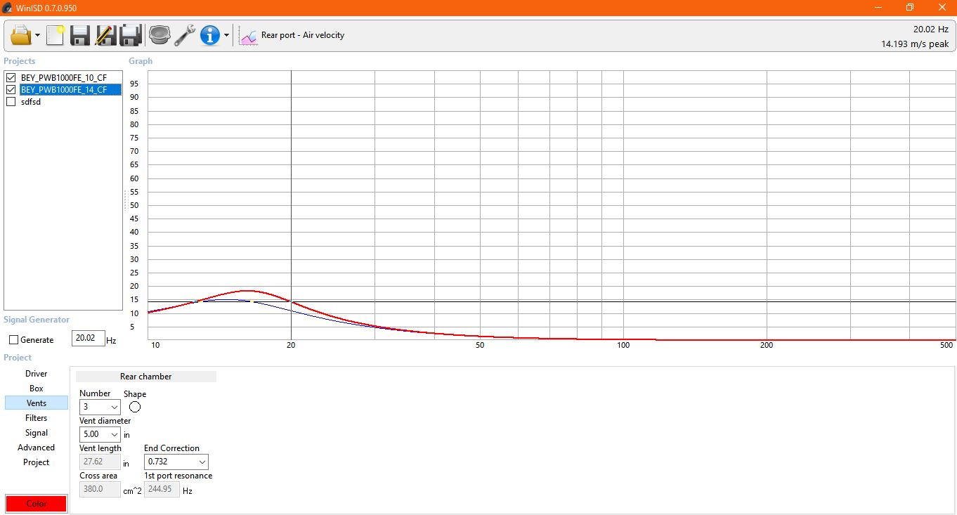

The curve of 14 CF looks lot better, it is literally a massive bookshelf with 3 x 5 inch 28 inches length port.

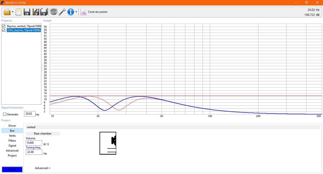

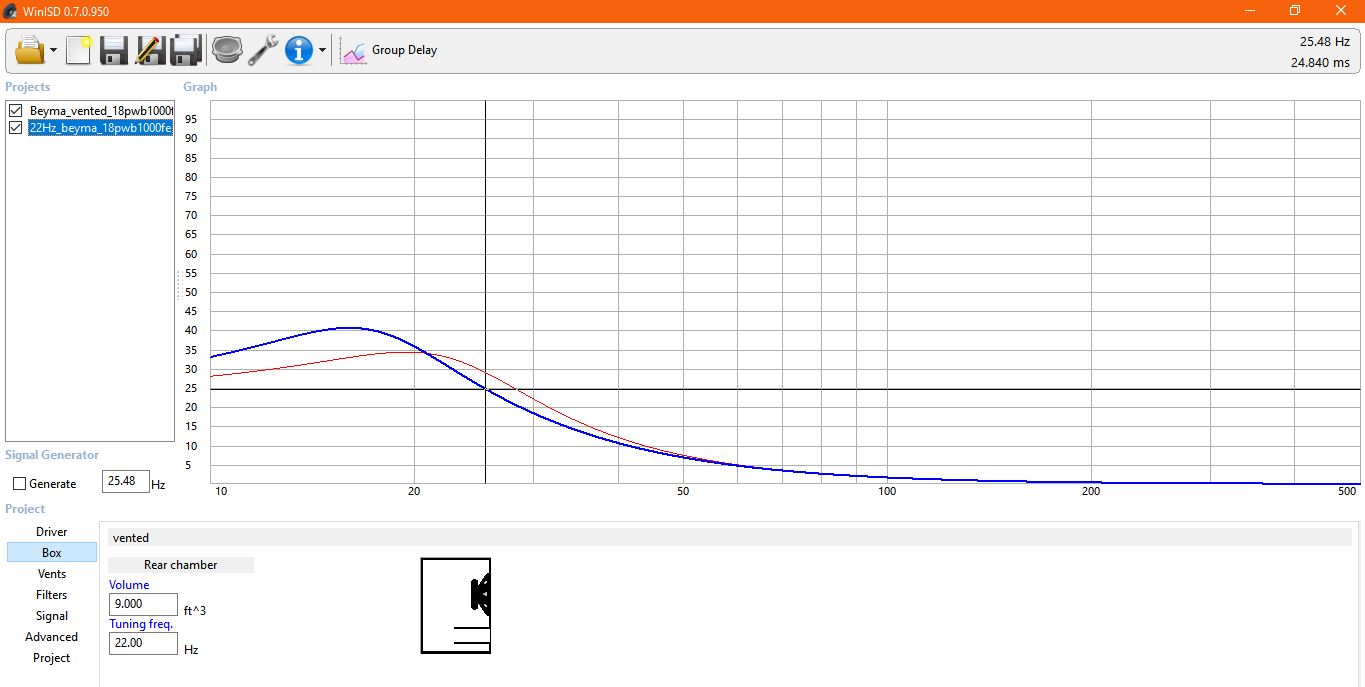

Ok, so I have come back with two choices of tuning - 22hz & 27hz (27hz is also Fs)
22hz - blue
27hz - red
power - 600watts
1. I would like to understand which curve would provide in optimal in room response / room gain - please advise.
2. Do I have worry about the group delay curve? Will there be any boomy bass?
This is mostly for tv & movies content in 441 sq feet hall (21 feet all sides) with no obstacles other than a sofa. Placement for the sub will be corner as this will take big enclosure.
Please see attached graphs and advise,
