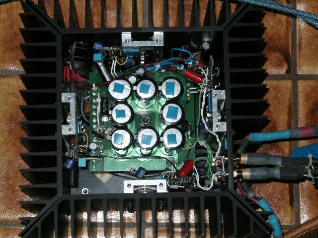

Is that why you can't stop laughing Harry? Nice job BTW.
Yes, it's EAR damping material. I was scheptical about doing things like that before or didn't bother. However. since my system achieved certain level of resolution even the smallest change in materials used and the way they interact with each other makes a difference. I give one example.
My transport has a wooden side panels attached. I was recently playing with modifications on it and on the DAC so I took the panels off. After I was done and quite happy with the results I put the panels on and immediately didn't like something about the sound. It seemed like it was out of phase and not focused. I decided to take the panels off and everything came back to normal. Now I pay attention to everything. Not only to parts but also materials being used.
