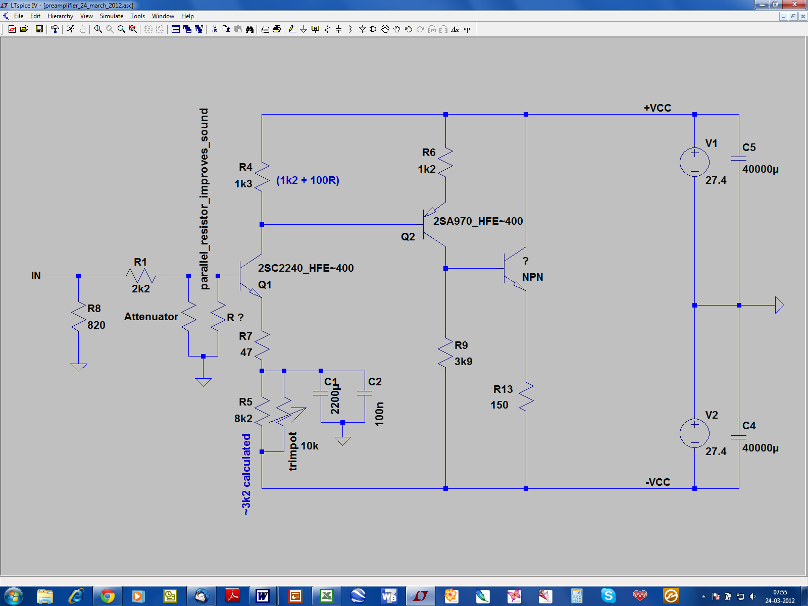

Hi Jack,
What I have done in terms of charging the batteries is exactly what you are thinking of. When running my circuitry off a stereo battery supply the current consumption is only ~30 mA so a 7AH 12VDC battery may supply power for this for a very long time (remember that SLAs in general do not like deep discharges. The 7 AH models typically have a comparatively low ESR. I used batteries from Yuasa and Panasonic). I've made a quality supply that can be disconnected via e.g. a contact or a couple of relays.
Regarding the circuitry I've attached a jpg file of what it looks like. Please note that this is not a circuitry that I - if I take on my engineering perspective - would design exactly like this. But IMHO it sounds outstanding which is why it is as it is.
Components I used were:
- Roederstein RSX resistors (difficult to get) or carbon block resistors. I guess others may be used - but e.g. Vishays had a quite greyish sound.
- Panasonic HFZ electrolytics (though discontinued now) placed very close to where the power is used. High capacity electrolytics were Nichicon GQ series.
- Panasonic copper foil capacitors 100 nF/50volts (connected in parallel with the HFZs)
- BlackGate FKs. In a particular circuitry these were unmatched in the bass, however, haven't used them widely and they seem to be hard to get at today.
- Elma gold plated attenuator with discrete resistors soldered directly onto the attenuator and a circular copper wire connecting the resistors at the circumference of the attenuator.
- A balsa wood 2-3 mm thick "PCB" where I mounted the components. Audibly, this actually is very important, possibly because it eliminates the dielectric absorption normally found between the copper surfaces/wires on a PCB and the - maybe - epoxy basis. Balsa has a dielectric coefficient very close to that of air. I used a needle to make holes in the balsa where the components go through the balsa.
- Uninsulated copper wires to connect the components. 1mm thickness. Short wire lengths also on the "PCB". Be especially mindful about the wire from C1 & C2. Again no insulation due to dielectric absorption. I'm considering using argentium wires (silver + germanium - see ebay if you're interested) since they do not oxidize and my preliminary listening suggests that it sounds very good.
- WBT connectors
- If I used metal close to the circuitry it was non-inductive (like brass).
- And VERY important. On both the base and emitter pins of the transistors I placed small ferrite beads. This - with sensible layout - very simply eliminates tendencies to oscillation and - as a possitive side effect - audibly makes the music sound more "manifest" and in balance.
- I used 2SC2240 and 2SA 970 transistors. 2SA872 and 2SC1775 may also be used - to my ears they are slightly different though. In general I have found that this type of transistors sound their "best" (open, detailed, tonally in balance) at a quiescent current that is the max current divided by ~13.
- I used 4*12 VDC/7AH SLAs as I found that the transistors (2240/970) sounded best when the emitter to collector voltage was about 18-19 volts. The SLAs charge at ~13.7VDC each when standby charging.
- The low cut off frequency is about 1.6 Hz. And most likely several MHz on the top.
In general a thing to remember with a circuit like this - which IMHO is very transparent - is that most everything matters. So don't use pins or anything to connect wires on the board to the phone RCAs (if you use such). It will be audible. Solder wires on wires etc. No sockets for the transistors either.
I didn't use a servo circuitry as I found that when this circuitry had stabilized it was not necessary (for temperature stabilization connecting the two transistors with a wooden "block" may help. Heavy woods may be better). However, if you use a charger that is switched on and off there may be a bit of DC offset. If you decide to include a servo I suggest you design it to have a very, very low frequency cut off (e.g. 0.05 Hz) and somehow connect it where the trimpot is placed.
The gain is about 36 dBs (88 times).
Please also note that the circuitry has a rather highish output impedance (about 4kohms) which might have an influence if your power amplifier has a low input impedance OR you use long lengths of interconnect cable with high values of C and L. To that end I have added an emitter follower in the schematic which lowers the output impedance to low levels - but I personally would omit it, if your power amp allows for this.
Also the input impedance is quite low. It didn't cause issues in my system but if you need it higher you can replace R8 with e.g. a 2k2 or 4k7 resistor (haven't tried it though). R1 also can be 4k7 if this fits better with an attenuator.
Hope this helps ...
Best wishes for your project - whatever you decide to do ;-)
Jesper
