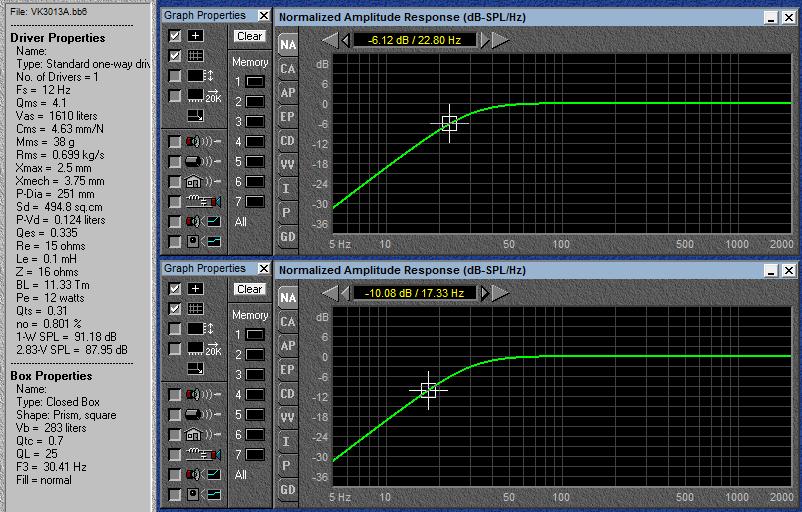

The main aim is to get the best LF extension. In the high frequencies it would be sufficient if they go to 8-10 kHz, because I have two great alternatives for super tweeter - in the photos above. Please tell me if Kapton is not suitable for 10 kHz operation.
I made some simulations and interestingly, too big BL is not giving me better LF extension, actually it's the opposite. See the attached simulation. I get similar results with slightly different sets of parameters. For instance with Vas between 600 and 900L and Fs of 15-18 Hz it is almost the same. Not to mention that 160L Aperiodic should be equal to twice it's size sealed.
Also the difference in the footprint between 160 and 285 L is not that big. 280L is 1150x550x470mm outer dimensions.
When I dial allot of BL, Qes falls and thus Qts and the driver becomes not bass friendly. With Qts round 0.3 I get the best results. Interestingly, with BL of 11-12 the sims look the best?
It is not an actual mod of drivers, because all parts except the voice coil will be original, only we'll use the two softer suspension parts types available.
But the main question is whether there is any negative influence on the sound from a 4 layer voice coil. Does it sound more muddy, blurry or with less clarity when compared to 2 layers?

And the results:
Qes - 0.26
Qms - 1.7
Fs ~23 Hz
Re - 11.8
Le ~1.2 mH - oops
BL.... 16.6-17 - big OOOPS
Mms - 42g
Qts ~0.216... ooops and ouch... would be happier with 0.34... but...
What we have here is a slight overkill...
Bandwidth up to 12 KHz
Linear up to 8-10 KHz
Intended use: up to 7.5-8 KHz with 3rd order low pass forming 4th order LR slope and crossed to a ribbon driver with LR-4 high pass @ the same frequency.
Simulations return 20-25 Hz @-12 db which is out of target performance, but a 30 mH + 32 ohms correcting network returns almost flat 20Hz to Fo SPL curve...
Any ideas for what to do with such driver are welcome!
Preliminary listening impressions: Maaan! They are fast!
Best Regards!
Problem solved, an 8 ohm added resistance will raise Qes and Qts will become ~ 0.35 while lowering BL to under 14, this will allow ~20 Hz @ ~-6db while lowering sensitivity as well which is good, because the 8 ohm ribbons have under 90 db sensitivity... Great!
There will be a Zobel and LF impedance equalization circuit as well.
And by the way, VAS is ~385L and with such a motor, 25Hz tuning frequency in a 185L enclosure is achieved with approximately 66x25mm port... ;)
... and group delay will be under 8ms above 30Hz ;) and almost nothing above 45 Hz... with a peak of 15-16 ms around 25 Hz ;) *very happy*
Best regards and thanks for the input!!!
Here are simulations of the drivers with 8 ohms added resistance in a 185L vented cabinet.
Everything looks pretty satisfactory.
I consulted an engineer, whether driving a 22 ohm load would be a problem for most amplifiers and the answer was that there will be no problem except that the power supply should be able to put out greater voltages.
Thus I am ordering the enclosures very soon. :):):)
Best regards!
