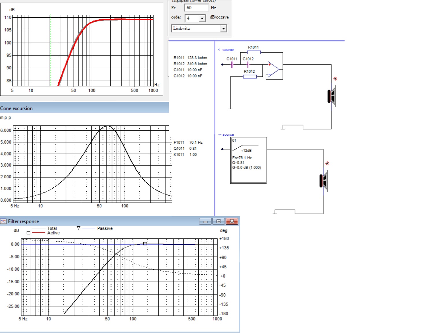

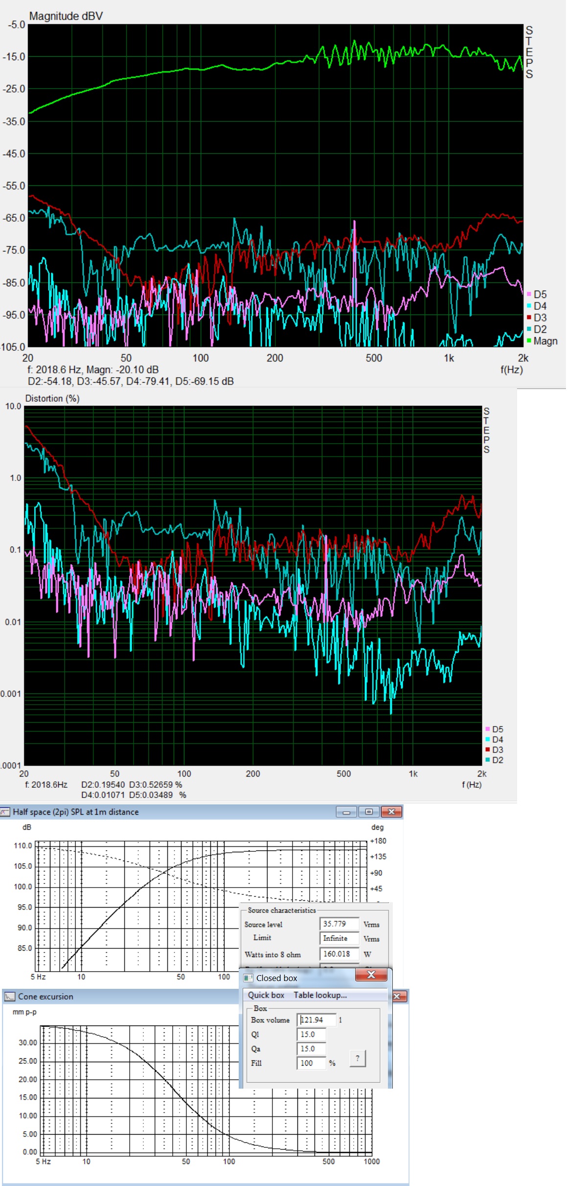

You reach a Qt of 0.5 for a pair in a sealed enclosure of just over 120 litres. With that sub at 60hz you're never excursion limited by the 225s anyway, especially if you throw in a highpass.
First picture measurement taken at just over 1 watt mic about 20 cm from the woofer on an open baffle, where it obviously reaches far higher excursion at low frequencies then it would do in a box.
The second picture shows what happens when you pop a high pass on it.

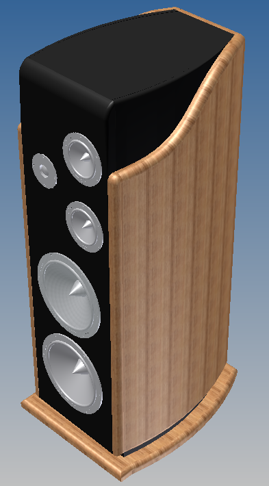

Here you can see the last draft I have, with the RS150 as mid drivers, not updated yet. Some changes are going to take place, than I will update the 3D model again, including other views.
I hope that you like.
I'm aware of diffraction problems with a so width baffle.
Please make some comments.
3D modeling credits to Suriv

I almost forgot the cabinet.
It looks great except you're going to want to place the mids and tweeter as close together as you can.
Also have you run your driver placement through The Edge? It's worth having a play around, because you can often come up with some very minor adjustments that can significantly smooth out the response.
