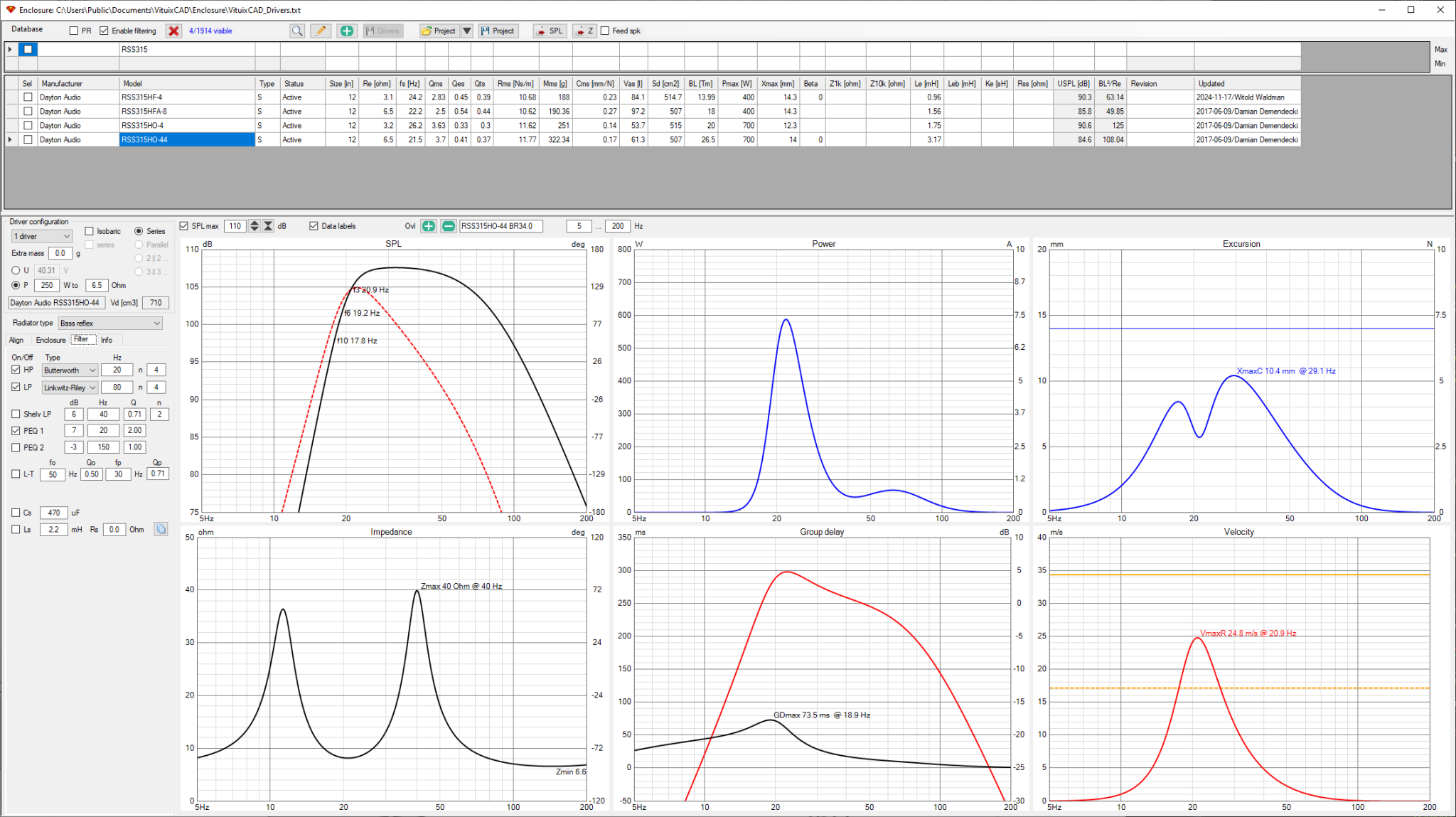

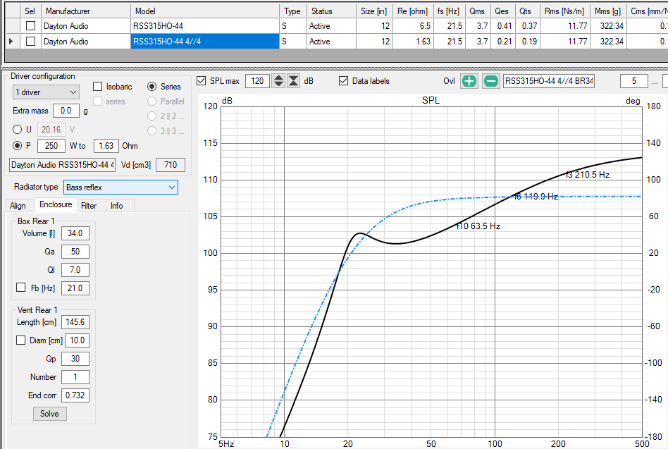

That's quite a low tuning frequency for such a small enclosure. It could be described as impressively low...With a net volume of 34 liters, WinISD gave me a 24 Hz tuning. First port resonance should be 152 Hz which I thought was acceptable.
The formula that WinISD uses is likely based on a simplified/idealized formulation that doesn't apply as accurately when the port length is 1.1 meters. Having three sets of 90-degree turns could have created a bit of a blockage, which may show up as an added-mass effect. The extra mass drops the port resonance frequency.When I tested the fininshed box, it turned out that the tuning frequency is actually 21 Hz. Not sure why it's considerably lower than WinISD gave me with this port length?
The stuffing increases the effective volume of the enclosure, which in turn reduces the port resonance frequency for a given set of port dimensions.I used a bit of stuffing (not a lot), so that might be the reason.

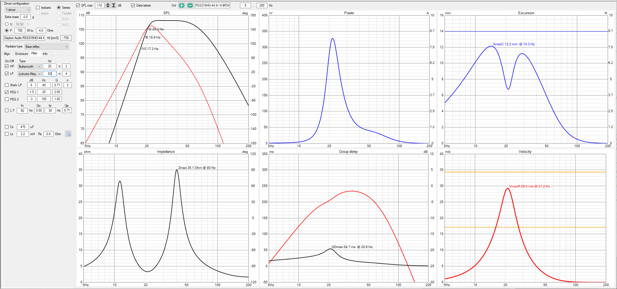

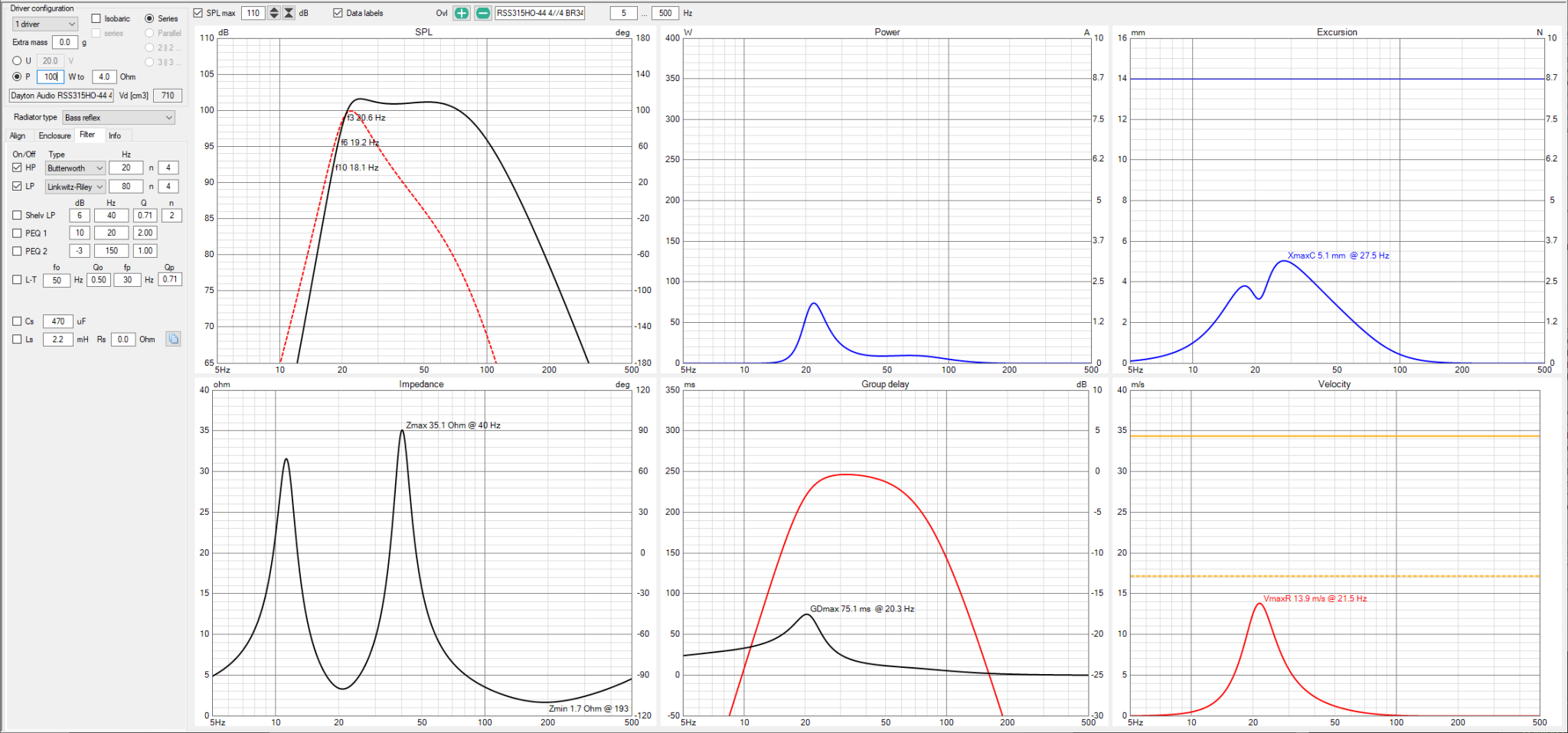

Below is a simulation of the filter-assisted vented-box 34-litre enclosure with a tuning frequency of 21Hz.

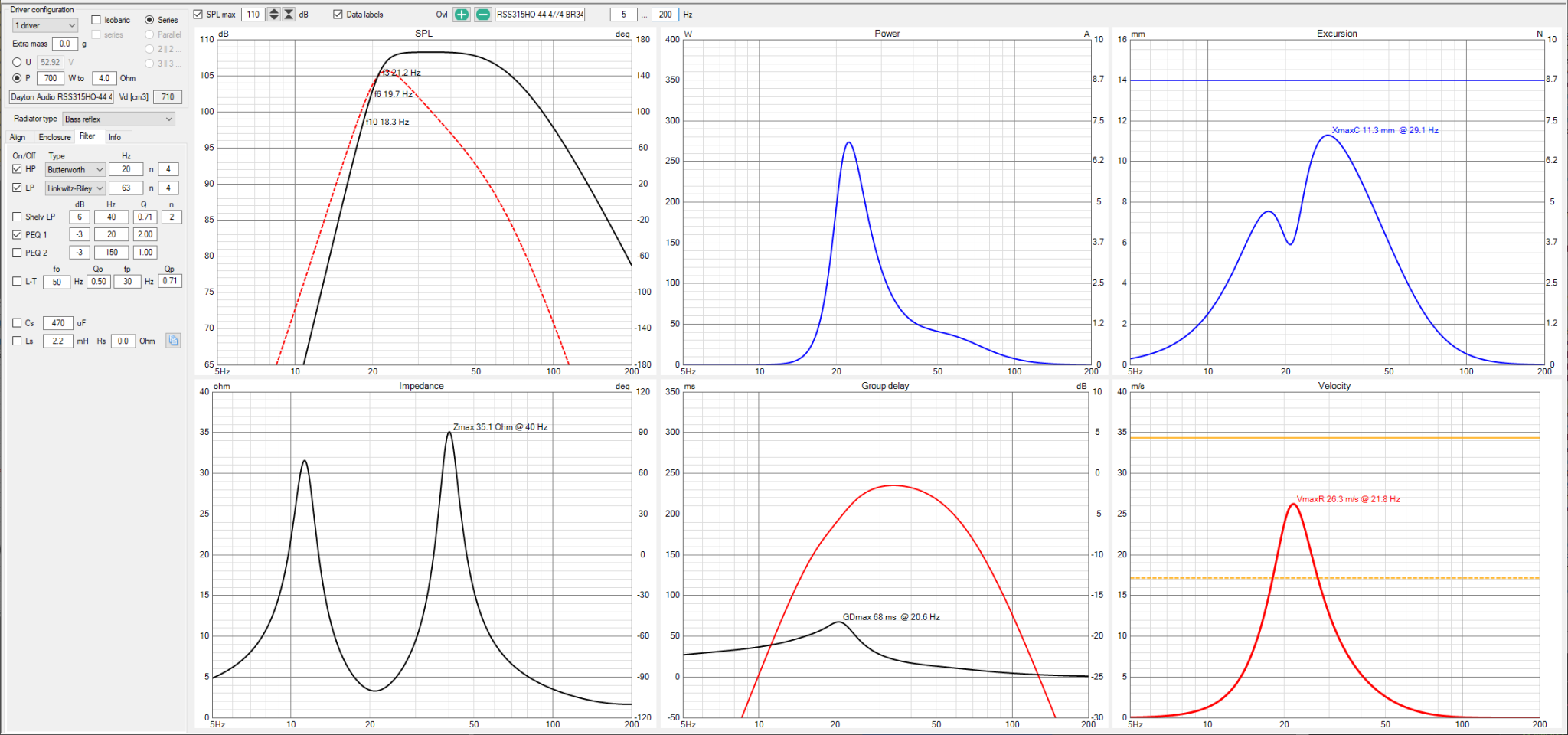

If we drop the PEQ boost at 20Hz to be only +6.5dB instead of +10dB, we get the following flatter response in the passband of the subwoofer.
I notice that you've labelled this with RSS315HO-4. Note that my driver is the DVC version, 315HO-44. Not sure how much it means, but some of the parameters are different. For instance the Fs is lower for the 44. I'm running it in 2 ohm config now, with 700 W available from one channel on the Crown.Below is a simulation of the filter-assisted vented-box 34-litre enclosure with a tuning frequency of 21Hz.
I didn't get a curve as steep as yours when I modelled in WinISD, but I'm sure your model is more accurate. I do like the upwards sloping curve. Still, you're probably right that it might be too much. Will do some tests with reduced boost.

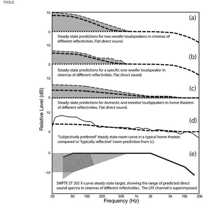

What you describe as "the upwards sloping curve" is a downwards slope with rising frequency as preferred by most listeners.I do like the upwards sloping curve. Still, you're probably right that it might be too much. Will do some tests with reduced boost.
https://www.avsforum.com/threads/jb...54077/page-214?post_id=57291428#post-57291428
As Floyd Toole wrote:
"Almost 50 years of double-blind listening tests have shown persuasively that listeners like loudspeakers with flat, smooth, anechoic on-axis and listening-window frequency responses... When such loudspeakers are measured in typically reflective listening rooms the resulting steady-state room curves exhibit a smooth downward tilt.
Peaks can be attenuated by EQ, but narrow dips should be left alone... Once the curve is smoothed there is the decision of what the bass target should be. Experience has shown that one size does not fit all. Music recordings can vary enormously in bass level..The upshot is that we need a bass tone control and the final setting may vary with what is being listened to, and perhaps also personal preference. In general too much bass is a "forgivable sin" but too little is not pleasant 🙂"
Whether you prefer a low frequency target slope of "flat", +3dB, +6dB or more is up to you.
In general, the lower your listening volume, the steeper the downward slope, or "too much bass" is preferred.

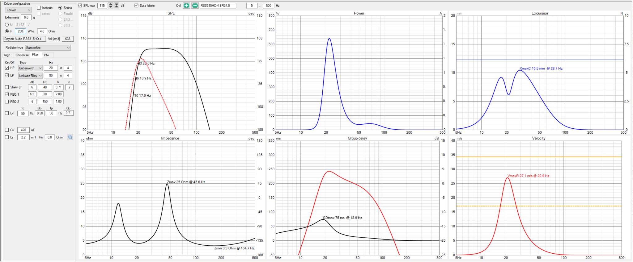

Apologies for my mistake. I've changed over the driver, and the simulations for it with the two voice coils connected in series are shown below. In this case, the PEQ at 20Hz can be reduced by 3dB to be set at +7dB.I notice that you've labelled this with RSS315HO-4.
The Thiele–Small parameters are certainly quite different, with the Fs value being noticeably lower. However, as you are not using an empirical alignment, having detuned the enclosure and applied compensating filter assistance, the response is an amalgam of many factors. This seems to be borne out by the simulation results presented above.Note that my driver is the DVC version, 315HO-44. Not sure how much it means, but some of the parameters are different.

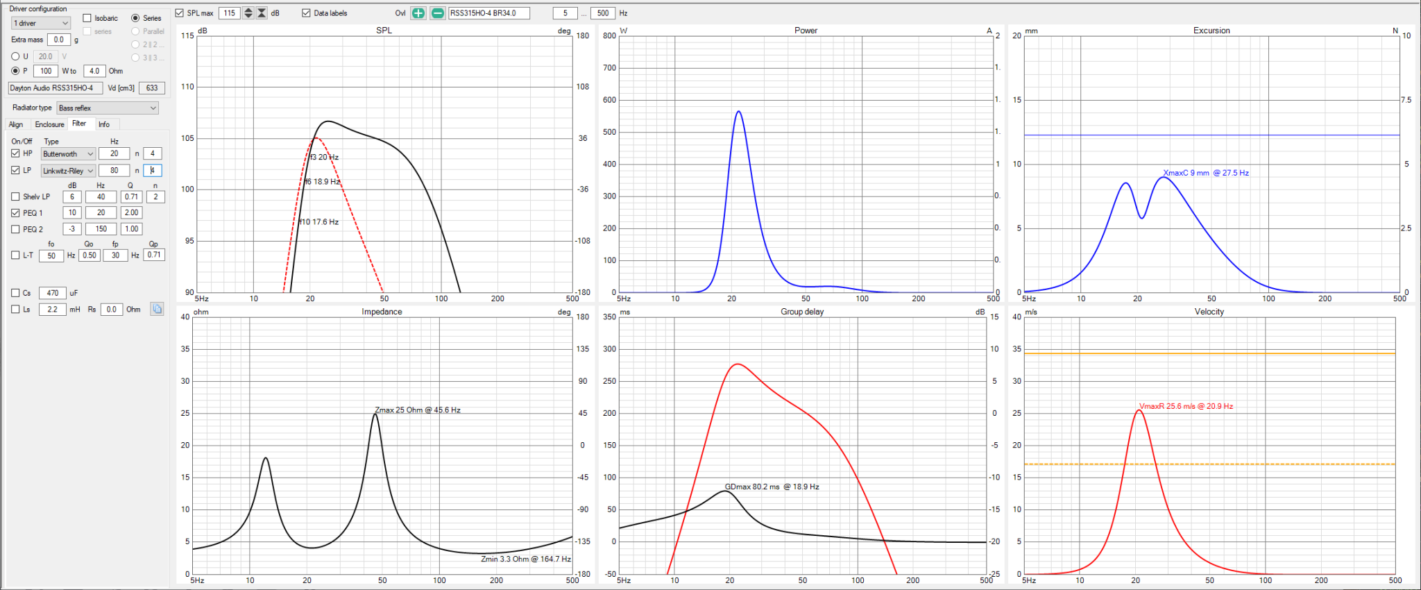

When using the system tuned for maximum passband flatness, if you dropped the cut-off frequency of the 4th-order high-pass Butterworth filter from 20Hz down to 18Hz, you would be able to eke out an extra 1–2Hz of bass extension. This wouldn't significantly change the maximum excursion of that configuration.
I think that means that the Qes of the driver in this voice coil configuration is 1/2 that which was provided in the datasheet. On that basis, I've performed a simulation of the vented-box enclosure with the 21Hz tuning but without any filter assistance. The dashed cyan curve is the response of the driver in the series voice coil configuration. The very droopy response when the voice coils are connected in parallel is quite evident. Note that the DC resistance is 1.63ohms, which is almost 20% lower than 2 ohms.I'm running it [315HO-44] in 2 ohm config now, with 700 W available from one channel on the Crown.
After adding the 4th-order Linkwitz–Riley low-pass filter set to 80Hz, together with a 4th-order Butterworth high-pass filter set to 20Hz, the following simulated response is obtained. This produces an upper −6dB cut-off frequency that much higher than the desired 80Hz.
We can adjust the L–R filter's setting downwards to 63Hz to achieve an acoustic −6dB point at approximately 80Hz. It is also possible to apply −3.0dB of PEQ at 20Hz to tame the slight peakiness in the low-frequency response. The result is shown below.
The system can be tweaked to another configuration, this time using a 20Hz 2nd-order Butterworth high-pass filter. This keeps the driver displacement at low frequencies nicely under control, but has the added benefit that the group delay will be a little less than with a 4th-order high-pass filter in the signal chain. Setting the PEQ at 20Hz to be −1.5dB instead of −3.0dB, the simulation yields the following response curve.
