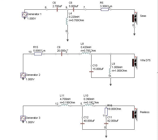

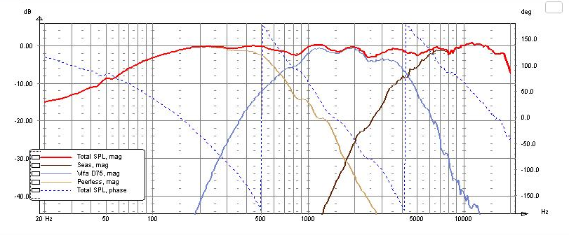

You may have missed a trick there. As m'learned friend, Lojzek did mention, the 3" dome Vifa D75MX aka Scanspeak D7608/920010 is still available. You really should be looking for something just similar, not ropey old fleabay units. Easy enough to tweak a speaker.
Scanspeak D7608/920010 Mid Range - Vifa D75MX-41/08 replacement
Used like this:
Dali7A Nyt Delefilter - SpeakerBuilder Forum - Page 1
It was also used in the Dali 7A. The tweeter was always a 3/4" SEAS 19TAF/G dome. The woofer looks like an 10" foamed paper peerless or Vifa.
Used like this:
