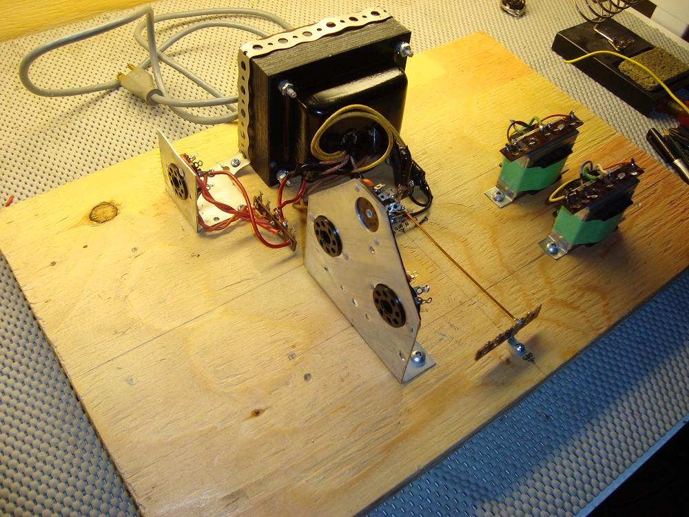

Here's what mine looks like so far. Just in the breadboard stage.
It was a good suggestion that the other fellow made to make it non permanent. I salvaged some sockets etc. from old amps. It's nice because I will have the parts leftover to mock up other projects down the road.
I did have to rotate the socket for the rectifier so that pins 2 and 4 are vertical on the 5Y3. The 5UG wants pins 1 and 4 vertical, so I just split the difference.

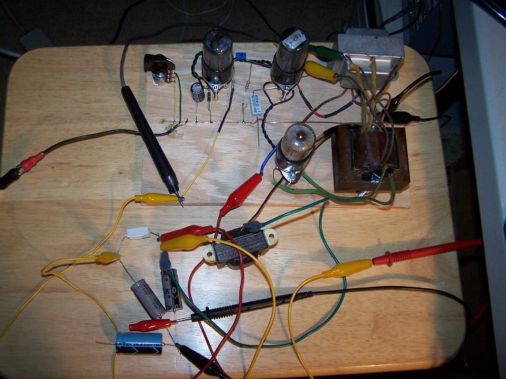

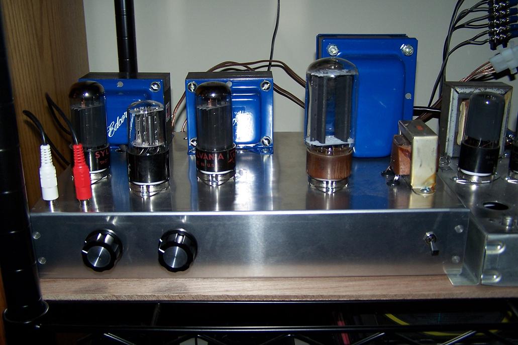

I have 4 tube amps I rotate listening to. The 6V6SE, a 6V6PP, a 6BQ5PP and a 6GW8PP. I have no clue what rating the choke has. Pulled it from a trashed power supply someone gve me.
This is my 6V6SE on my breadboard. Not as fancy as yours
Hey as long as it works.
I use those clips for mocking up lots of SS stuff, although my clips seemed a little weak, sometimes one would let go if you moved the board and leave you wondering whats wrong, lol. The clear plastic is a good idea.
Well your choke seems to be bigger then the one I have. I might have another one somewhere. I got a monster of a choke from an old HP-23 HAM radio power supply in use in my other amp. I should have a look around and see if I have another hiding.

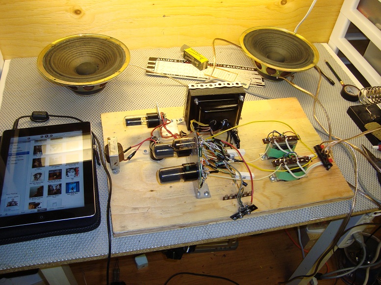

OK, so I have 305V with tubes in (should be 300v), close enough.
I've got 47uf and 150uf caps in the pi filter. Schematic calls for 220uf for the second cap.
Now it is my understanding that the first cap should be lower and the second cap can be what ever value you like. I did find with the PSUD that I was getting forward current warnings with just about every combo I tried, goes against what I've been told, the second cap does seem to reflect a change in rectifier current. According to the program anyways.
I have six speakers per channel wired up to give me ~8ohms.
Sounds pretty decent I suppose. I'm not exactly blown away but it does seem to have slightly better imaging then my 6CG7/6V6 PPP amp at low volume. That's about it. I guess this says a lot about my PPP. Might try some different tubes in it. I tried to have neutral expectations, but I was expecting some goosebumps. It's not any worse then my PPP, thank goodness.
The bass is satisfactory, so all in all it's a good candidate for a lower powered daily driver.
I will build this amp in to a nice enclosure unless somebody has any other suggestions to try.
AL

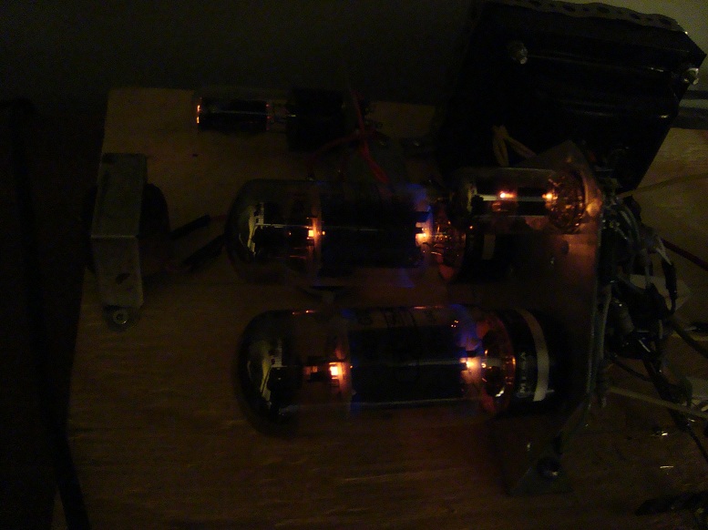

Now it sounds a little nicer hooked up to my PC sound card after being run for a few hours. Listening to some Dark Side of the Moon in FLAC.
Very well behaved amp. Dead silent, accepts full volume from PC sound card with out any noticeable distortion. I like it and I am satisfied. 🙂
