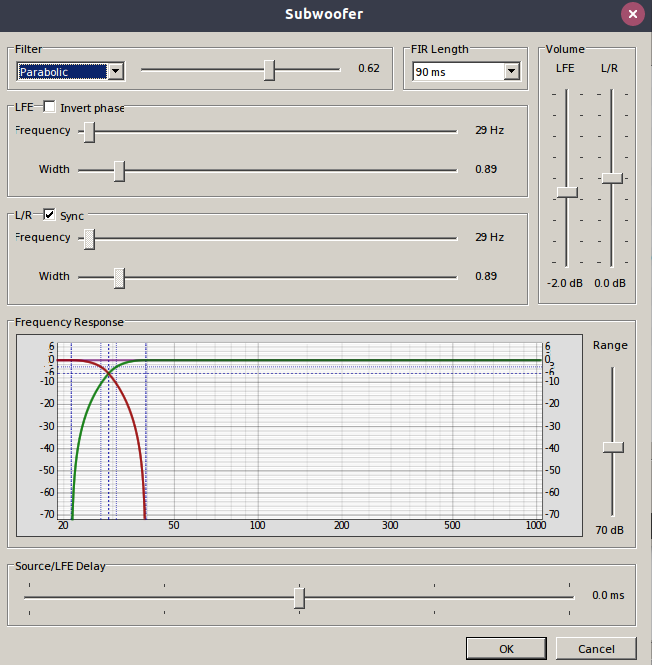

By chance I have one of these units with the dead amplifier...
The driver and box are near mint but the amp is a dog of a thing...mine's covered in tarry goo, presumably for component damping, and so most parts are only recognised by their outline beneath...!
I've taken a different path from you....removed the electronics and sealed the box leaving only a set of conventional speaker terminals.
I'm not after earthquake simulations so have tested with a spare Plinius power amp to satisfactory levels and am now installing foobar2000 and it's recent sub-woofer plugin on my pc.
The plugin is wonderfully configurable !
I'll feed to a usb soundcard with2.1 capability and thence to my main amp and the plinius power amp.
Quite a fun little project and more useful than I thought the yard-sale purchase would be.....(got it for about 3 of your British Pounds...!!)
