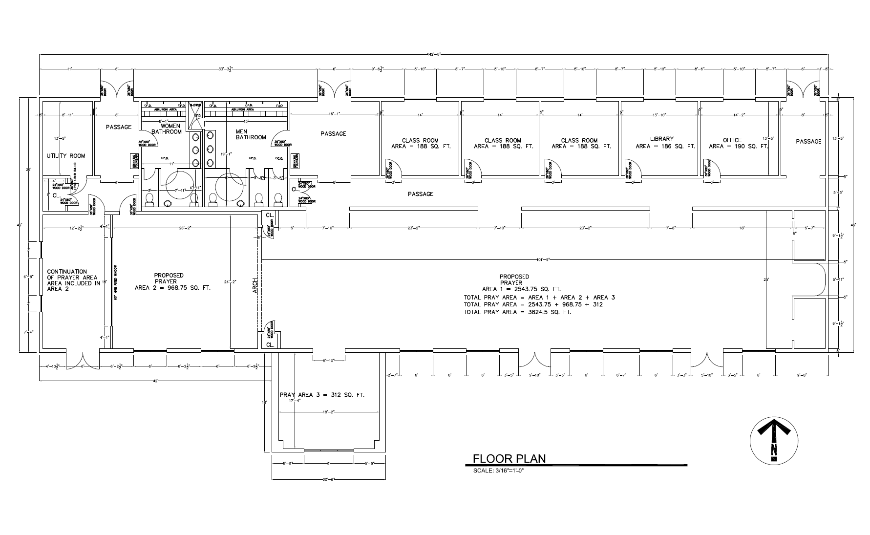

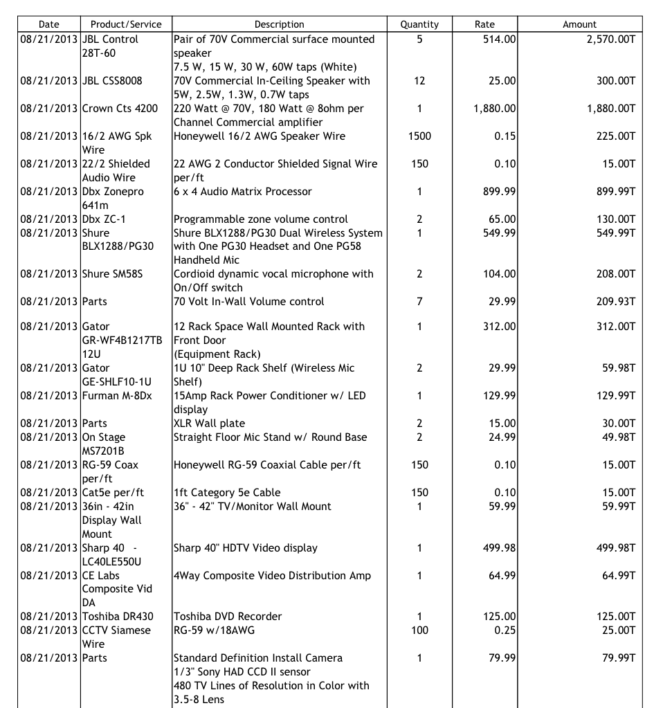

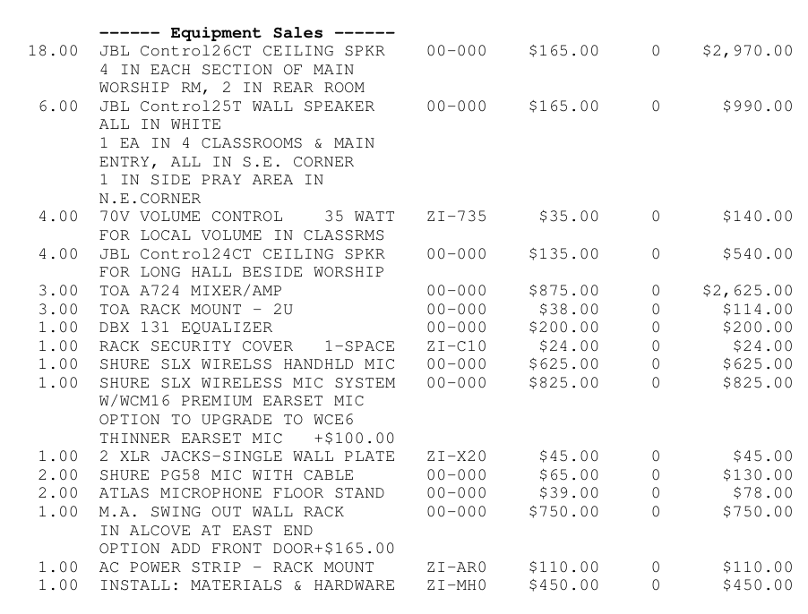

I am new to this forum and a former DJ/AV Tech that is trying to assist their local H.O.W. with a new sound installation (vocal reinforcement, no instruments). I’ve spoken with 2-3 AV design/installation companies regarding speaker and amp offerings, but would like to get some opinions/advice from others that have used these products. I have experience with JBL and Crown, but not with brands such as, Renkus Heinz and Crestron. I’ve done quite a lot of research on RH, but reviews seem to be mixed.
Essentially, I’m trying to get feedback/opinions on the following (full details in attachments):
I was leaning towards the JBL solution, but I’m not sure if the models we’ve been quoted are good vs. what models/series’ might be better? Online searching doesn’t prove very effective.
I’ve attached a floor plan of the space (not a ceiling/speaker layout), if it helps, and 2 material lists. Budget is of course a consideration, but high-quality vocal communication is of the utmost importance.

I read the bid. The locations of the speakers are not detailed on the layout, so no opinion. JBL makes a line of pro quality stuff, it should last a while. Make sure none of the part numbers are on the JBL consumer audio website, they run two different operations, and the consumer audio products have as much smoke and mirrors and as little real sound as any company in that market. The visual is more important than the quality of sound in the consumer market, IMHO, since about 1995. The website splits right the first thing. Used JBL pro quality speakers draw a premium on the used musical instrument market in my area, over Behringer etc.
For speaker location, most churches hang the voice speakers from the overhead. This does require speaker boxes reinforced for this kind of service. Speaker hanging arrangements are not something I recommend to be done by amateurs.
The proposal include $$$$ of shure wireless mikes. My church bought imported radio mikes, and started having a lot of dropouts at the five year boundary. These mikes were all replaced with something else imported. Lets ride the import merry-go-round for another round. I'm not on the sound or music committee, they don't like my opinions. I did like the previous telefunken radio mikes that lasted for a decade. I see shure radio mikes on many of the performances on PBS Great Performances and KET-TV Jubilee.

A 70 v voice reinforcement system does allow the audio/visual committee to add drivers later if there are any dead spots: without running a lot of new wire. 70v systems are usually speech oriented. If more drivers overload the amp, a bigger amp can be bought later when the offering is bigger, without redesigning the system. 16 ga speaker wire should be adequate for this building.
