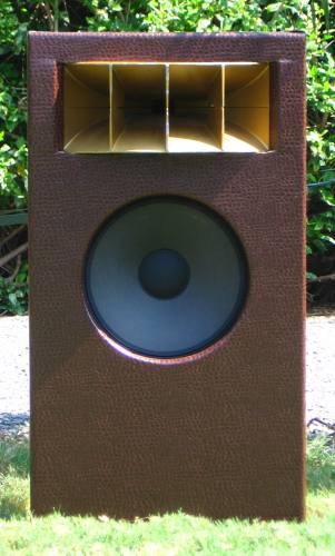

Since I don't know what the EP settings are, I can't comment. The first DCX I purchased was for an early OB build of mine. This one:
86605d1180554828-suggestions-ob-obee-single-jpg
It took about a year for me to understand how different open baffle is, and how to make the crossover work. I was coming from a box speaker perspective and that took a long time to shake off - and I had guidance from my friend John Busch! Getting the tonal balance right on OB takes some learning.
The DCX Makes it fast and easy to try different things and to save different settings. As Dave mentions, the stock analog output section isn't great, but that is easy to fix. Then it becomes a powerful tool.
