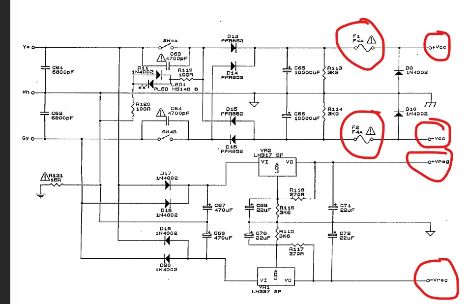

The fact that you shorted out only one of the loudspeakers, but both channels have stopped working, just may indicate the fuses have blown in the power supply. Check F1 and F2 which are shown in the power supply schematic.
If the problem extends to the power amp, then the output transistors may have been protected by the fusible resistors R89 to R95 (indicated by exclamation marks in the power amp schematic).

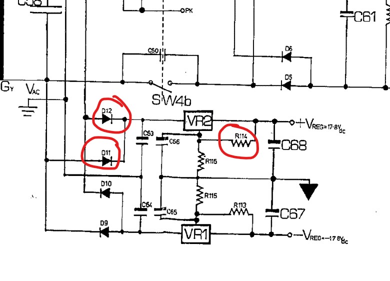

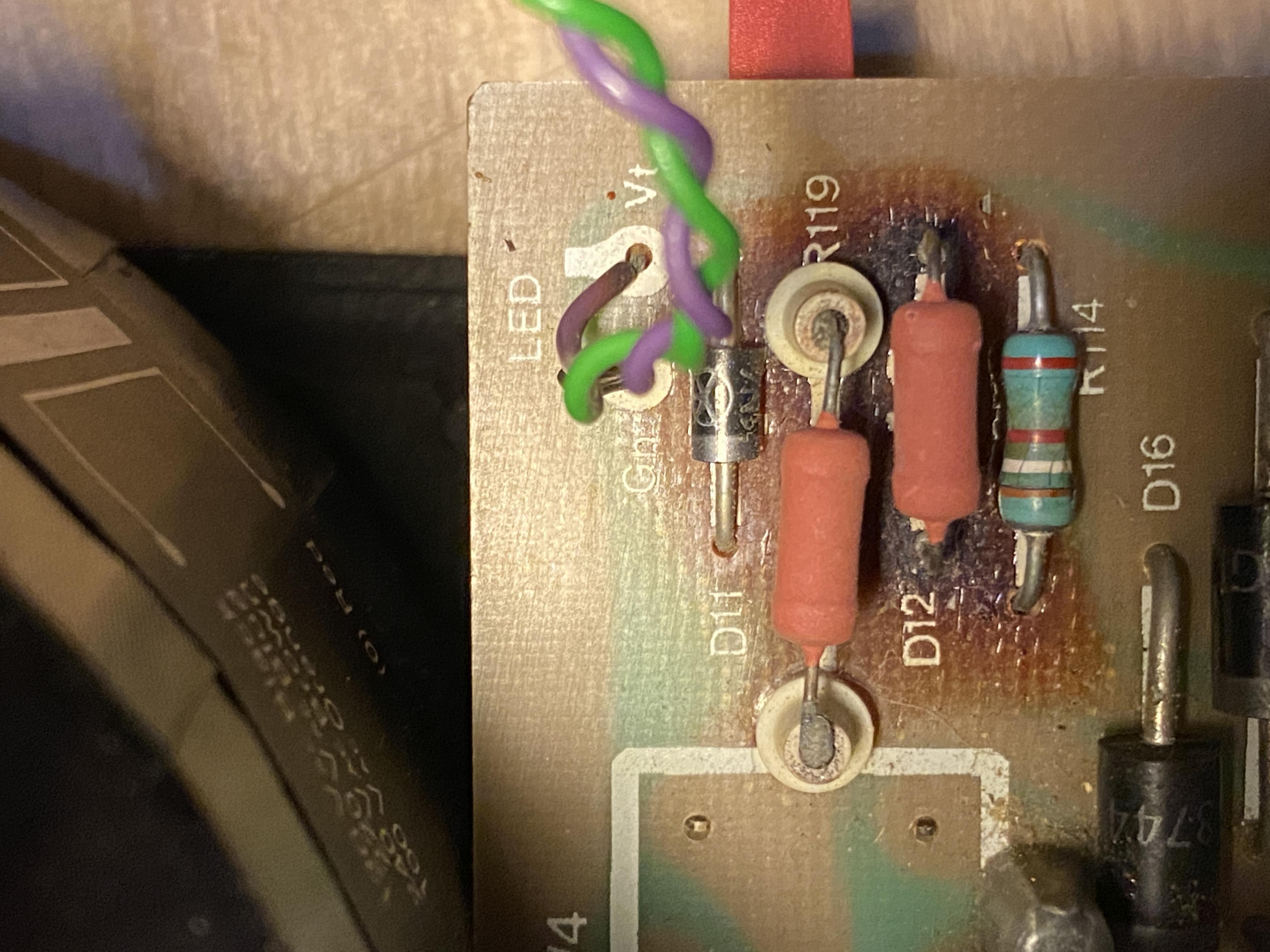

Hi all
I'm posting this as a long shot that someone might be able to help, although I realise it's an old thread. I recently inherited a Cyrus Two amp from my late father-in-law which has blown, and I'm going to try repairing it myself. Having looked at the PCB it looks as if the issue is around the power area, with D11, D12, R119 and R114 all featuring scorch marks. Having had a brief contact with Cyrus I have been told the resistors and diodes required for D11 and R114, and have worked out that R119 is a 100R resistor. However I am at a loss to which part I need for D12. Cyrus have gone quiet on me and the parts list does not mention D12. Bizarre. I found this thread while searching Google and you all seem to have a lot more knowledge than me, so I hope you can help.
OK I think I've worked it out. Hopefully you can see it!
That's it :up:
So... from left to right we have a diode and three resistors. That oxide red part where it says D12 is a resistor.
Also looking on a Cyrus 2 circuit and I can't just locate an R119... but there are two R115's
The diode/s I would suggest you would be safe with 1N4004 or 1N4007.
Your picture doesn't look anything like the circuit diagram though.

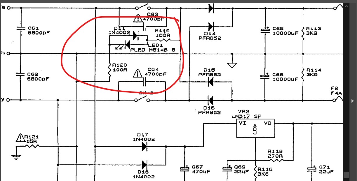

I'm pleased you said that, because I couldn't make head nor tail of the circuit diagram either, even though I don't really know what I am looking at. One thing that has confused me is that if you go buy the Cyrus 2 PCB parts list, anything with a D should indicate a diode, so why would a resistor be where a diode should be in D12? I do know my father-in-law would have been unlikely to have attempted any repairs to this himself, but I wonder if anyone else has?
I suspect there may be errors possibly both with the board markings and the component references in the manual.
Could D12 actually mean R120?
If you look at the circuit it shows two 100 ohm resistors effectively in series together with a IN4002. Those are placed across one side of the transformer winding.
The LED is across the 1N4004.
Electrically it is OK but the values are just crazy because 200 ohm in total will pull a lot of current. If the AC is say 30 volts (which is mentioned in the manual) then the peak current is (30*1.414) / 200 which is 200 milliamps. That can't be right. Ancient old inefficient LED's use a twentieth of that.
I think it's going to be best not to assume anything but begin by looking at the fault presented and working from that point.

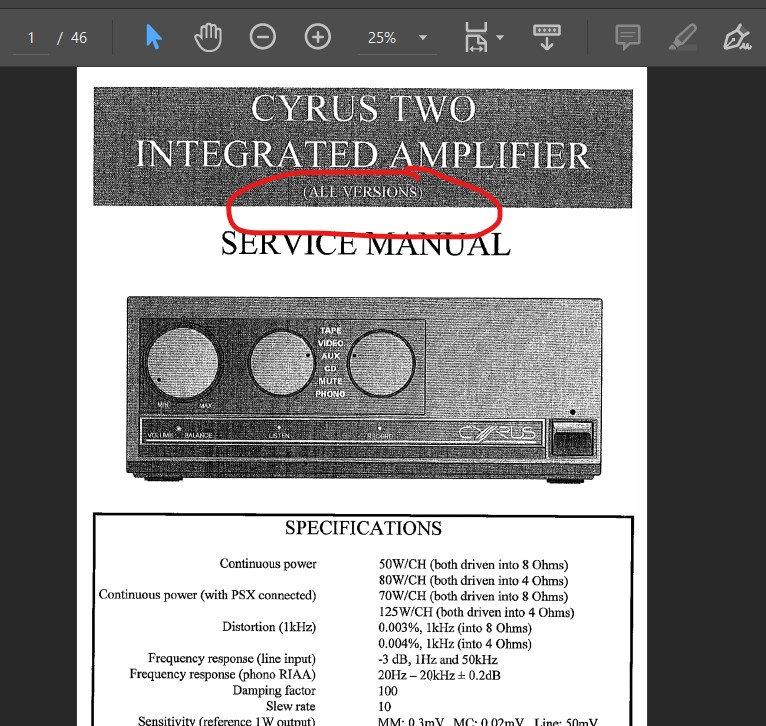

I was under the impression that the parts in question that need replacing relate to the power supply (P17 of the manual), which is why the unit doesn't power up. This is a series 7 amp and the paragraph in the manual relates to series 6, however.
Do you think it's worth replacing like for like here? Is that what you mean by looking at the fault presented?
I'm no expert in these matters. I think I can replace a couple of parts but finding other faults could well be beyond me!
We do really need a correct diagram in order to be able to match what you are seeing. This the manual I'm which supposedly covers all versions.
That area of the circuit does seem to be just related to the LED... maybe it is a bulb rather than LED which would explain the crazy values...
Start at the beginning which is always to check all voltage supplies are correct. There are two fuses shown and four points to check voltages on. +vreg and -vreg should have approx + and - 18 volts respectively on each point. There should be approx 40 volts DC on each fuse and at each end of the fuse.
Those are your first tests. Just to replace parts in hope isn't really a good plan.

Yes Mooly you suspect well there are errors with the board and the manual.
D12 is R120, i replaced the 2X100R (R119 and R120) with 3W resistors because the others was very hot(smoke), but they still remains very hot.
I am very surprise of this, i am asking myself " why not taking the power after the bridge and use one 3.9k 1Watt resistor"
I am looking for the PLED H514B-5 datasheet..Thanks
R119 and R120 are shown as feeding just the LED from the AC side of the bridge. 100 ohm looks very wrong. I would fully expect those values to smoke tbh 😀 Quick guess would be something more like 10k as being suitable. The PLED H514B-5 is just an LED.
If fed from after the bridge it would fade out slowly on power off rather than an abrupt off. On advantage is the LED flicker would be removed.
It depends on your LED and how efficient it is. Modern ones can burn your eyes out at only a milliamp or two 😉 so its trial and error to get the brightness you want. You might need to go lower or higher.
