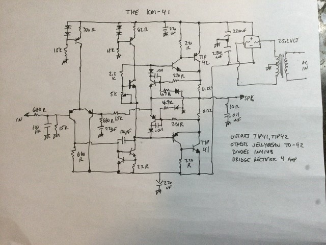

twenty five watt retro amp with speaker cap for no speaker burn: https://www.diyaudio.com/community/threads/retro-amp-50w-single-supply.236256/page-31 post # 606 . From apex
6 transistors.

Maybe I should just build the KM-41, should have everything needed laying around. Found a few of the TIP41/42 and I've got loads of BCwhatevers in TO-92 packages laying around. Seems like a lot of transistors though? Also no output cap? I'll probably add one if I follow that schematic

That's really nice and simple, I like it! Don't have the those specific BC transistors though so I'd need to swap them for something elsetwenty five watt retro amp with speaker cap for no speaker burn: https://www.diyaudio.com/community/threads/retro-amp-50w-single-supply.236256/page-31 post # 606 . From apex

Finished putting together the retro 25W circuit on a breadboard, not getting any output and when the input voltage gets to about 15-20V the top 1N4148 explodes... All the transistors come out good on my tester though even after the 1N4148 has popped a couple of times so that's something at least.
Didn't have the listed transistors so I did the following substitutions:
BC560 -> BC557b
BC639 -> BC337
BC640 -> BC327
BD243 -> 2N6123
Most likely the issue is somewhere in the wiring but maybe it's in the choice of transistors, no clue. Will probably rebuild it tomorrow and see if it starts behaving 🙃
I'd expect some output but with a 1kHz 2Vrms test tone as input I get no output over my dummy 4ohm load. There is current draw until the diode pops so something is doing something at least.
I don’t know what would cause the diode to poof other than collector-base breakdown in the NPN driver. If that is happening around 15 or so volts I might suspect you’ve got collector and emitter reversed. It normally kills the transistor if there isn’t anything to limit the current.
Those BC### transistors have pinouts all over the map. The BC639 datasheet I have shows with the flat pointing at you ECB which is as weird as a cat's pajamas. BCE and EBC are more usual pinouts of TO92. Different brands may have different pinouts in TO92.
You could put a 22 ohm >2 watt resistor in for the fuse and slow down explosions until you can probe the circuit for improbable voltages. Us an alligator clip on the negative and I find I slip the probe less onto random points with a Pamona grabber instead of a inch long bare probe.
Good thing you pointed out the pinout... I just assumed they would all be BCE but the BC557b is CBE, so that's definitely wired wrong at the very least 🤦probably not BCE for the 300s either and that's likely why the 1N4148 is going poof 😅Those BC### transistors have pinouts all over the map. The BC639 datasheet I have shows with the flat pointing at you ECB which is as weird as a cat's pajamas. BCE and EBC are more usual pinouts of TO92. Different brands may have different pinouts in TO92.

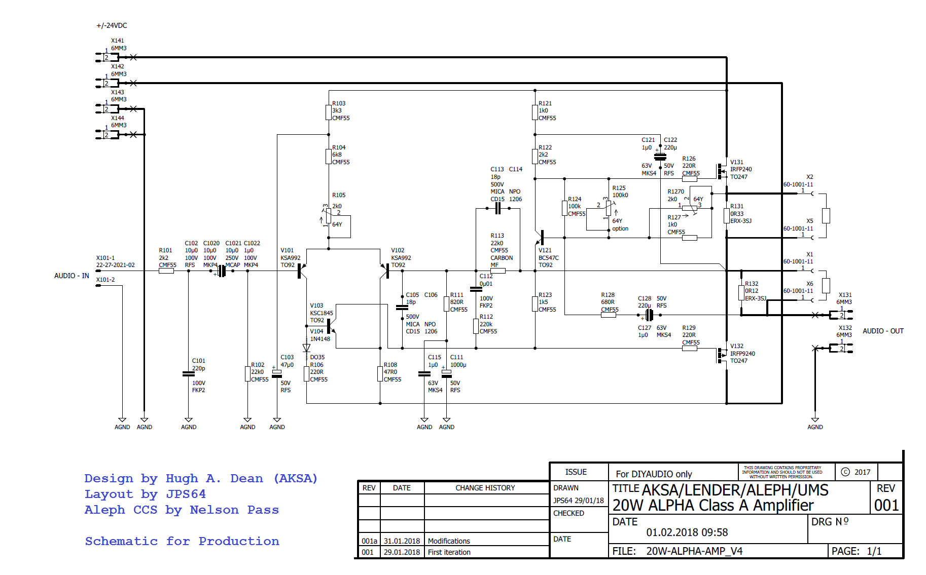

There is the Aksa Lender based Alpha 20 design by Aksa. It’s 20w Class A. There is a 4 ohm mod discussed in thread.
Here is link to 4ohm variant by Danny66:
https://www.diyaudio.com/community/...rid-aleph-alpha-amplifier.318102/post-5536066
