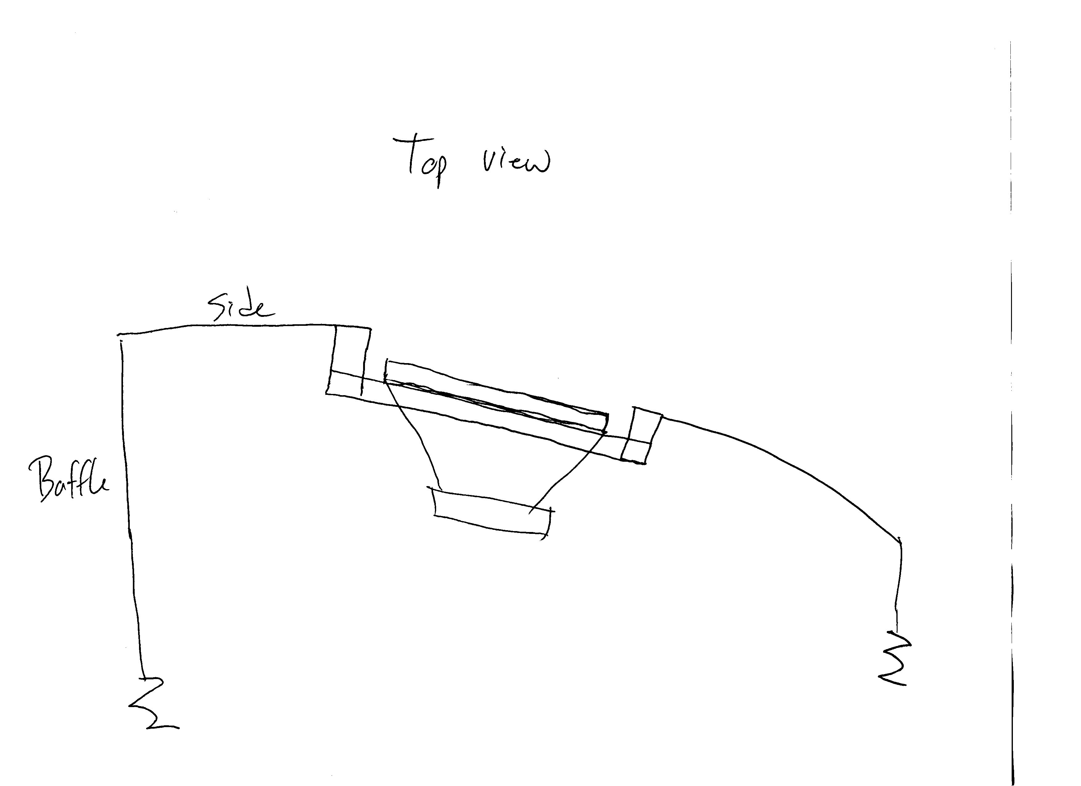

If you need a slim face you could mount the 8"ers, one on either side, and mount a 5" and tweeter on the front.
Sorry I forgot to mention the curved cabinet. Can't mont anything to the sides or at least itwould make the construction tough. Originally I planned 10"ers to the sides, but the curved cabinets won the vote with clear numbers.
You could build a mounting flange that is tapered to the contour of the cabinet with a rebated baffle to mount the driver and mount it to the inside of the cabinet and cover with grille cloth.
That's true, but I'd rather stick with the looks that I have planned so far. Thanks, though. 🙂

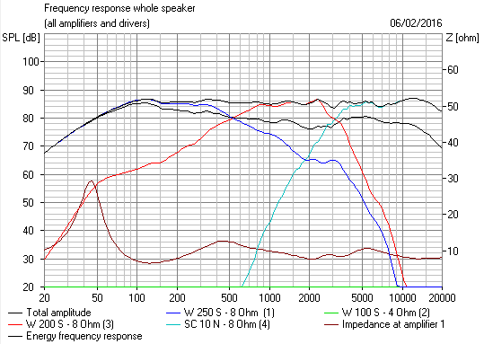

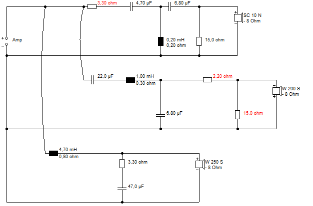

We had a question recently about using an 8" mid as a midrange.
I thought that was pretty daft considering the conventional wisdom says the mid should be somewhere in size between a big 8" bass and 1" tweeter. About 4".
SEAS-3-Way-Classic
Then I modelled it, and I found it actually worked rather well. 😱
See the impedance correcting attenuator you can then use on the efficient 8" mid makes the filter work rather well.
So while you might consider 2X 6.5" SB Satoris as best used in an MTM or 2.5 way, the three way option might be superb! The third option. 😎

Curved side cabinets can be difficult to construct, and also reduce volume. Some designs provide artisic value from simple front baffle treatments like: large radius edges; beveled edges; mixing wood types; curved shapes. Flat panels of Baltic Birch are popular. Clever box dimensions plus bracing reduce resonances. Popular TM-WW cabinets like Sony SS-AR1 and Avalon EDGE use simple baffle edge cuts.
Attached a few 3-way box ideas to help discussion.
