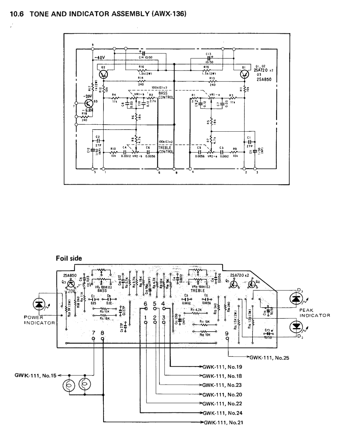

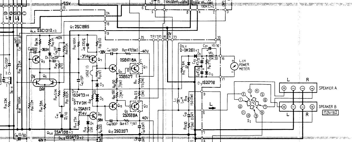

Nope, no relay in schematics...
I still need 2x 1uF/50V (C11/C12) WIMA cap for the tone control, I didn't consider this board but just the main one 😢

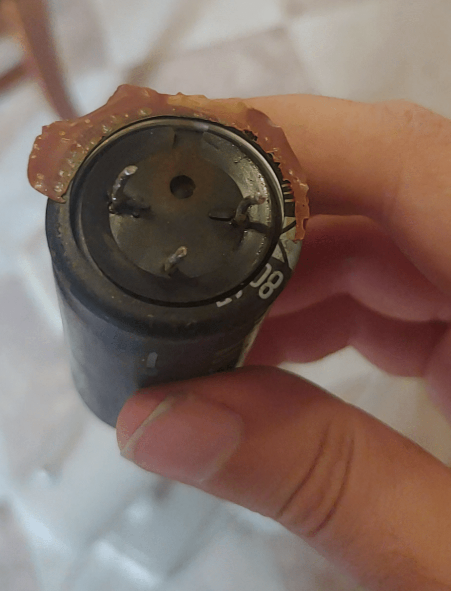

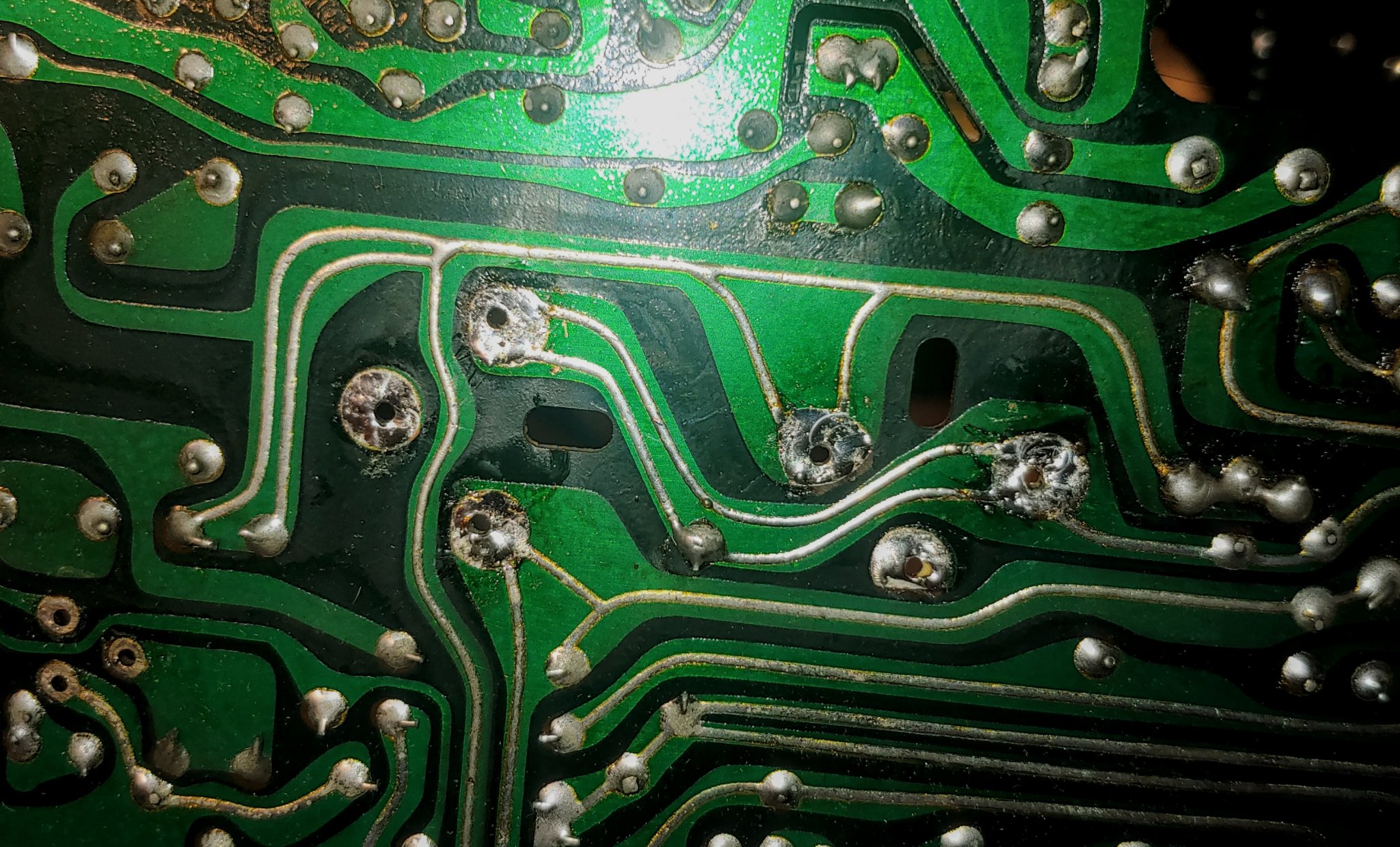

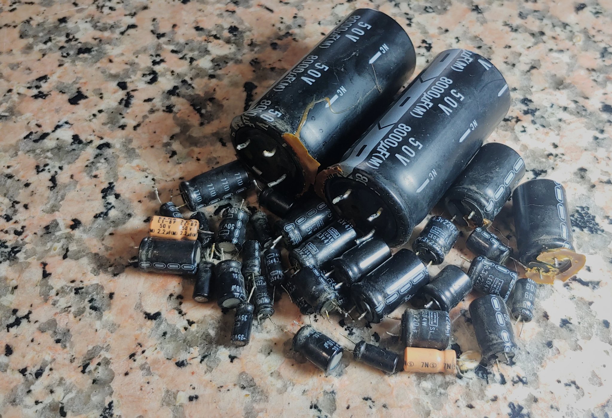

I noticed that some electrolytic capacitors had leaked on the board, they were so light.

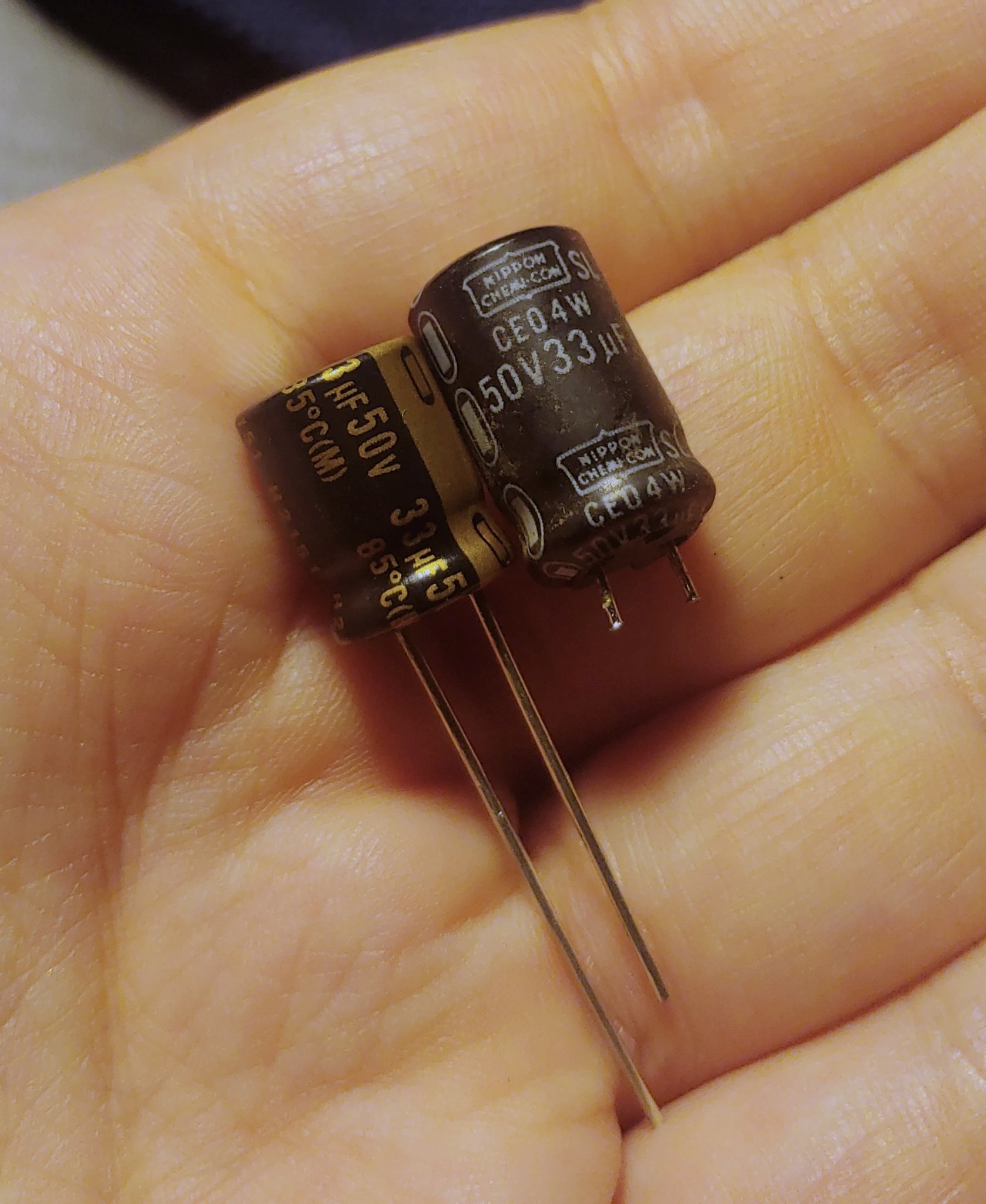

The old filter caps were 8000uF/50V had 3 pins, one of them was for physical support for the mounting, I replaced them with 2x 10'000uF/50V caps.

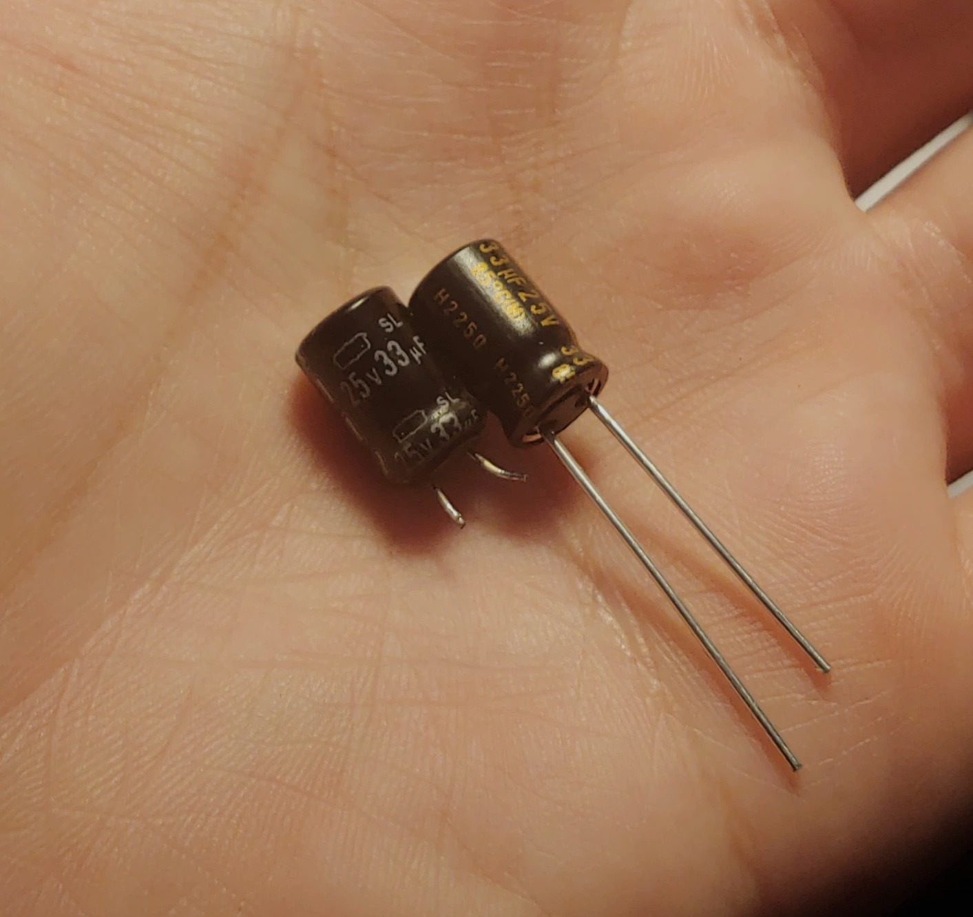

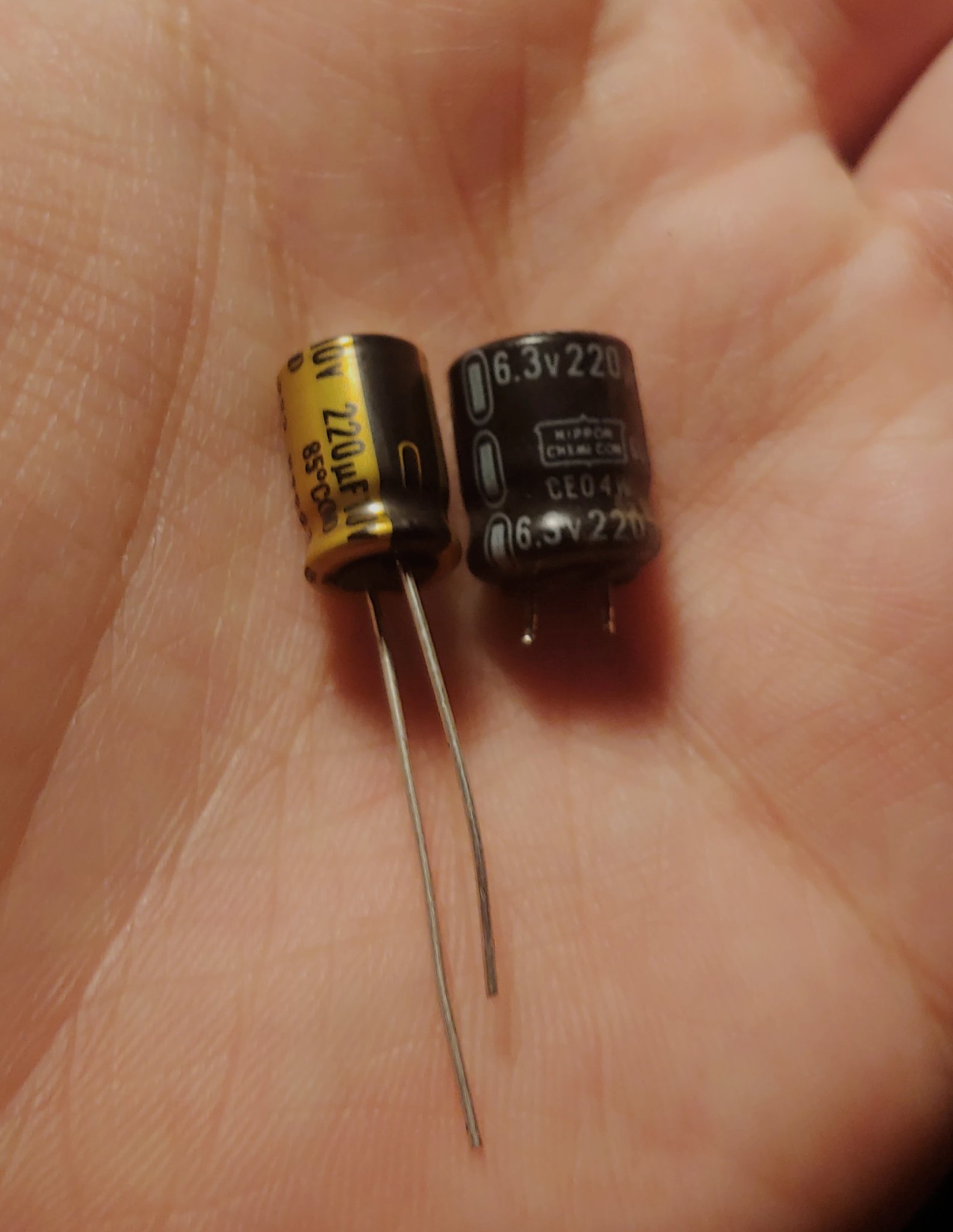

These are the replacements for the capacitors (unfortunately, I forgot to take a photo of the filter capacitor):

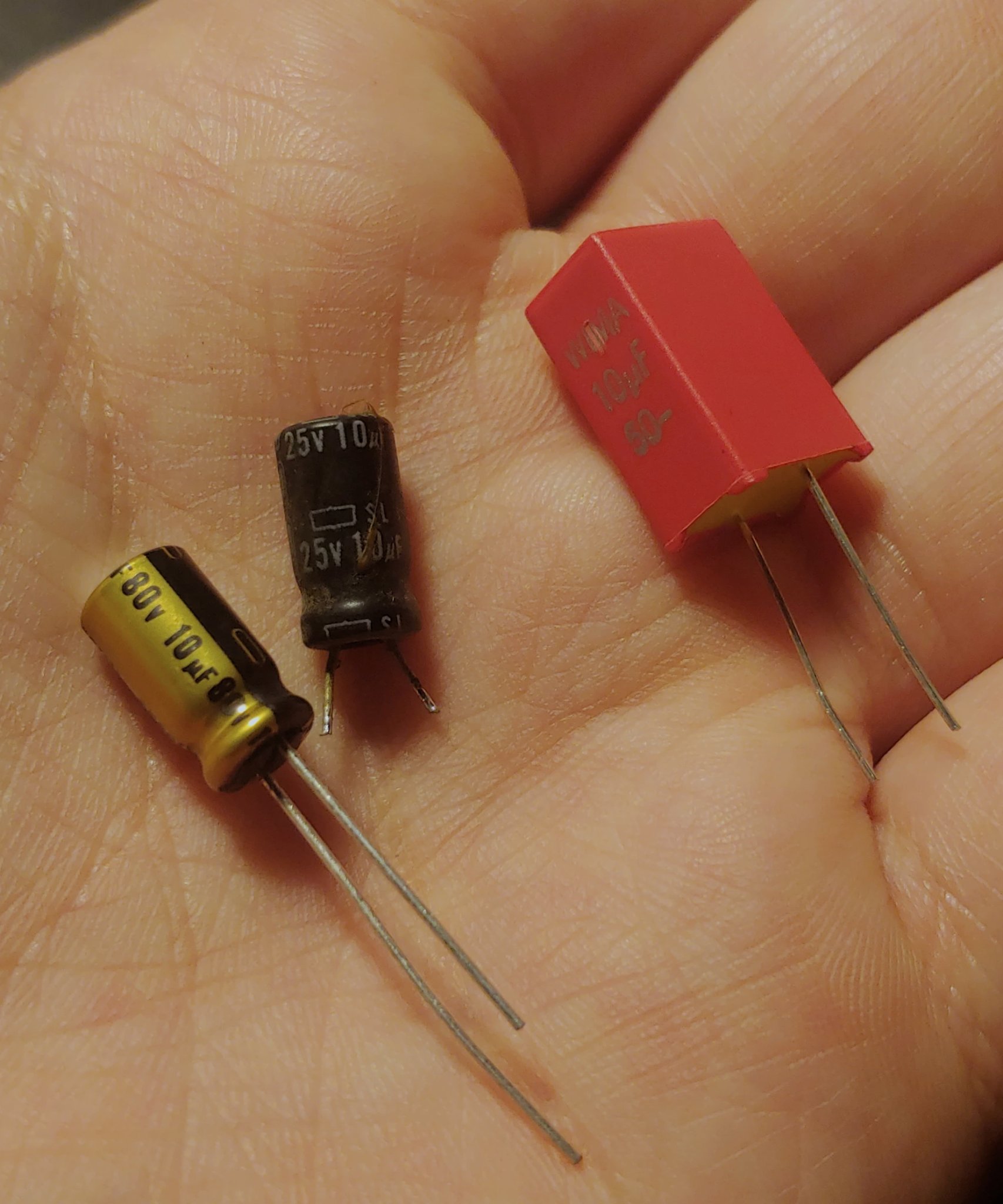

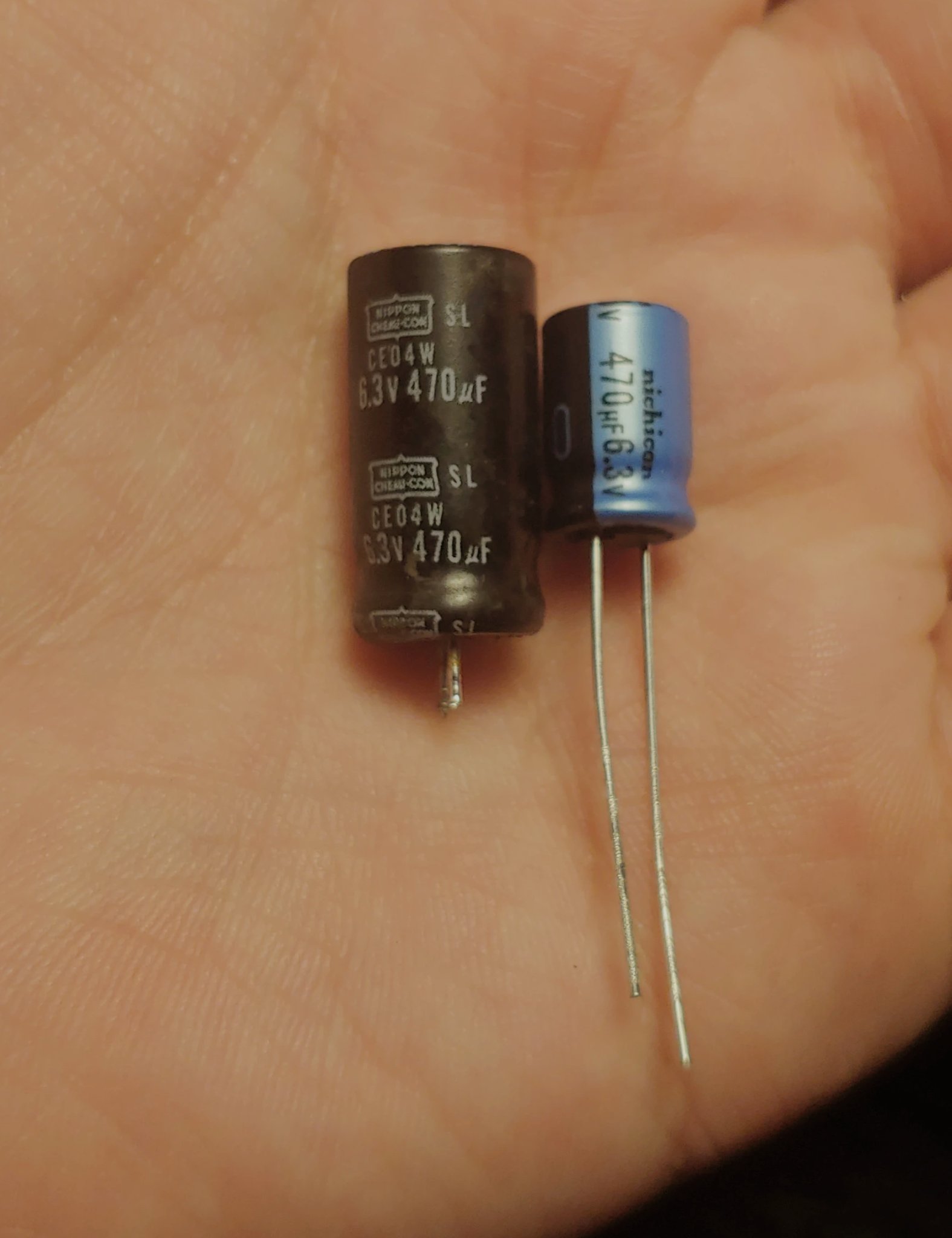

Man the improvements of tecnology always surprise me, look at the size difference!

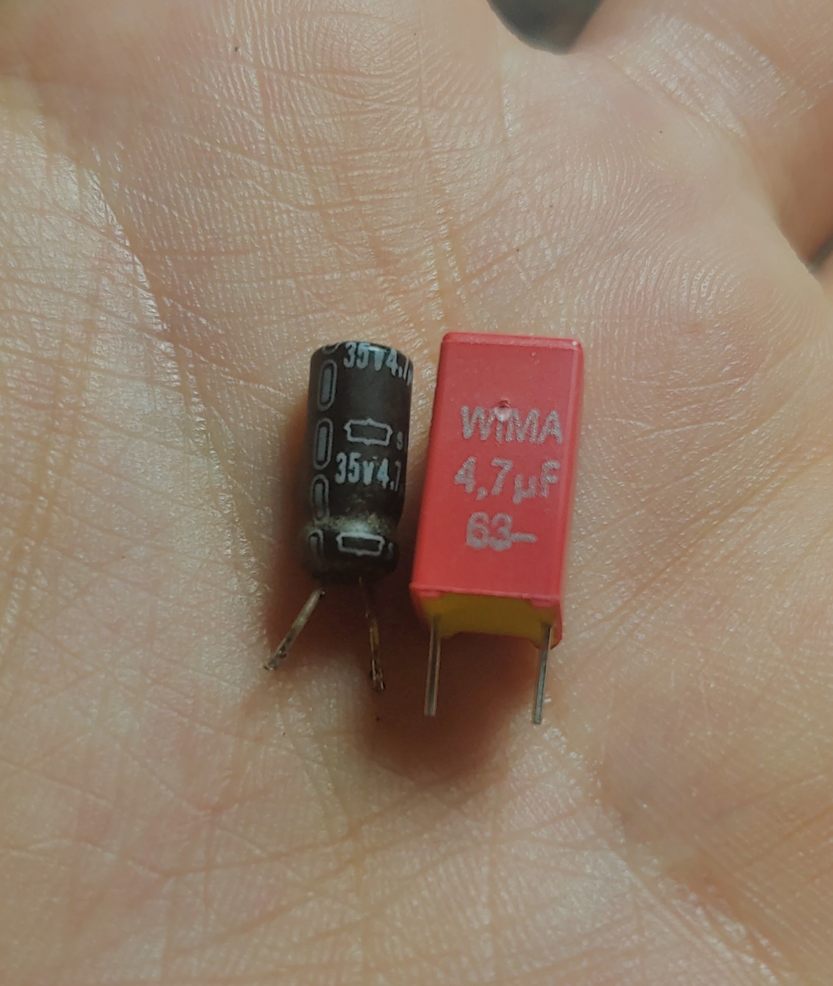

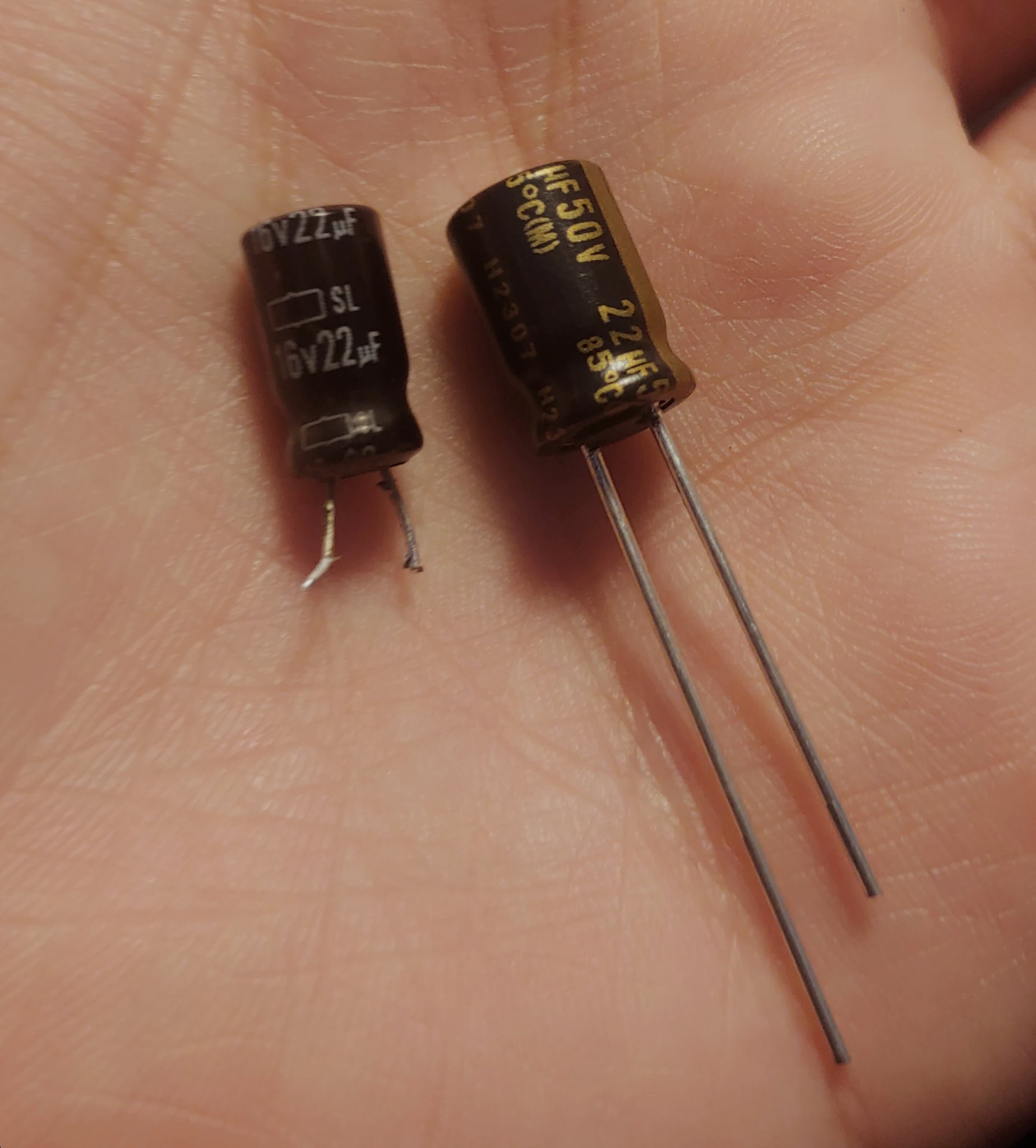

Here I had alternatives depending on the space used on the PCB. (80V of capacitor because Mouser had finished everything)

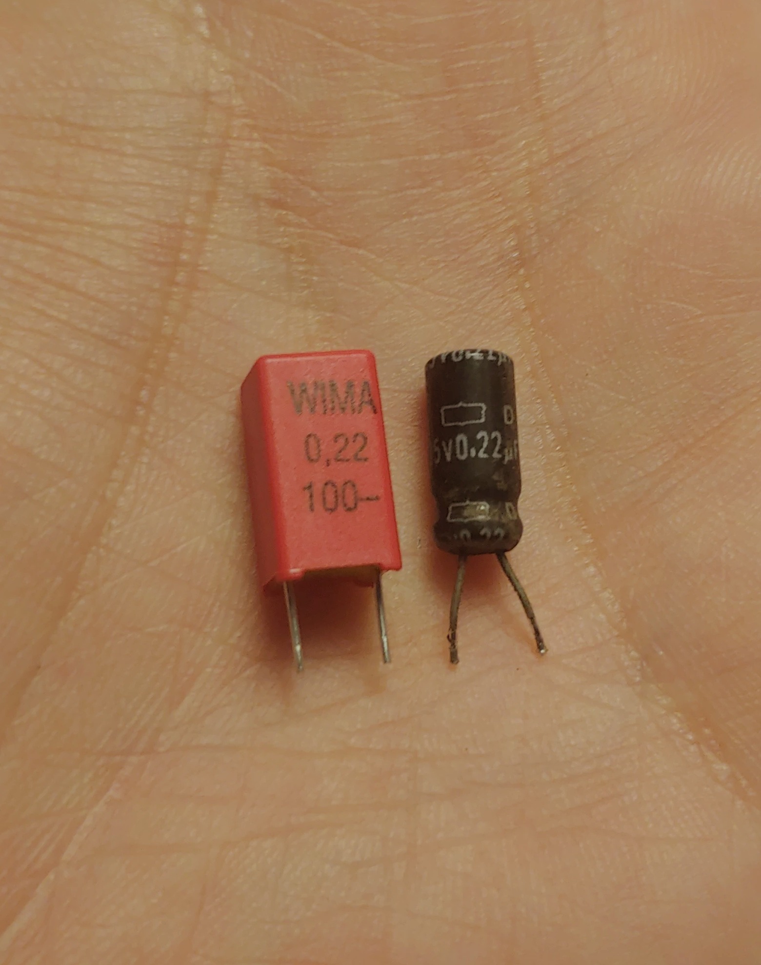

the 10uF from WIMA is massive for the capacity

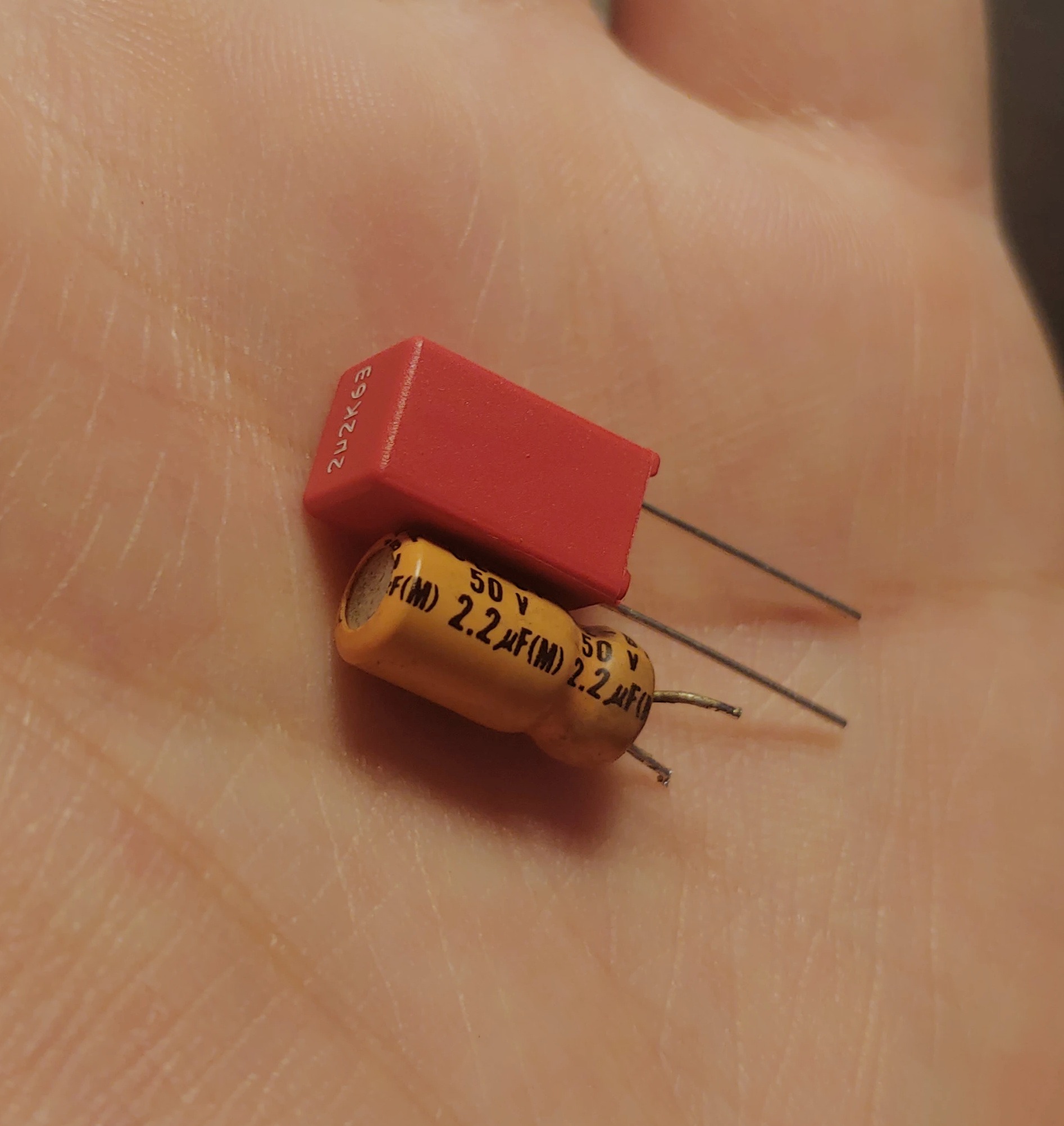

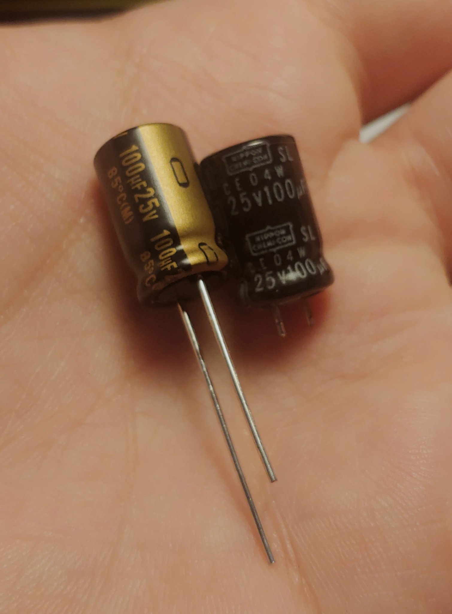

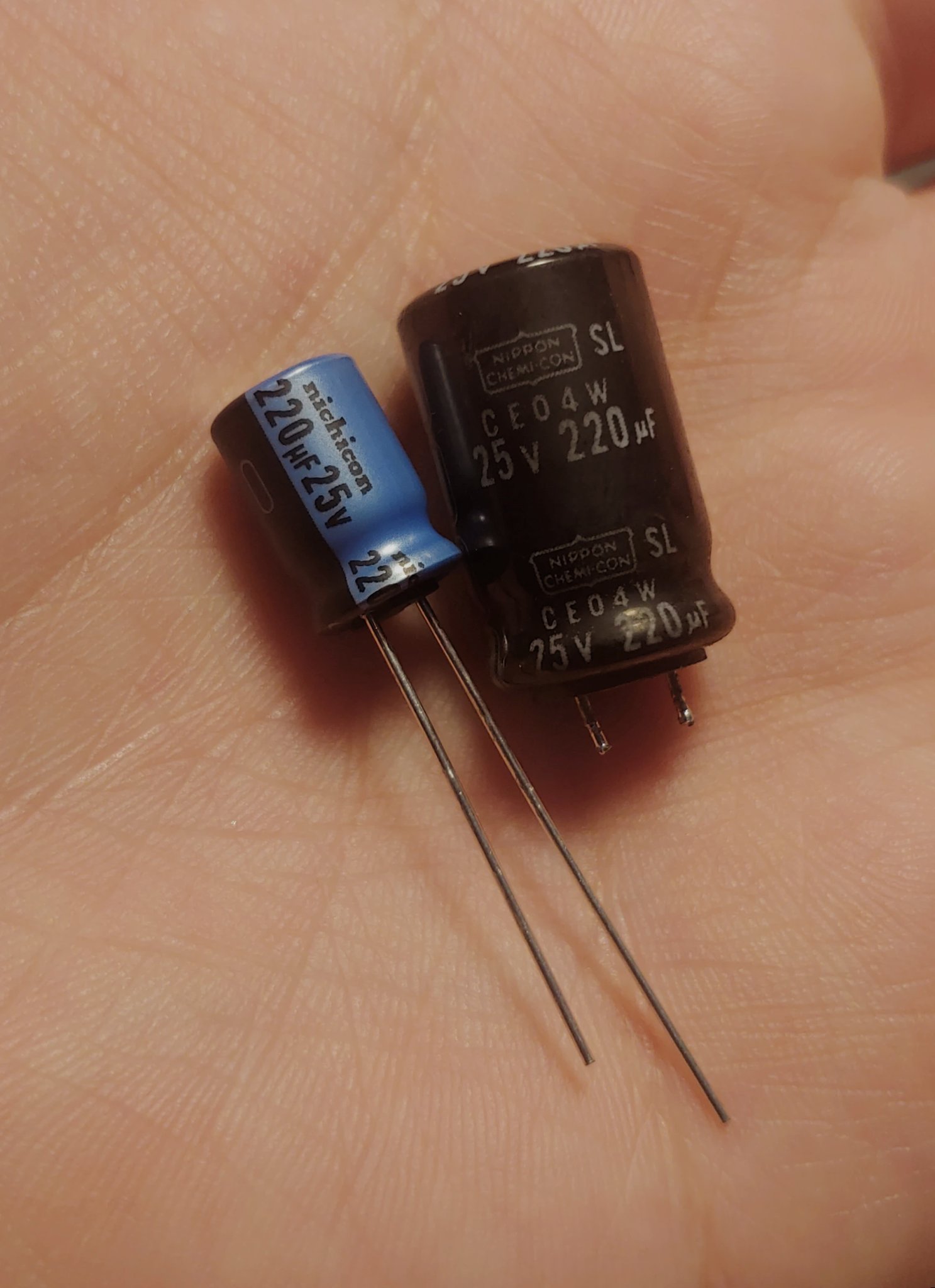

One of the not polarized caps
here the size difference is massive (it is like the filter cap smaller and also bigger)
The other not polarized capacitor
This was small, so I said why not
For caps smaller than 10uF, if space wasn't a limit on the board, I used WIMA polyester caps (MKS2/MKP2 series), instead for all the other I used the Nichicon caps audio series UFG/UKZ/UKA/LKS, I am a bit sad that the audio series of caps of this company is in end of life 🙁I considered using polypropylene caps, but they were too big, mainly they were 3x times the size compared to the polyester equivalents (space was a constraint)

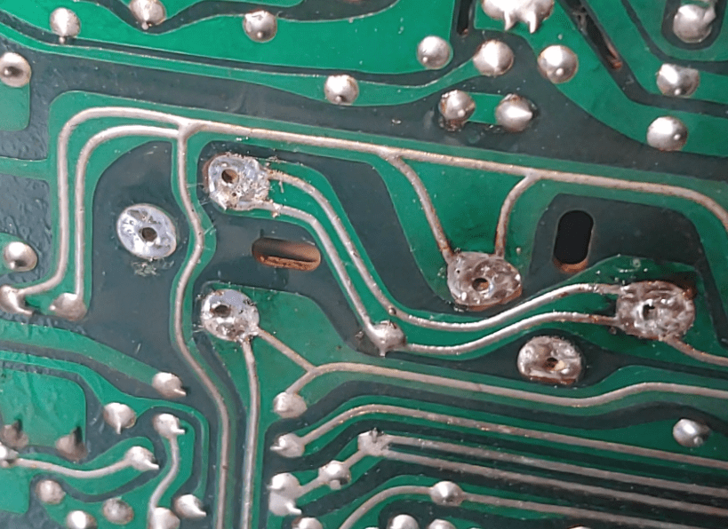

I also cleaned all the boards with 99% alcohol and now the PCB is so much better. Now I can see colors 🤣

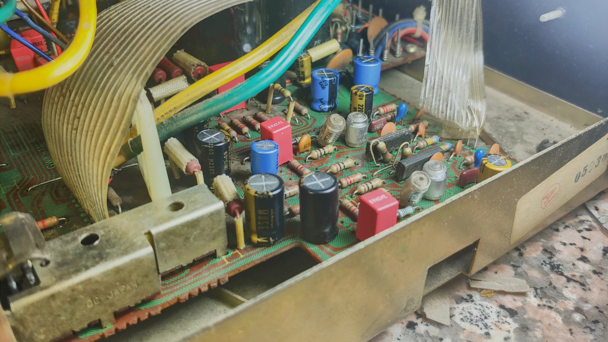

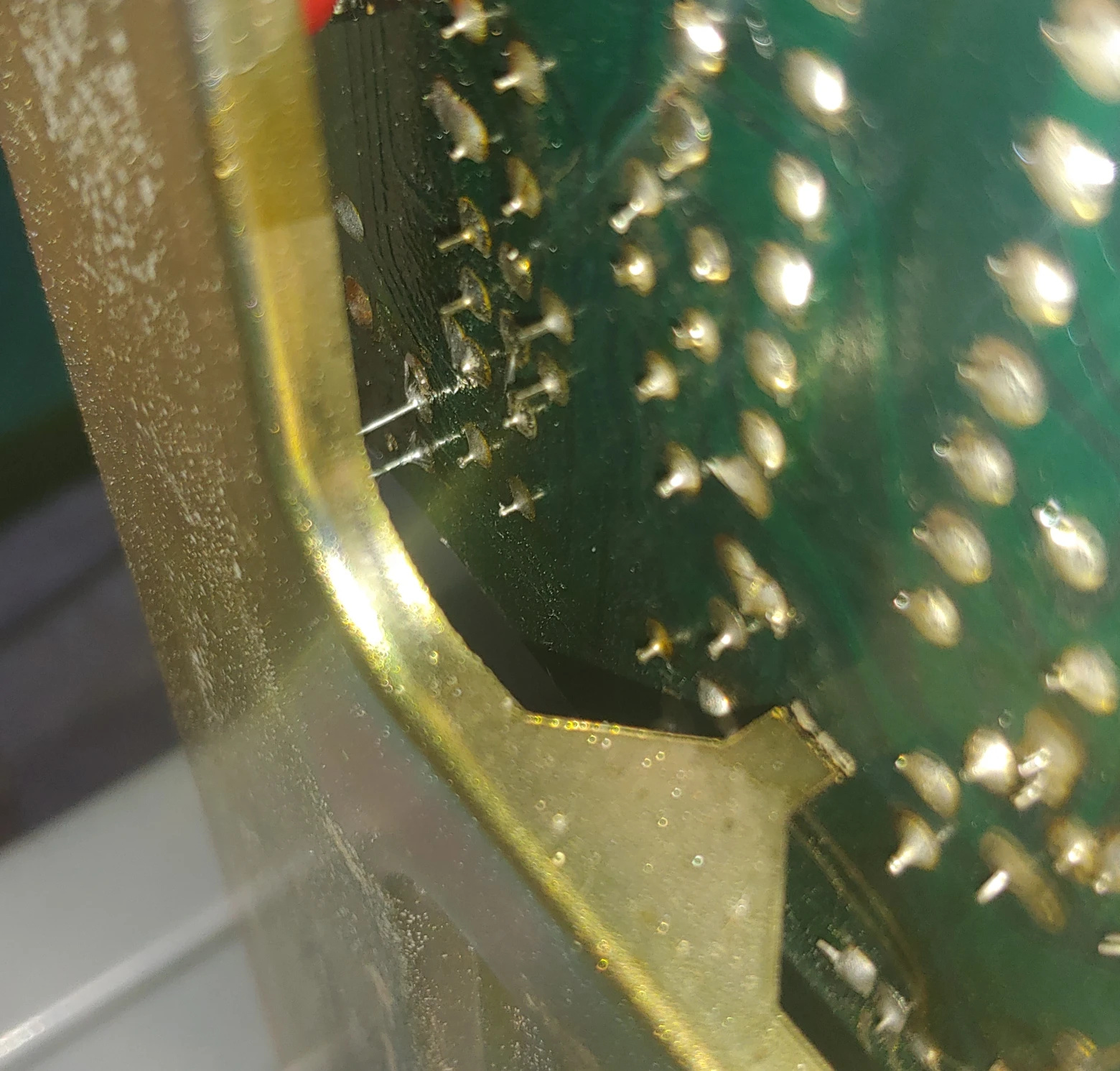

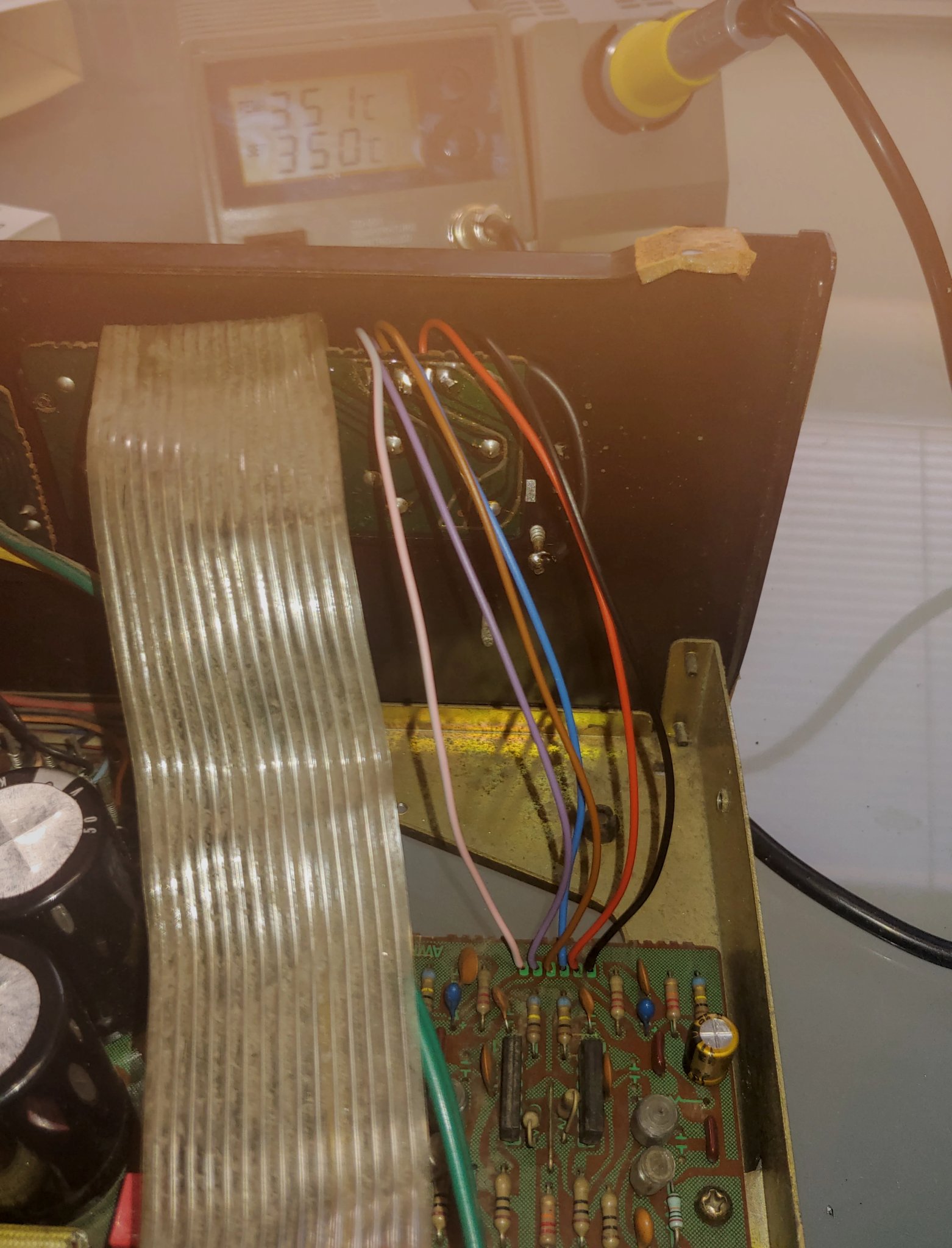

Look from the side, here you can see another problem that I found later (some audio inputs didn't work for this, read below)
The multiconductor flat cable that transports some inputs cracked when I was moving the cable to replace the caps, leaving the metal part of the cable visible...
(you can see it a bit better at the end of the YouTube video)
Do you know which cables could I use to replace these two cables? Something not flat would be better I think because you would see better the board without having to move the whole input section
Currently, the tuner inputs still work, so I'm OK!
Presently, just the 1-6 section cable appears damaged, the other one is a bit hard but still fine at this moment.

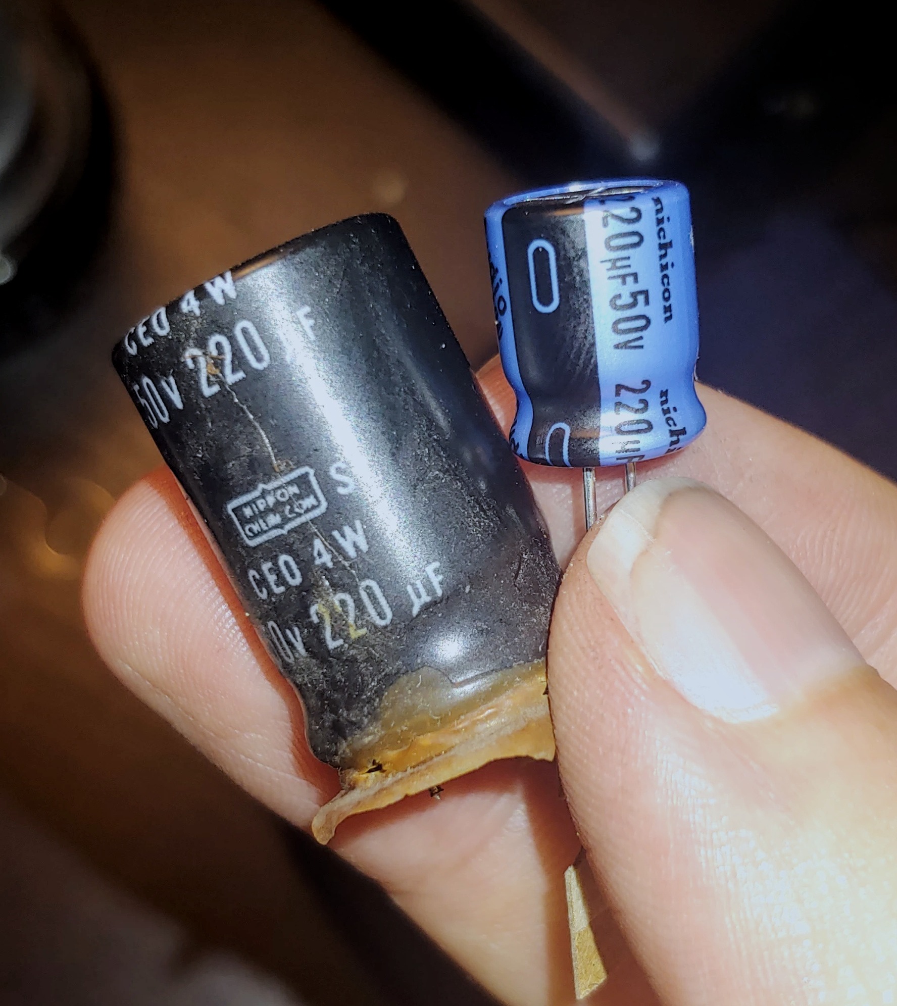

That brown stuff is glue holding the cap to the board. Was quite common. Its not the sign the cap leaked. It may have, that would leave white powdery stuff. If its light, it just dried.
Yes, believe me, I noticed that that thing was glue, I could feel it during the replacement of the capacitors xD
Man so, much, glue in those filter caps, even for the 220uF 50V. I had to bend a bit the board during the replacements.
The leaking happened in some smaller capacitors like the 470uF 16V or 100uF 25V if I recall correctly, I had to clean the PCB afterward because of the residue.

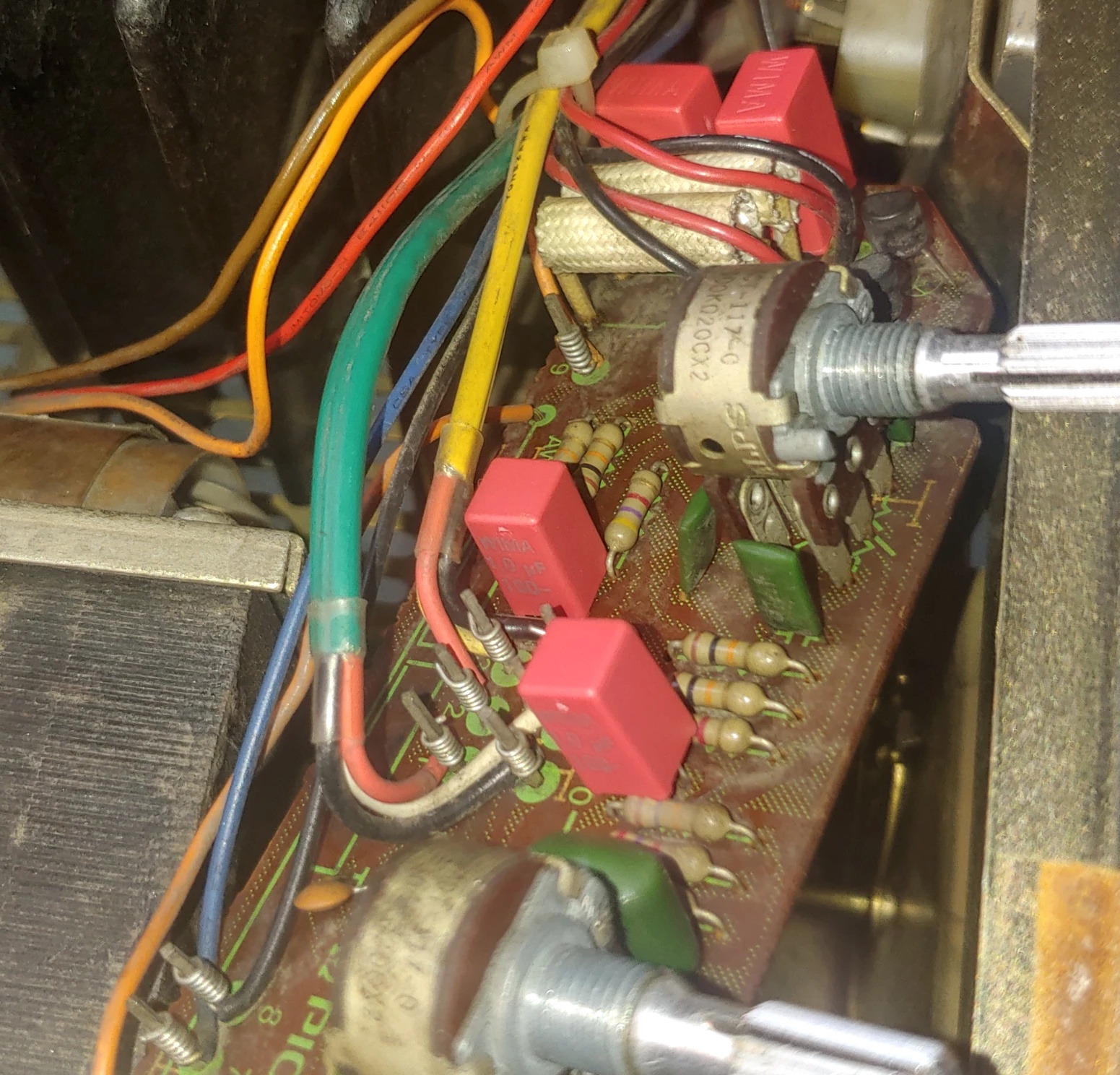

I've finally changed the two 1uF 50v with 2x WIMA caps:
Noted, they are a bit bigger than usual because the shop only had the 100V versions.

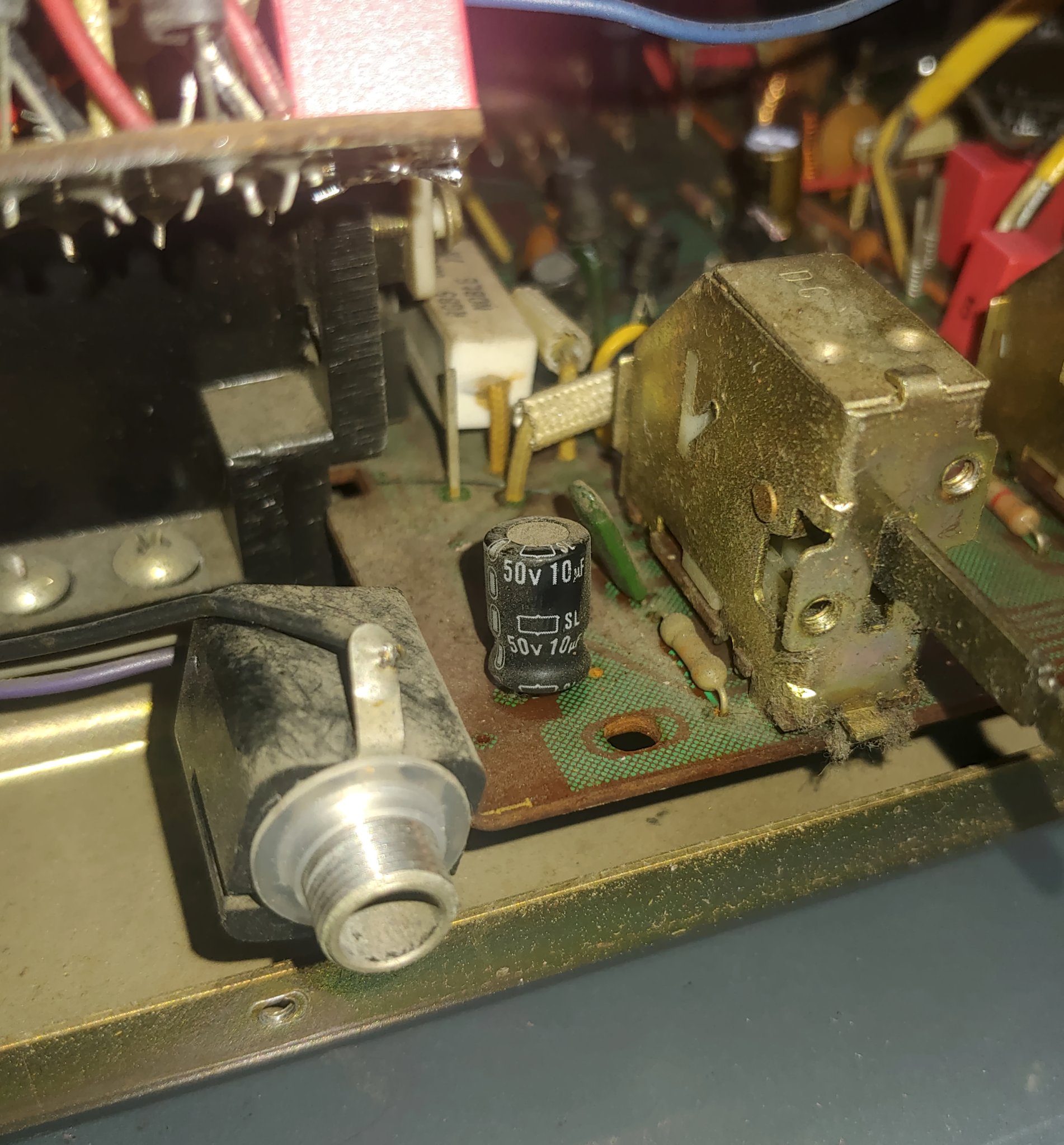

When I did this last replacement, I noticed that I missed a 10uF 50v electrolytic capacitor on the front of the amp,
it was a bit difficult to replace because I didn't have any space on the bottom enclosure of the case, and so I had to disassemble the front of the amp completely (shame that I don't have the photo of the part, just of the part replaced).
(this little one, with a bit of lever I could replace it)
(don't worry, I have cut the leads of the capacitor, it was an old photo during the process this one)

Then I also replaced the broken flat cable, but I don't know if it was really a 100% fix rate because now:
  • the Aux input work again
  • the Phono input has got a 50hz sound already at half volume (but 1-4 is fine), maybe because there is no input there, I can't really test it right now because my turntable is broken 😢
  • The Tuner input doesn't work, and before it did work, I reviewed the schematic, but I still can't figure out which cables are the problematic ones.
    It would probably be easy with a signal generator and an oscilloscope to resolve this problem but I don't have them, but I need a bit more debug
