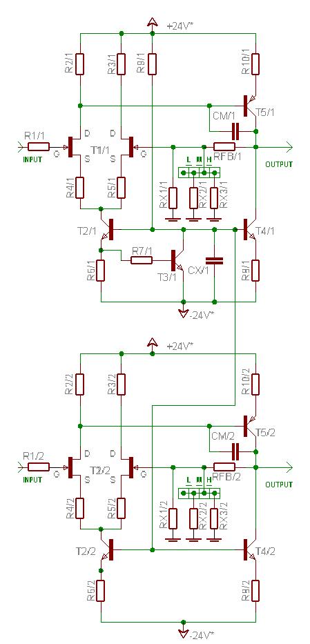

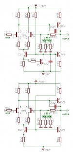

This JFET opamp circuit was developed in diyAudio threads as a clone of the circuit used in Nelson Pass Xovers. The Pass SuperSym amps favor +/- inputs, so an additional JFET opamp with single ended-input and dual ended outputs would need to be developed. LTSPICE schematics would allow team development and data comparison.

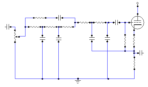

This is what I mean. The following circuit combines my driver resonance management, a notch filter, baffle/dipole compensation and a second order filter all in one for a flat mesured in room response to within +-2dB from 25Hz to two octaves above the crossover point (800Hz).
There is also a volume control and it does not affect the frequency response at any position in it's travel.

While it does not reduce the number of stages and spacing may be a hurdle, is it possible to use the stock Orion PCB and design small (maybe vertically oriented)adapter boards with a pair of these JFET opamps that would fit into the DIP footprint?LineSource said:This JFET opamp circuit was developed in diyAudio threads as a clone of the circuit used in Nelson Pass Xovers. The Pass SuperSym amps favor +/- inputs, so an additional JFET opamp with single ended-input and dual ended outputs would need to be developed. LTSPICE schematics would allow team development and data comparison.

I might add that I put my volume control where I did for unrelated reasons, and I only included it in this discussion to make a point about interactions.
To be perfectly honest, having played around with the my NaO circuits at length, and having built the Orion with both original and simplified active crossovers I don't think there is that much to be gained through this. As I said previously, it doesn't hurt the system to simplfy the circuits, but I'm not sure much was gained other than a cost reduction. And I would suggest that it is possible that a redesign could just as well take something away from the system.
If you want to improve on the performance of the Orion, maybe the ASP isn't really the place too look. Maybe you should look at the Orion overall and determine what its limitations are and then start with a clean sheet of paper addressing all those factors.
