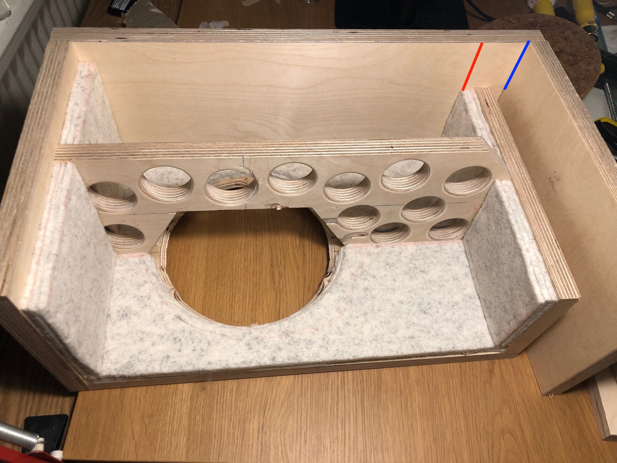

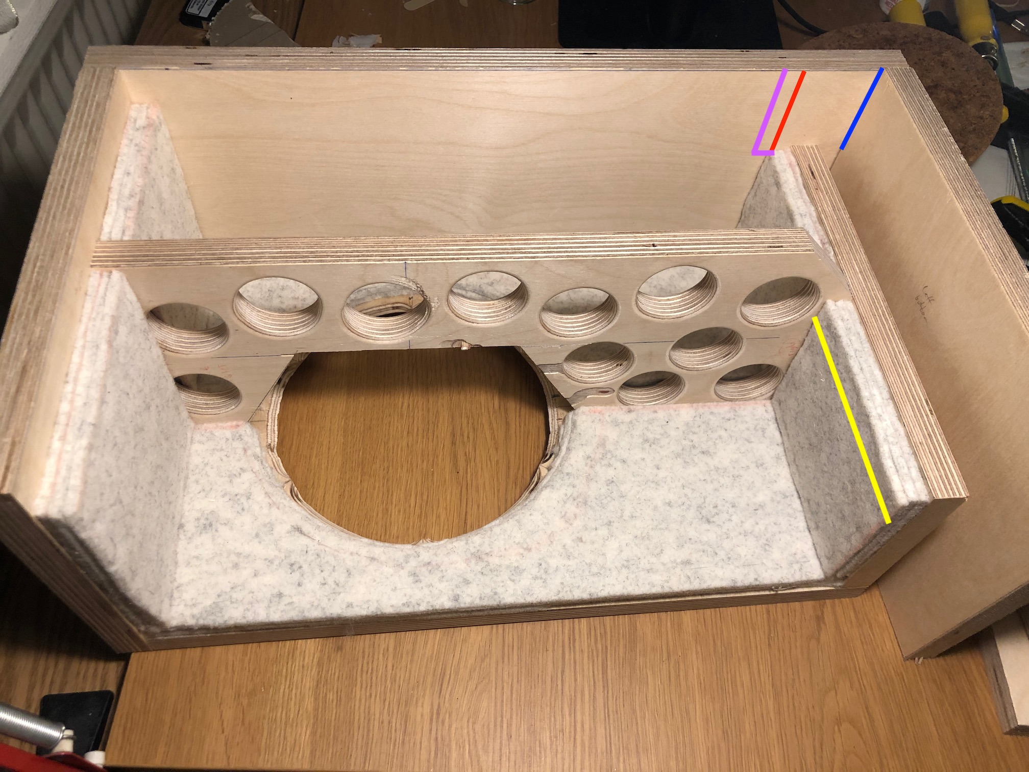

1. Is the positioning of the polyfill sheets inside the box OK (blue rectangles in the bellow picture)?
2. Should the side wall polyfill sheet follow the line of the brace (giving it a diagonal cut where it meets the vent - red line in the bellow picture)?
3. Should I cut the ployfill sheet at a diagonal angle aroud the driver, so it has room to breathe (yellow line in the bellow picture)?
4. Should I put a neoprene strip between the magnet and the barce for coupling?
5. Should I put a sheet of 1mm felt on both sides of the brace?
6. Can I move the connection plugs in one of the upper corners on the back wall?
Sorry for taking advantage and putting all these question, but this being my first build I want to make sure that I nail this project as you intended it.
Many thanks in advance,
Alex
