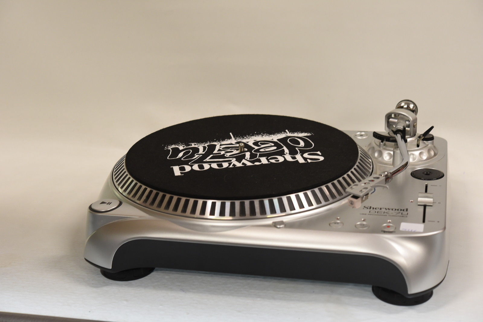

That's a very affordable candidate and I see it at higher asking prices! Certainly a modern style look though!I just bought a used Sherwood DEK-7U turntable in its origonal box for $80 about an hour ago, Ill see how it goes, my daughter likes the old style look though, she might like it?

My daughter loves it because of the USB plug to copy records to a USB stick as well as the great sound and looks. The TT came with an AT-3600 cartridge and stylus that was set as far out of tune as was possible! Once I set that right along with the track pressure and anti skate, the sound was just as good as any TT Ive heard. TTs are just like Tape Decks you can get a good high density pick-up head but if you dont set it up right it will sound like rubbish.
That budget AT3600 cartridge fights way above its weight and future stylus upgrades are possible.
For example, the ATN91R stylus has an aluminium alloy tube cantilever for improved resolution of detail and tracks well at a record friendly 2 grams.
I hope your daughter has a lot of fun with the deck.
