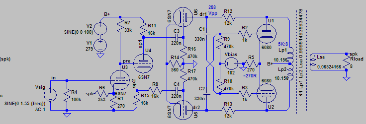

First, I have to admit this concept has actually not been build up to now, and sure needs a bit of polishing here and there.
The x-coupled inner feedback loop is part of the trick on how to equalize tube tolerances for stable performance.
It's not the simplest or cheapest effort, but should offer about 12~13W of clean and pure class A triode power.

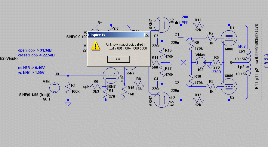

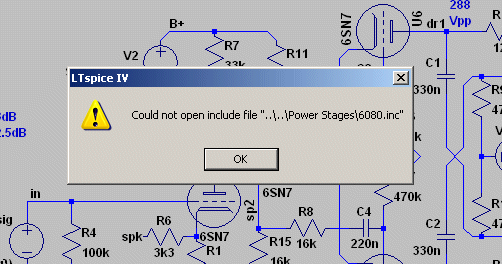

Need to remove all those folder directory and just use 6080.inc
Works fine.. It needs only 12Vpp on the driver stage. Looks like a good schematic to use op-amp phase splitter and save some heater power.

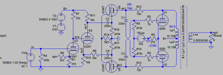

Hi, I've been messing around with Williamson driver circuits, so I have a question about yours.
I noticed that R12 and R13 are only 12k ohms each. Isn't that a very heavy load on the 6SN7's? I figure 6SN7 in a differential driver has ra of about 8k to 10k. Those 12k anode load resistors are not even twice the valve's ra. Won't distortion be very high in this stage?
Thanks for any insight into this you can offer.
...I have a design in my drawer which yields lower distortion with fewer parts and 100V less Ub...
The linearity of your output stage is "done" with common cathode resistor R5 (270 ohms).
This subject was discussed here in january:
http://www.diyaudio.com/forums/tubes-valves/284812-please-explain-h3-3rd-harmonic-cancellation.html
This sort of feedback is effective, but only in very limited load impedance range.
This can clearly be seen when your circuit is simulated with different load resistances.
As a reference the THD is only 0,14 % with 11 W to 8 ohms, but the performance collapses with 4 ohms.
With only 6,5 W to 4 ohms, the THD is some 16 times bigger, i.e. 2,2 %.
With 6 W to 16 ohms it is better (0,56%), but the increase of the THD is conciderable.
In january when the original thread appeared I tested the effect of this cathode feedback in my 6N13S PP amplifier.
I noticed that very little improvement to the overall linearity can be achieved with the common cathode resistor, and the optimum size of the cathode resistor may not be (with 6AS7G etc.) bigger than some 30...40 ohms.
If the common cathode resistor were optimized to 8 ohms, the linearity with 4 and 16 ohms load was worse than without the resistor and vice versa.
...I noticed that R12 and R13 are only 12k ohms each. Isn't that a very heavy load on the 6SN7's?
The AC-load of the 6SN7 is much higher than 12k ohms. Actually it is more than 100k ohms.
The upper end of the R12 and R13 are connected to the opposite side anodes of the output tubes.
Therefore the phase of the signal voltage at both ends of these resistors is same and anodes of 6SN7 "see" R12 and R13 as much bigger impedances as their real value is.
In part, yes, but only to a smaller fraction. An even larger part of the H3 is cancelled by the x-coupled positive feedback around the final and driver stages.
This behaviour is pretty normal with tube amps in general. It is also observed with your posted schematic and simulation files. Especially with lower than nominal loads. Why would anyone use 8 ohm outputs with 4 ohm loads??
Please also note that my circuit also uses less overall GNFB, so behaviour at less than optimum loads is expected to be worse. Strangely enough, my circuit keeps better power balance at varying loads than yours, even with less effective GNFB...
rgds,
GR
This is not a conventional differential driver stage. Its (kind of) bootstrapped by the output tubes' plate signal. Effectively, the plate load is "more than infinte", leading to upward(!) slanted load lines on the 6SN7 drivers. This has 3 effects:
1. it allows the driver stage to swing with >290Vpp with only 280V B+
2. it inverts the H3 of the driver, which partially cancels the H3 of the outputs.
3. It linearizes the driver stage.
It also allows more gnfb, which in turn further reduces the overall distortions.
