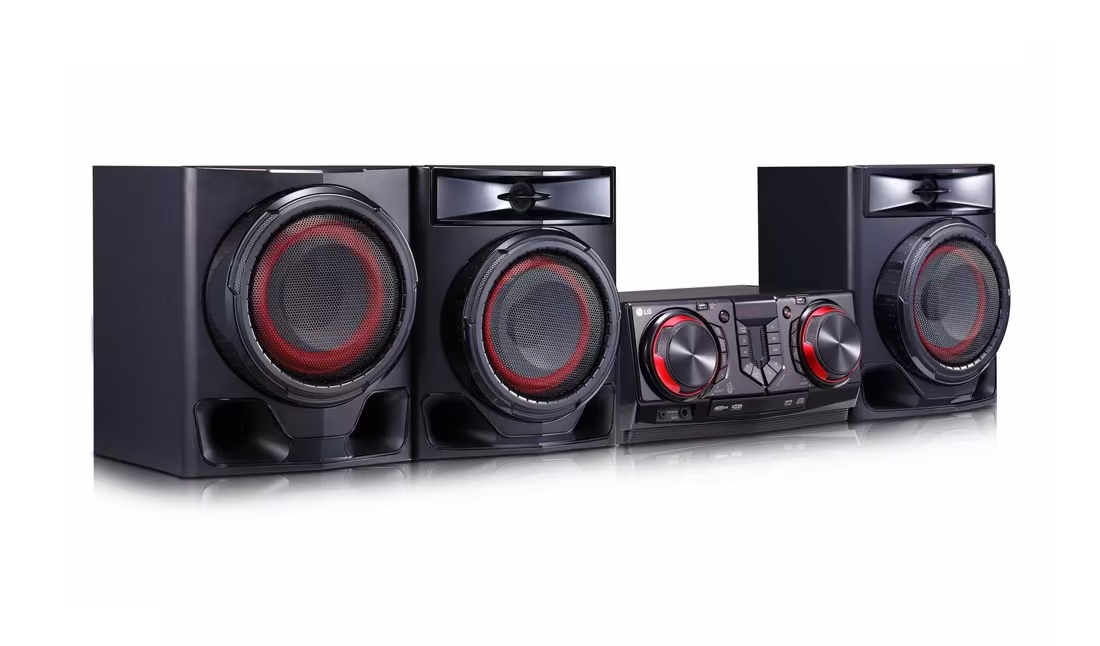

Hello! I need a little help, currently, I have the LG Xboom CJ45, which is great for what I need but looks awful in my front room.
I want to mount my speakers to the wall and decided a bookshelf design is the best option for this along with the sub, the sub isn't an issue as its well hidden but the speakers need to look a bit better and smaller for the look to go so I decided that just rebuilding it is the best option!
I could use the internals of the LG Xboom as it does what I need it to and it means I have Bluetooth and can remove the cd drive which I've never used anyway so that's an idea.
But the speakers are the part where I am stuck, the LG Xboom has large speakers, too large and I wondered if putting the drivers into a smaller box may impede it in a way that may sound awful, it might just be easier to buy some new drivers and build the new box so I guess I'm looking for advice on this!
So, in a nutshell - what should I be looking at when building a new speaker box that is a bookshelf design that doesn't need to have any sub duties 😀

I don't know what they're referring to when they say "main speaker," but front speaker says 10.5" x 12.4" x 9.2" with 6.5 inch woofers. that's not that big by hi-fi standards, but obviously there are much smaller satellite speakers out there. You can certainly rearrange the parts you have to make something more attractive. You could probably lose the ports on the left and right speakers also. You can stuff the ports temporarily with some socks, a piece of squishy foam, whatever, to see if that makes much difference to the sound.
How small are you wanting to go for the left and right speakers?

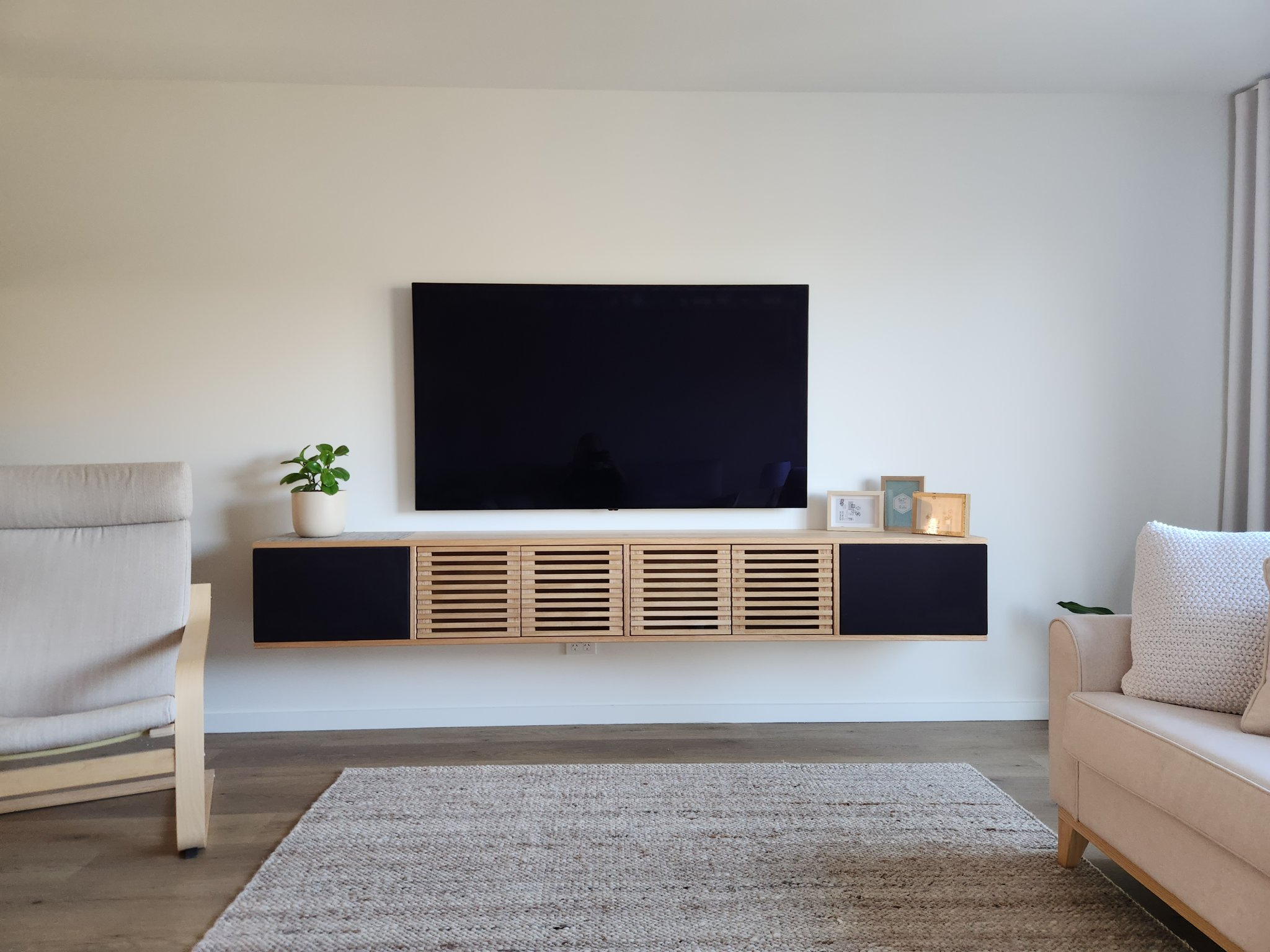

You can hide quite a bit in something like an entertainment center and make it match your decor since it sounds like you have woodworking experience. This one is by @cowanaudio

So the main part will probably be hidden inside the media center setup I have yes, along with the sub.

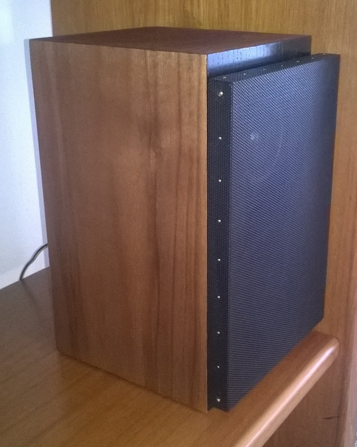

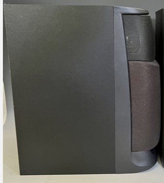

@bamfukrazer , as I understand you want to keep the sound of your system, but do not like the looks of it, right?
Option RECOMMENDED: cover them in some kind of fake box, or something like #4 post. Screen of thin cloth will not ruin your sound. No, it will not save you space, as the "external" box will be bigger than your system.
Option two: measure internal volume (not sound volume, but volume in cubic meters or cubic feet) of all three boxes, measure the diameter AND length of ports in all three boxes, remake the boxes of smaller size, but with the same or similar port tuning. In that way you can "save" up to 20-30% of volume, but not more, and some more space with clever dimension picking, like make it shallow with the additional width and height etc. And you have to keep or re-make waveguide for tweeter, but remaking will not be easy. Also you need to understand how bassreflex works and re-calculate for the new box. This task is not for novice cabinet builder, but still nothing out of extraordinary. I suggest do not touch the head of the system.
Option three: keep the head of the system and build 1 subwoofer and 2 satellite speakers from scratch with new drivers. That is risky, because we don't know if the new speakers will match the current head of the system as this is a system designed to be used as one and probably the signal coming out of the head is DSP/EQ corrected to the exact speakers and we (you) have no idea how it is corrected. It may NOT be DSP/EQ corrected - this option is worth to consider.
Option four: change the system to the one that fits you better
