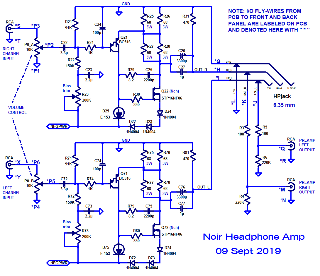

  • Two RCA outputs- one to go to the Pass amp and another pair that will go to a powered subwoofer (ideally after the volume attenuation)
My question is in regards to splitting the audio signal in this setup.
I have been trying to research a few different scenarios for accomplishing this:
A) tap the volume pot, isolate and buffer the split signal in some kind of simple opamp buffer. I tried searching for a pcb board that would make this possible and I found this buffer board https://phonoclone.com/diy-bb.html - it doesn't seem to be in production but I may have some luck contacting RJM directly. I imagine I would have to split the line from the volume pot to a board like this and also to the gain stage.
B) tap the output of the gain stage and add 100R and 220kR resistors to isolate the second output, like the Noir headphone amp
C) have one output RCA and use a y-splitter... I am skeptical of this solution, but I'm a dummy when it comes to all of this right now and I would not want to over-engineer a solution
Any comments on the project as well as how to go about the dual output is appreciated, thank you in advance!

B
