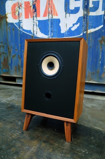

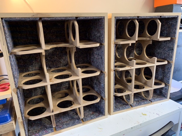

Here’s a pic of where I’m up to so far and the speakers that I’m drawing inspiration from, the Fern & Roby Ravens

what's the vent length and power rating of your amplifier? With 62 liters and a 10cm long by 52mm diameter vent, hornresp (2 pi, 2.83v, Rg = 0) indicates Fb ~28.5Hz and small signal F6 around 31Hz. With this low tuning, FA22's 3mm one-way Xmax will be hit with ~3 watts input at 44Hz. Maximum port velocity with 3 watts input occurs around 20Hz at ~14 meters per second. There really won't be anything useful at that frequency and rarely if ever excited unless by turntable rumble and record warp - which should be highpass filtered anyhow.
If the vent is shortened to obtain Fb close to 46Hz, hornresp says 1.8cm length (typical wall thickness) will tune ~43,5Hz and the response now has a 5dB peak around 55Hz.
Perhaps other programs are more accurate with vent length than hornresp ?
Anyhow, SEAS application notes recommend 70 liters tuned to 33Hz for vented box (QB3 alignment) and 60 liters closed. It looks like a wonderful driver.
