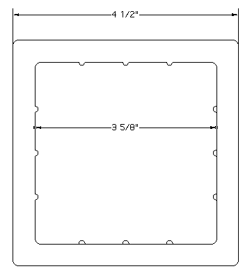

I'm constructing a small set of speakers with a 3" fullrange driver. Design goals are as follows:
Floorstanding full range with very small footprint, easy to construct. Paired with a sub, active hi-pass filter.
I started out intending to clone Zaph's Hi-Vi project linked here: http://www.zaphaudio.com/audio-speaker18.html
Then I found an interesting material at the home store: a composite decking corner post, 4.5" by 4.5" by 42" long, hollow in the center, with 3/16" thick walls. The material is molded in one piece. Knocking on the sides produces pipe-like resonance, but the walls themselves sound fairly dead like MDF or particle board.
This material is attractive for a number of reasons. 42" is an ideal height. Construction should be simple, cutting a driver hole and fastening on end caps. The narrow width fits perfectly where the speakers need to live. The total volume inside the column is more than a traditional dimensioned box sized to sit in the same small place.
This raises a number of design questions, as to what alignment to use:
1. Clone Zaph's design parameters, a volume of about 0.12 cu ft, by plugging the middle of the column. Or filling it with sand (in a bag) so I can play with different volumes later.
2. Keeping a sealed alignment, cap both ends for a total volume of .32 cu ft, stuffing the bottom of the enclosure to try and kill any paper-towel-tube reverberations.
3. Something more interesting. This is what I'd like to know: what novel alignments could I get out of this long, slender enclosure? Open it up at the bottom and let the whole pipe resonate? Try wedging a baffle inside for a mini- QWTL? Bipole? The cyburgs-needle enclosure really piqued my interest, but alas the box is too deep, and the construction process too involved for my small apartment.
4. Is this a bad idea? Will the long narrow enclosure sound boomy, with no way to fix it? Should I stick with a traditional box?
The full-range thing has really got me back into diy. The simplicity of a single driver appeals to me. If I have any sucess with this, I'll probably investigate other drivers, Aura, TB W3-871, fostex. I spend a lot of time working from home, and realized I rarely use the big stereo, but spend my time in the kitchen with the laptop, listening to this all day:

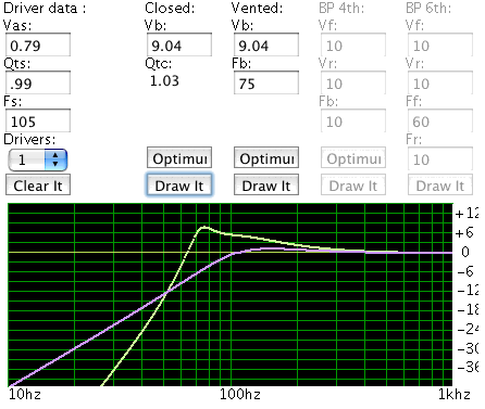

1. I plugged the volume and port tuning data into ISD and I got a graph with a big bump at 75hz. Now I know that the simulation is primitive, especially for a driver this small and a TL type alignment, but it still concerns me. Should I be concerned? The graph is pasted in below.
2. The enclosure is so narrow that it could easily be used as a port itself (for a ginormous subwoofer box). Total cross sectional area is the same as a 4" diameter tube. In an enclosure that is a tube itself, whose close-pipe resonance and port tuning frequency are about the same (as best I can simulate) what is the purpose of the smaller port? Does it filter out higher-harmonic resonances of the line?
3. Why place the driver 6" from the top of the enclosure? Does the line resonate differently with the driver at the end? Should I calculate the harmonic null points to place/not place the driver at one of them (all these questions start me liking the sealed alignment again)? This is one area where I cannot experiment, once I cut the hole that's where it is.
So now I'm considering three alignments: sealed, TL with taper insert, and open TL with a port. I'd love to get it down to two, so I can build one of each and do a side by side test.
-Sol

Box programs assumes a uniform particle density (no wave motion), so the vent would need to be somewhat longer to get the same Fb as the pipe, though the sim will still be off a bit. You'll need to sim it in MJK's ML-TQWT MathCad worksheet to see the results. If it performs as simmed, I believe you will be pleased, and yes, if it had the response you posted I wouldn't recommend it.
Yes, the vent mass loads it for smoother performance.
Yes, pipe performance can be tuned somewhat by the position of the driver and/or vent. Ideally, the driver should be where it damps the 3rd harmonic, or ~12.606" down in this design, but this puts it too far below a typical ear height, so chose 6" as an acceptable alternative when combined with vent slot loading.
Anyway, if it performs remotely like it sims, it will 'blow the doors off' the sealed cab, with solid output to 50 Hz, and the folded pipe doesn't have enough Vb for its length, so for me it's a no-brainer.
As always though, YMMV.
GM

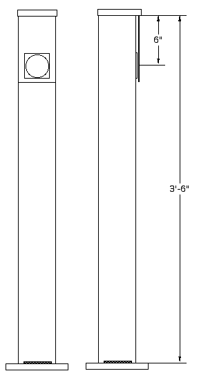

Hi all,
Thanks for the advice. I just ordered the drivers, crossover components, etc. from Madisound. Now I have to cook up a little shopping list from DigiKey for the high-pass filter.
I'm going to try the sealed alignment and GM's straight tube with a 1.5" by 1.5" downfiring port.

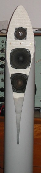

Well Sol I'll give you a little incentive. The reason I asked about yours was that I found the same composit posts and had to try them out. I'v been playing with them for a couple months now and have got them sounding darn good IMHO. Mine are small TL's for my computer three speakers a side, this composit works great it's stable easy to cut and dosent look bad in the raw like MDF.I'v a combo of fostex & aurasound speakers and when I hit the right set up (don't know how to computer model yet) they come to life to where I can sit and listen to them for hours even at ony three to four feet or move back and turn them up and fill the room (10x10) so don't give up I think if you can find the time you'll like the results.:skull: :Pirate:
