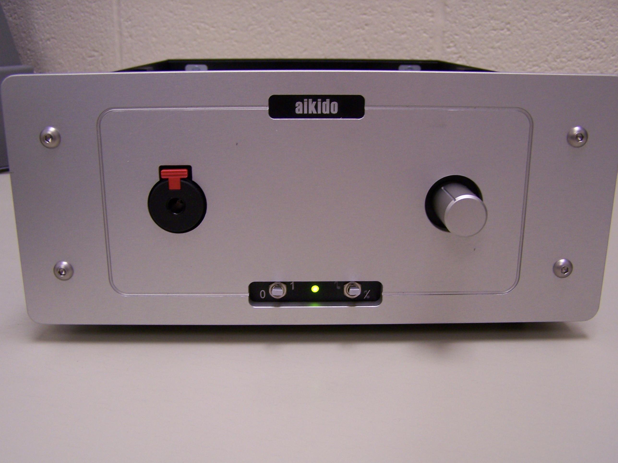

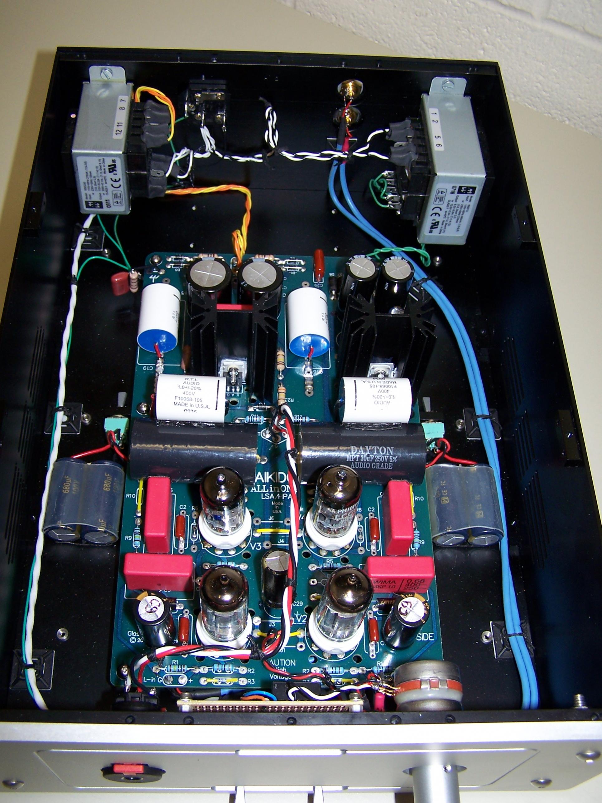

About four years ago I built one of John Broskie’s (the brains behind Tubecad Journal [www.tubecad.com]) Aikido headphone amps. I chose the All-In-One HPA/LSA (amp and power supply on one board) that has both regulated filament and B+ and uses 9 pin tubes for the amplifier. This board is no longer available but the equivalent can be made by pairing one of Broskie's PS-1 power supply kits with either a stereo amplifier kit or two mono kits.

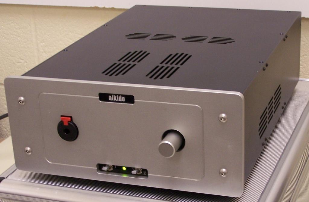

At the time (pre-retirement) I had access to a tool and die shop and with help of some of the greatest guys (thanks Paul and crew) was able to make some decent metal work and have it anodized by another great crew (thanks Alex and gang).
You can see from the pictures I was trying to make it look vaguely like my ARC gear. The switches either side of the PCB are to switch in the nearby caps for low impedance ‘phones.
The version I built uses 6CG7 input tubes (the 9 pin equivalent to the octal 6SN7) and 6DJ8 outputs. The B+ is set to 150 volts.

Cranky Mullards, a cautionary tale:
I first wired the filament supply in the Aikido to provide 12 volts and the output tubes (6DJ8s) were wired in series. I switched it on once and one of the output tubes got very bright, very fast. I switched off quickly and found that the other Mullard had a shorted filament that almost took out its neighbour. Yikes! I rewired the filament supply for 6 volts and connected the tubes in parallel. The filament rectifier diodes started running hot so I replaced them with TO-220 cased diodes with heat sinks. The 6CG7s were also rewired in parallel.
I was monitoring the cathode current of a Mullard during start-up another time, normally about 10mA (1 volt across the 100 ohm cathode resistor) when the current draw started to rise above 15 mA. I quickly switched off before the tube went super-nova and took more of the circuit with it.
That was two of my six treasured Mullards down the drain. If you can get these tubes don’t pay big bucks for them (I didn’t) as they might break your heart.
