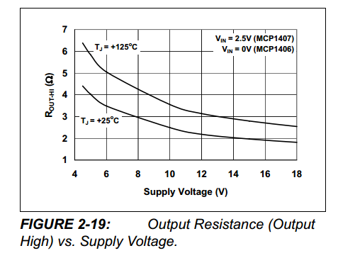

As for the MCP1407 getting "exponentially" worse when supply voltage decreases: the datasheet does not seem to agree. Here's a figure. Enthusiastic, energetic researchers can of course enter this data into a spreadsheet, fit a variety of linear and nonlinear trendlines, then extrapolate the best-fit equation to Vcc = 3.25 or thereabouts. And/or the data in other datasheet figures. If it is important.

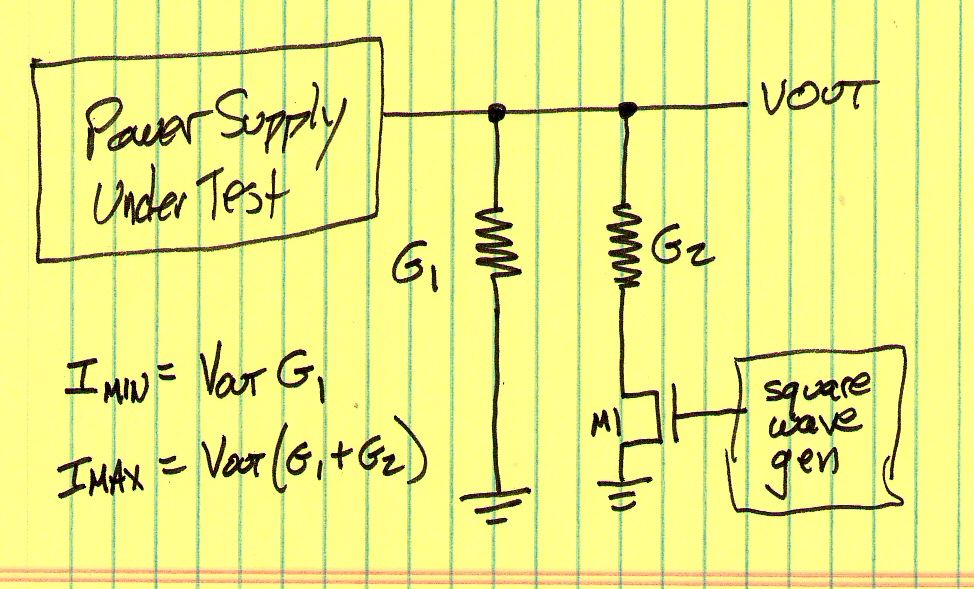

ok thanks. Mark's circuit flicks between no load (no current) and a given load. One that changes the load (for say, 1A to 1.1A analysis) would require some changes or perhaps simply having the variable resistance component connected across J4 and J2.
Of course you could make a fancy electronic load able to generate load steps and DC current, which would probably be a circuit with an opamp driving a transistor, and then when you observe something on the scope like settling time or slew rate, you never know if it is the regulator, or the electronic load, that you are measuring.
A dumb fast MOSFET switch and a dumb resistor is best. For DC current, a bunch of resistors and switches (or pin heaers or whatever) is alright, simple, works, and can't introduce anomalies in your measurement.
If you add a second resistor you can make the load current switch between Imin and Imax.A dumb fast MOSFET switch and a dumb resistor is best.
The math is slightly more convenient if you treat the resistors as conductances (G = 1/R) where the unit of conductance is the Siemens. Conductors in parallel are easy to compute.
When G1 > 0 (namely when the grounded resistor R1 is less than Infinity), the minimum current Imin is greater than zero ohms. When the MOSFET is off, some current still flows thru G1.

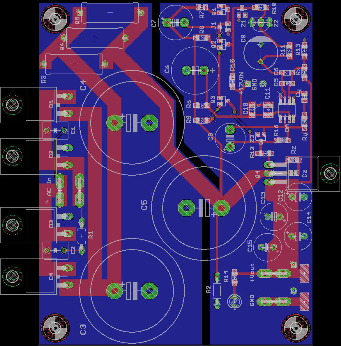

I was about to do the silk screens and send the boards of when I wondered if it made sense for there to be a capacitor at the 12V input for the 5V and 3V3 boards. Any view?
I have also rotated the board to fit better on the heat sink sidewalls. It also places the heat dissipating pass transistor more centrally on the heat sink. I've been busy working on the enclosure as well.

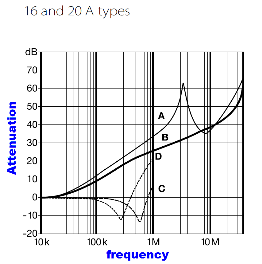

I just measured an Antek AS-3218 screened transformer that I had lying around (link)
Primary-to-screen = 275pF
Secondary-to-screen = 240pF
Screen wire = 22AWG stranded, 12.5 inches from tip to core
I measured a piece of 22AWG wire, 12.5 inches long. The meter reported 350nH which agrees pretty well with theoretical calculations (380nH). Measured resistance was zero; theoretical calculations say 0.015 ohms.
Plug the above numerical values into Andrew's slightly goofy filter topology (in my opinion he's got Neutral and Earth reversed*, but use it anyway), crank some Laplace analysis, and you'll find that the corner frequency, where the screen begins losing effectiveness, moves down by a whimpering 3.4X when you cut the external screen wire length from 12.5 inches to 1 inch. This result makes intuitive sense; corner frequency is proportional to 1/sqrt(L) and the square root of (12.5 inches divided by 1.0 inches) is 3.5. I don't think a shift of half-a-decade of frequency is anything to lose sleep over. Whether the filter corner is at 1MHz or 3.4 MHz is not crucially important.
There is some good news: the upstream IEC inlet filter attenuation is getting better and better as frequency goes up, datasheet plot below. Shift the plot left-or-right by a half decade of frequency; it's still got loads of attenuation. The transformer screen attenuates primary-to-secondary noise injection by ~ 75dB or more below 100kHz. The IEC inlet filter kicks in and attenuates at higher frequency. Synergy!
A second piece of good news is that inexpensive ferrite beads can be sprinkled downstream if desired, giving mind boggling amounts of attenuation for those who lay awake at night worrying about 100 MHz mains-borne noise getting to the input terminal of their voltage regulator.
