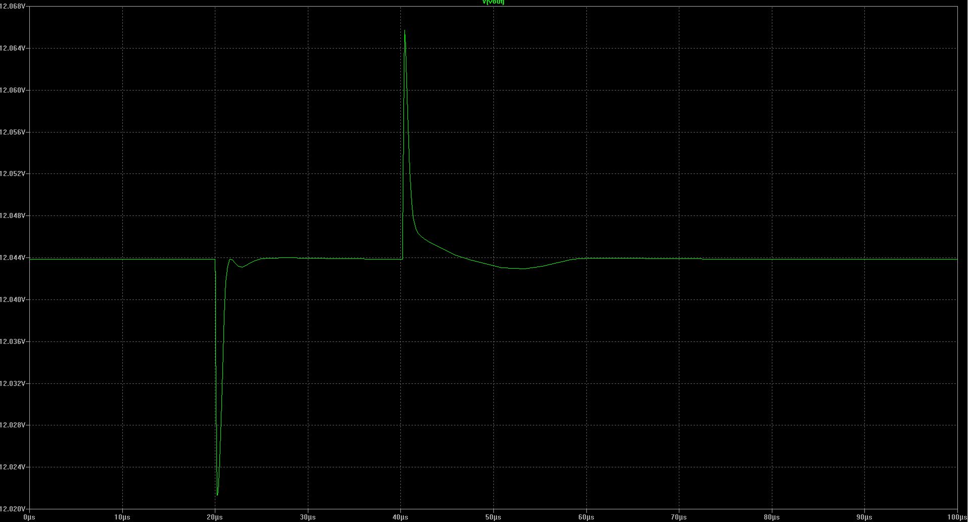

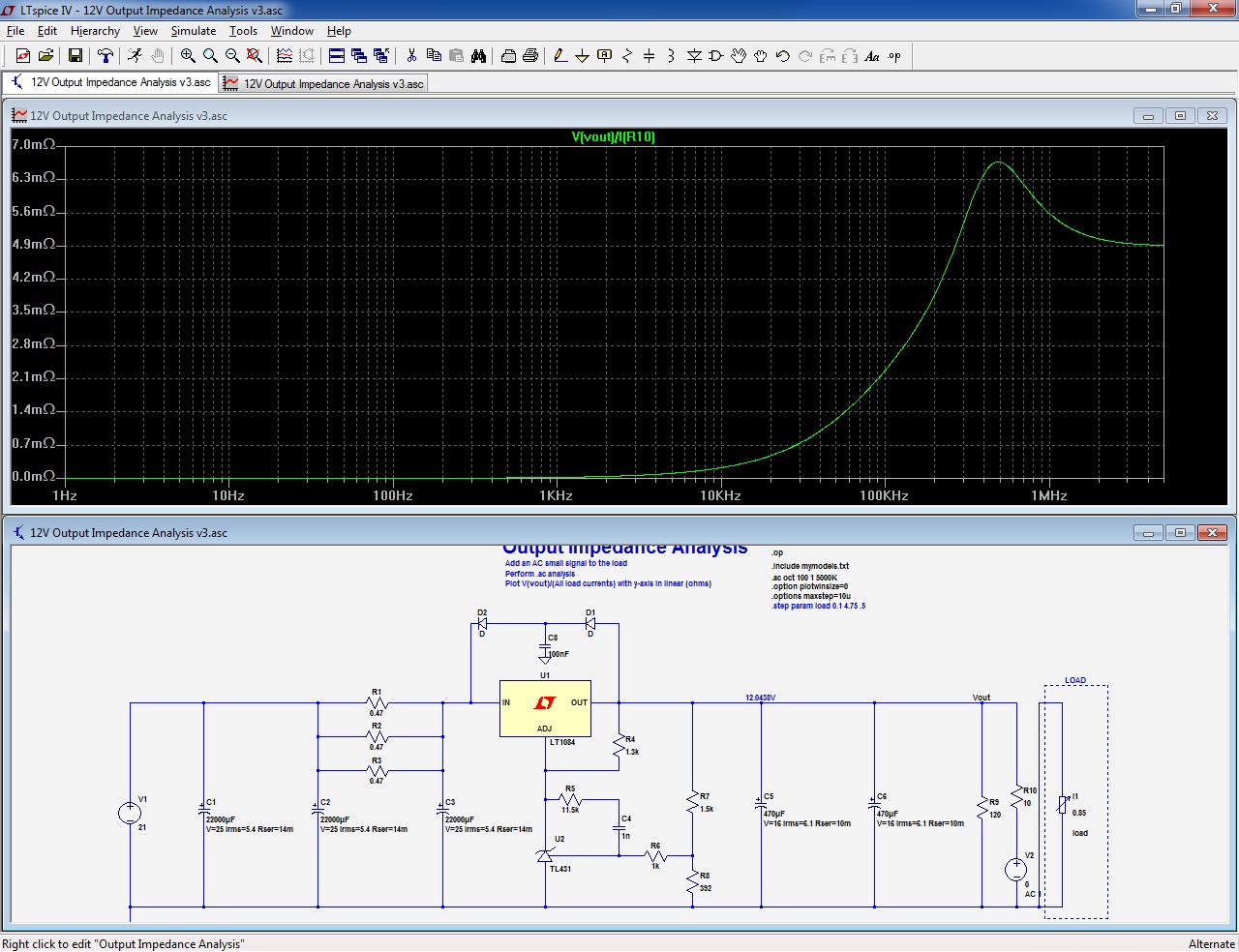

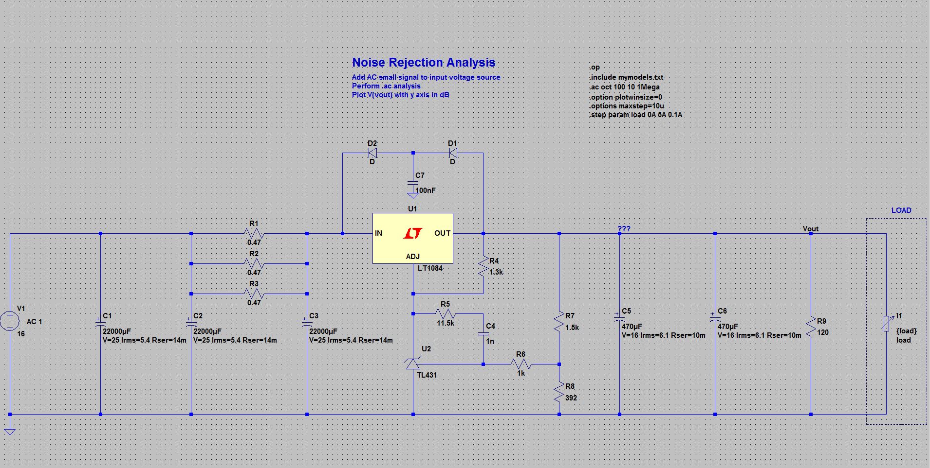

As some of you know I have been embroiled in a project to construct a linear power supply with three regulated rails with output voltages of 12V, 5V and 3.3V respectively. The circuit involves combining a TL431 (or rather it's newer, lower noise, cousin the SPX431AN) with an LT1084. I started with the 5V rail then looked at 3V3 and lastly 12V. Each required slightly different tweaking to the RCR filter that skirts around the TL431 but in essence the circuit is the same. I've attached an image of the LTspice simulation circuit for the 12V rail below (12V) along with its modeled noise rejection (12VNR) and transient response (12VTR) for a step in load from 0.25A to 4.75A.

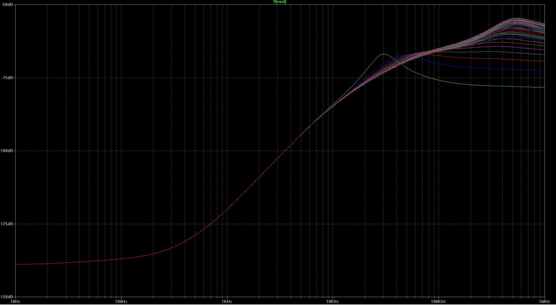

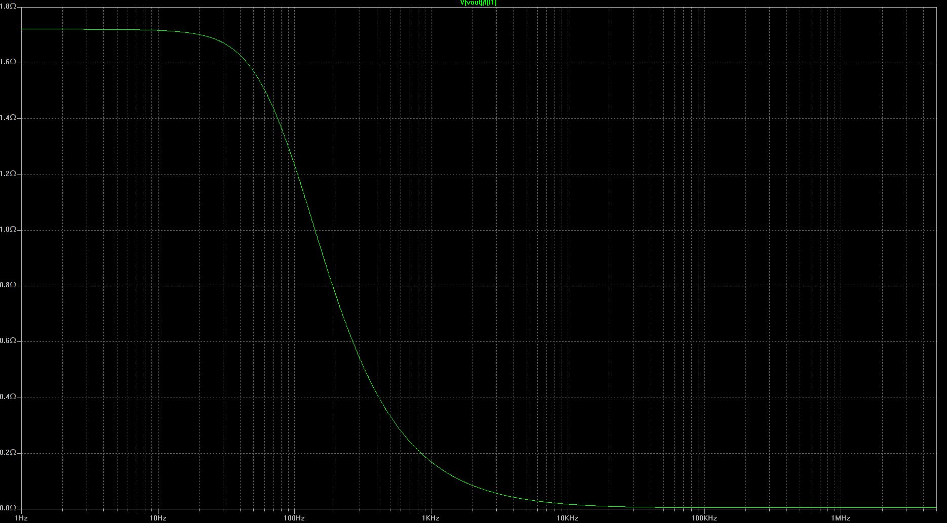

I am very puzzled by the output impedance analysis of this circuit. For loads less than 0.8A I get 'normal' looking output similar to the 5V and 3.3V rails. (That is, zero impedance rising to a peak of 6.3mOhms around 446kHz and then declining.) From a load of 0.85A and beyond I get the output in the image below (12VOZ). I'm baffled as to why and would appreciate any input people may have.
Also, I have a model of all the rails connected to the secondaries of their transformers in turn coupled through a soft start circuit to the mains. One odd thing I encountered with this larger model was that when I added caps to reflect the load capacitance each voltage rail needs to be able to service, the voltage rails produced saw tooth output until I added a very small amount of series resistance to the caps. Of course the load capacitance will have series resistance and likely a lot more than was needed to settle the sim, nonetheless I would be interested in an explanation as to why the addition of a small amount of ESR was needed to settle the voltages rails back to their behaviour prior to adding the load capacitance (or, rather, why adding capacitance with no ESR unsettled the rails).
Cheers
Steve

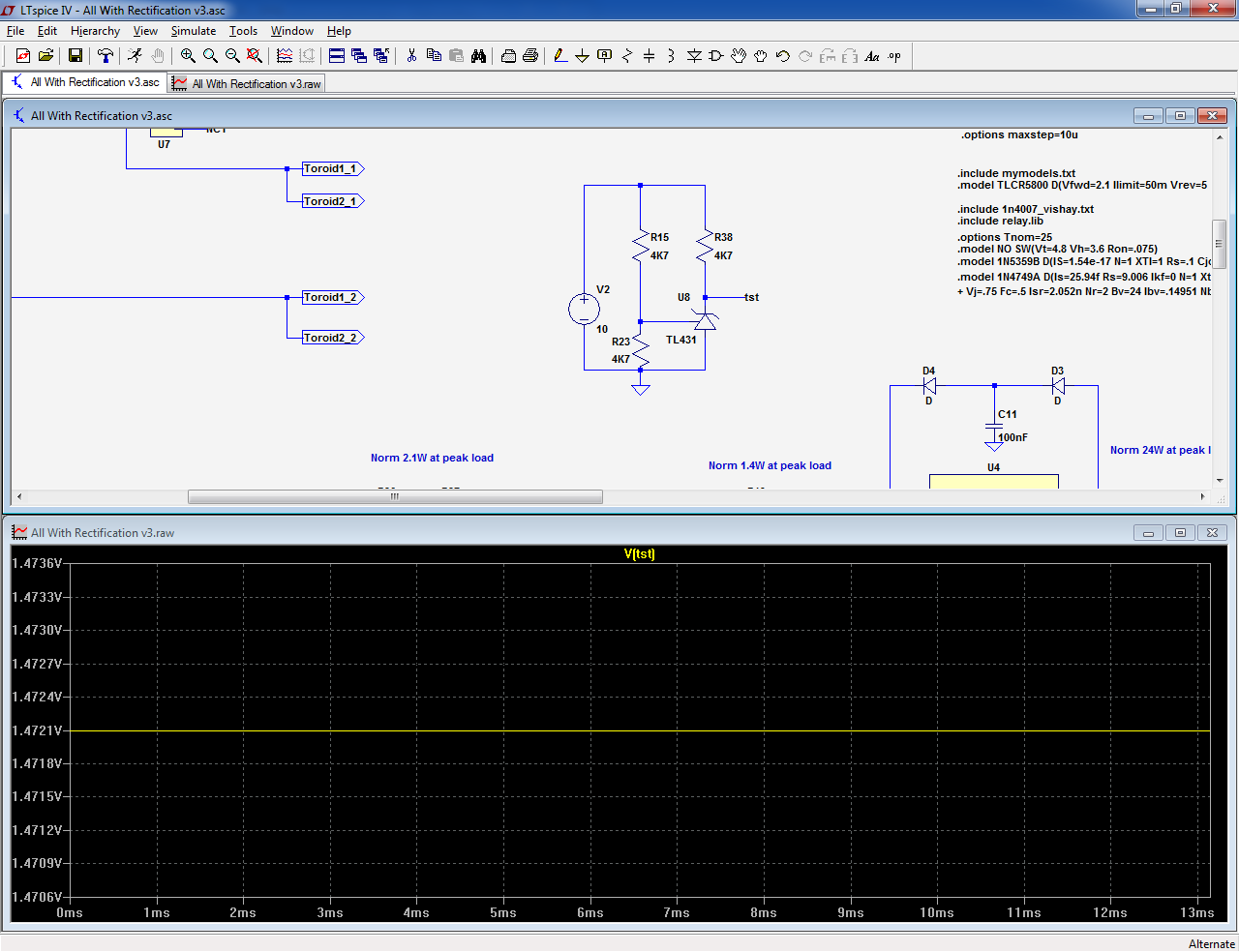

I guess that since the output current can pull the output to -∞V, it does funny things to the startup conditions of the reg.
Try a reverse schottky on the output, or in the startup conditions, check the start at 0 option, or use a resistor as a load

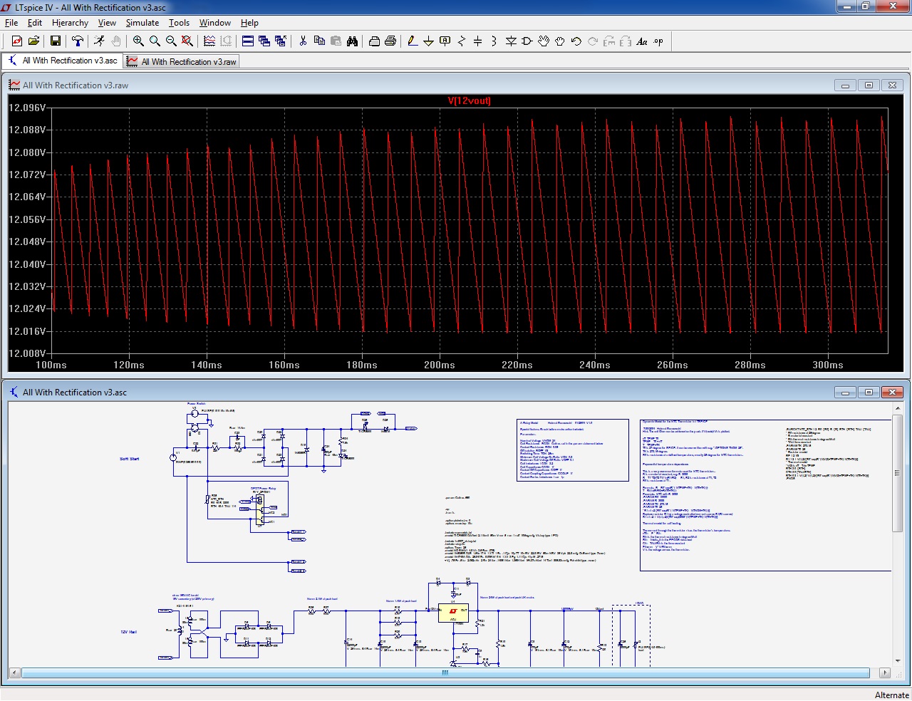

I ran through all the phase margin testing on the 12V rail with the reg output caps and 100mA quiescent current generating resistor* in the sim, but I did not include the "load capacitance" in this work - in large part because the actual load capacitance is unknown and can only be guestimated or, as I did, one can assume the level in the ATX spec. A tiny amount of series resistance (I added just 40 or 50 milliOhms) cleared the issue in the full AC-driven PSU sim. When I did the phase margin tests with the circuit in post one (with the obvious required changes to break the loop etc for this analysis) I stepped the load and checked each increment and all was fine.
* I found I had to create a minimum current of 100mA as the circuit was unstable at very low loads. I figured the resister was the easiest way to get around this issue.

The odd thing is the output impedance issue doesn't present itself in the 5V or 3.3V circuits. And, of course, there don't appear to be issues in noise rejection, phase margin and transient tests with a stepped load.

OK, as I suspected the problem was caused by the start-up conditions: using a resistive load solved it.
As for the instability, the LT1084 doesn't seem to have any requirement on a minimum ESR, but since you have hugely increased the loop gain with the TL431, it could become an issue.
The large cap value may also trigger the current limit and cause strange interactions
Meaning it is a LTspice peculiarity? Odd that it doesn't appear in the other rails which use the same load configuration. Must be something more to it, no?
On the second pic, it is not possible to see the change you made but I assume you removed the 50 milliOhms of ESR from the load capacitance. The oscillation was driving me nuts until I realised I had just dropped in a perfect cap and so tried a little ESR. (The load capacitance was added to observe in-rush conditions. It's obviously not part of the PSU rail.) I'm sure Mark's links will provide the detailed explanation as to why. The many capacitors on the board being powered will easily fulfil that requirement (and the level of stabilising ESR may well be lower - I've not solved for the threshold level).
Yes and no: in real life, there is little chance the load is a current sink capable of going to 0V and beyond, but if it happened to be, you'd observe the same kind of behavior.
Note that with the real circuit, the startup might end to be much trickier that it is in sim, and it is possible it won't even start with a resistive load

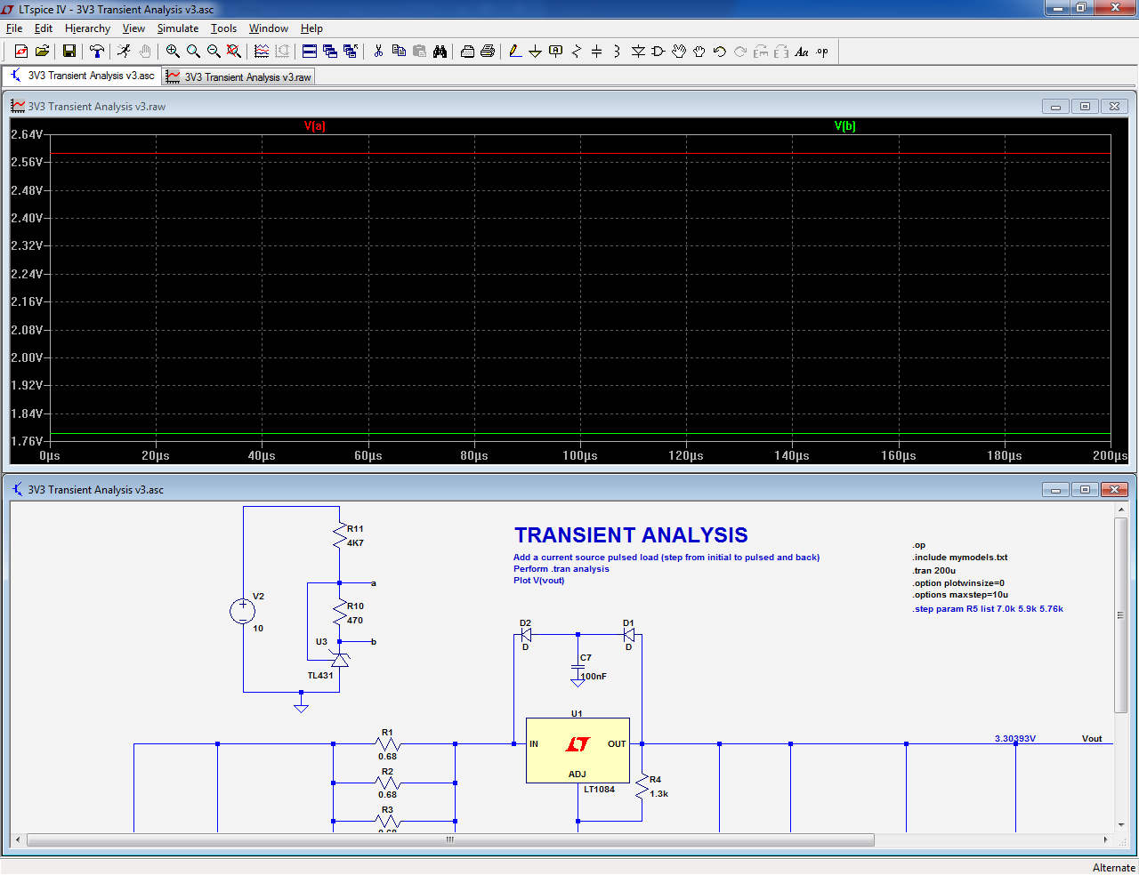

How do you get 3V3 with this configuration ?
For the 431 Vref=2V5 and Vak min=Vref.
Then Vref of the LT1084 is 1V25 ,gives a min output 2.5+1.25=3V75 ???
And why using a 431 for a job that can be done by the LT1084 alone ?

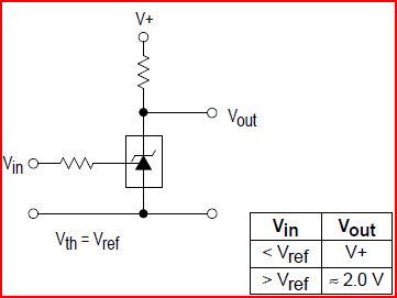

The output terminal of the TL431 is not limited to 2.5V: it can produce any voltage necessary to keep the reference terminal at 2.5V, within its physical limits: the saturation voltage and and its breakdown voltage.
Thus, Vout>2.5V and Vout>1.25V+Vsat, whichever is greater

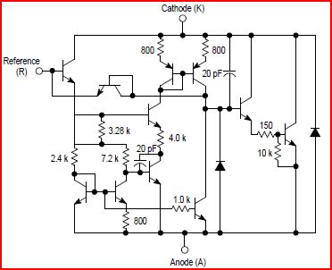

Hm,don't bet on it.The data states clearly Vak min=Vref
If you look at the (simplified) schematic, it's clear that if Vk goes lower than Vref the transistor at the Vref input goes out of business.
Mona
You are right in principle, but in practice there has to be a degenerated path allowing operation below Vref: I have seen it used that way in SMPS regulators and threshold detectors/relay drivers; saturation voltage was around 1V.
I made a quick test on SGK's model, and this one saturates at ~1.5V, higher than 1V but lower than 2.5V.
And I am pretty sure I have already seen a datasheet from an alternate source where this was specified.
Of course, it is certainly not a good idea to use an IC outside the guaranteed specs, even if it works (unless you have a robust explanation as to why it has to work)
