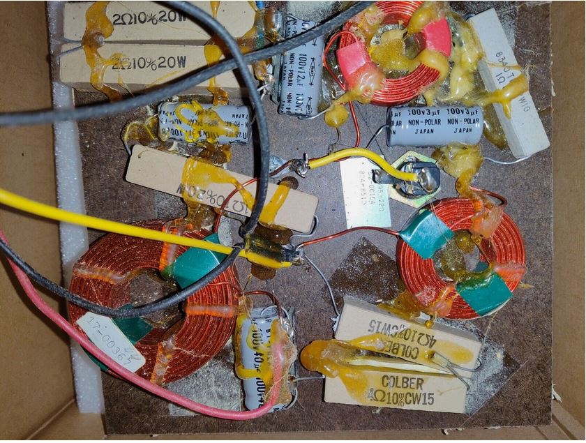

Thanks for the info! Depending on how large the XO gets I have started from scratch and then mounted it behind the tweeter. My method is to glue a piece of 1/2" MFD to the inside back panel that has pre drilled mounting holes for the actual completed XO. Then I can install and remove the crossover as need. The Maestro is Jensen's version of the Advent 6003. Jensen reduced the cost and complexity of the XO along with making a more conventional speaker cabinet dimensions. From the Frequency Graph of my Maesto's, I am hesitant to jump into that design mental gymnastics as you have. The frequency graph of OEM Maestro crossover is not ideal with a variance of about 10 db between the low and the high. There is about a 6 db upward slope from 1.8K to 10K which may account for the tendancy to be a bit bright. With my old ears I can use the high frequency bump! :>) In my searching, I found an image of the original 6003 XO which I have attached for your reference. Hey, it did have Japanese electrolytic capacitors! :>)

My take on it is that the 6003 components needed resistors to adjust them to match the other components. This leads me to conclude that with the crossover in place the 6003 resulted in a reading at the terminal of 8 ohm which they were shooting for. Once the resistors are pulled out the ohm of the speaker are changed. My view is that when Jensen bought the company, they inherited the 6003 components so they designed the Maestro which could be manufactured at less cost by changing the complex cabinet of the 6003 to a box cabinet. They then simplified the XO and let the chip fall were they fell.

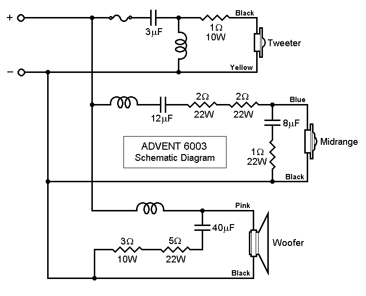

Here's the schematic someone drew of the crossover

If I do the calculations based on the impedances of the drivers I have, the caps are off based on the listed crossover frequencies.
The midrange driver would need to e 23 ohms and the tweeter would need to be 12 ohms in order for the caps to be correct, unless there's a reason to use lower value caps such as possibly making the drivers better at the crossover frequency.
To make the caps correct with the driver impedances the crossover frequency is then 10kHz midrange to tweeter and the woofer to midrange is 1.326kHz.

Here's where I got the schematic from.

With the 6003 crossover there's 4 ohms in series with the midrange so the midrange is being attenuated by 3.67dB assuming my measurement of 7.6 ohms impedance is correct.
The tweeter is 5.3 ohms and has a 1 ohm series resistor so it is being attenuated by 1.5dB.
With my modified Maestro crossover the tweeter is attenuated by 4.2dB and the midrange is attenuated by .955dB.
To attenuate the midrange properly without altering the crossover I'd need a series resistor of 2.96 ohms and a parallel resistor of 16.36 ohms. I could use a 3 ohm ands 16 ohm resistor for an attenuation of 3.73dB which more than likely won't be an audible difference.
To attenuate the tweeter properly I'd need a 1 ohm resistor and the cap would need to be increased to 5.5uF which would require a 1.5uF cap in parallel with the 4uF cap.
Hmmmmmmm I found a discrepancy in the crossover calculator I used.
If I change the crossover frequency between the midrange and tweeter it also changes the value of the cap in series with the midrange.
Not sure that should be happening as the cap is the high pass for the midrange unless I'm missing something here.
