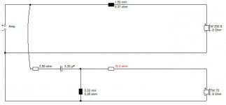

I've been pondering Speaker Dave's update to the Acoustic Research AR4X. He's addressing the roughish peak at (1.2kHz) crossover really.
What he's done, IMO, is give the woofer a lot more rolloff at 2kHz (around 6dB) with the Zobel. This must be good, because those of us who have heard these speakers always disliked the cone breakup from the woofer.
You don't then need to do a lot to the tweeter filter, but you can implement a second or third order now with good phase. Which again must be a good thing, because anything you do for steeper rolloff with a tweeter gives it an easier ride.
The Advent's crossover is a bit higher I believe, but the idea remains good. I'm really fairly clueless what values are appropriate here, but the Zobel must be around 40uF and 7.5R for a 6 ohm DC woofer.

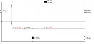

Hence I have had this WLM La Scala design in mind for a long time:
WLM, or reviewers anyway, say they cross that Visaton TW70 tweeter over at 1.2 kHz, though I find that hard to believe. But it may be a modern reincarnation of the AR4X.

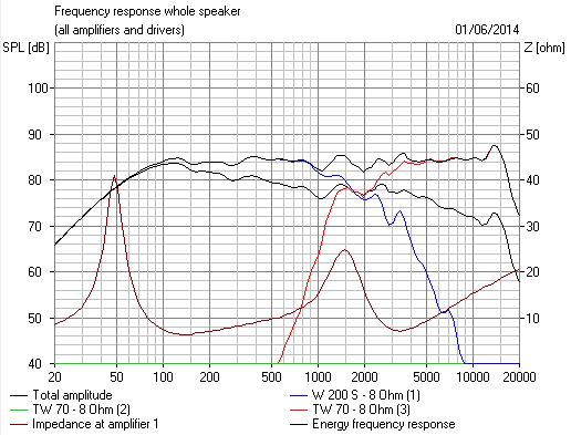

FWIW, here's a rough sim of what the AR4X Zobel and tweeter filter modification does, since you asked for graphs. The Fs of the TW70 is 1400Hz.

There's a lot of life in first order crossovers, Carl, especially with commercial speakers. I looked up the details of the B&W 685, and surprise, it's just a 1.35mH coil on the 6" Kevlar bass and 4.7uF on the metal tweeter. 🙂
Cone tweeters get very little interest here, but those of us who have tried them like them. They also seem to tolerate a lower crossover than most types down to including the Fs peak in the overall response.
I've not tried all the options with the WLM La Scala Visaton W200S and TW70 drivers yet, but first order tweeter seems to model very badly unless you take the crossover very low to around 1.5kHz with a Zobel on the bass. I must order some biggish tweeter coils around 0.5mH and see what I can try next.
Your higher order filter on a cone tweeter makes a lot of sense to me. They really seem to need that.

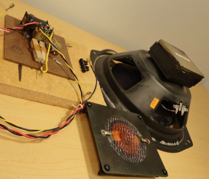

I do take this basket damping problem seriously. It gets even worse on a very rigid baffle due to the energy involved and lack of absorption IMO.
But you may have solved the rattling and ringing issue for me indirectly here. I think I need to do a really good rubbery gasket around the cutout and perhaps not overtighten the bolts. Baskets don't ring much when sat on a rubber gasket. Dave Smith will be familiar with this from KEF days where they decoupled bass units on rubber.
I'm going to rebuild my workpiece with a modified Advent-type crossover over the next couple of days which also decouples the voicecoils a bit from the magnet with a higher source impedance. This is an 8 ohm crossover of course. We'll see how this goes. 😎
Dug up a few Advent pictures here too. Lots of Masonite in evidence...LOL

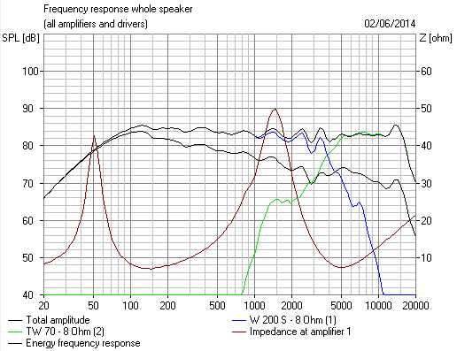

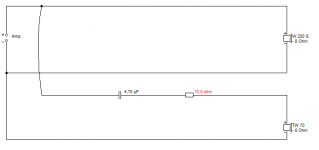

Very enjoyable days work on gaskets, since it seems good to damp the baskets a bit. 🙂
I built a thick cardboard one for the woofers and a rubbery one for the tweeters. The tweeter really benefited and I've kept it. But I didn't find the woofer did, so I ditched that.
I also did some AB testing between my simple 3.5kHz filter and the complex one. The complex one was more detailed and energetic, but really, there is nothing not to like about the simple one. So I'm using the simple one now! 😎
I also tried a 7kHz tank of 22R and 0.33uF across the woofer BSC coil to reduce cone breakup or hash. More detailed sound, but overall I didn't like it.
So really, I'm thinking you Advent fans should fit a second order tweeter filter and leave it at that. Quite where the crossover point should be depends on how the woofer rolls off, but I'd be thinking about 3kHz, so that might be 8uF and 0.15mH for 4 ohms and some input resistance at least.
