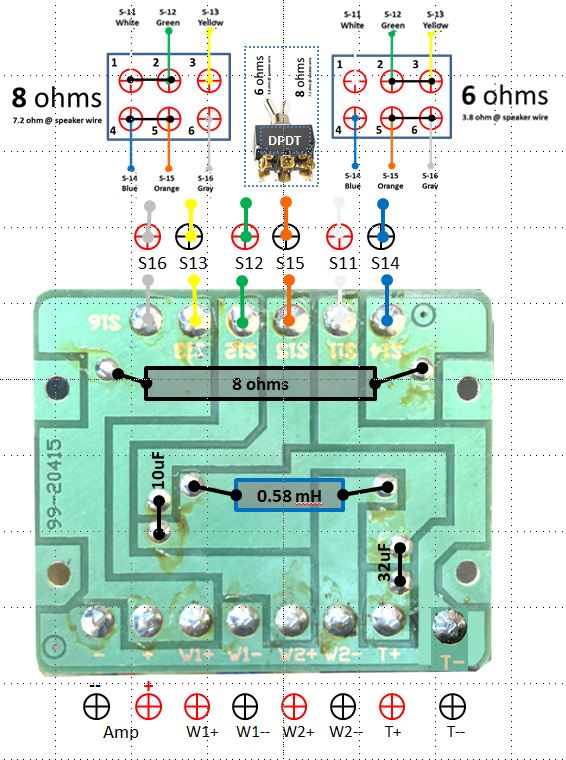

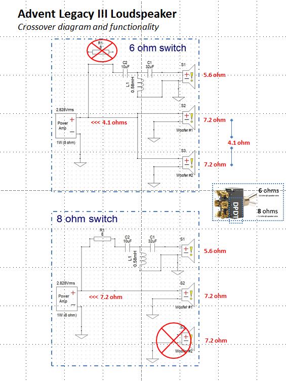

Hello all! I recently acquired a nice working set of Advent Legacy III speakers. This is the version that has a dual 7.1ohm voice coil woofers. The switch changes the crossover to yield a 6 ohm (normal) speaker OR an 8 ohm (when multiple speaker sets are used) speaker. Attached is a diagram of the PARTS and connections I have identified. I am stumped as to how to draw out the two XO circuits. For those who like a puzzle, my request is if any of members could draw out the diagram for the 6 ohm crossover; 2) The diagram for the 8 ohm crossover. Thank you and enjoy the challenge! I am eagerly waiting! :>)

The tweeter has a third order filter, 10uF/0m58H/32uF.
The 8 ohm toggle turns off W2 and puts the 8 ohm resistor in series with the tweeter.
The 6 ohm toggle puts W2 in parallel with W1 and connects the tweeter without the resistor.
