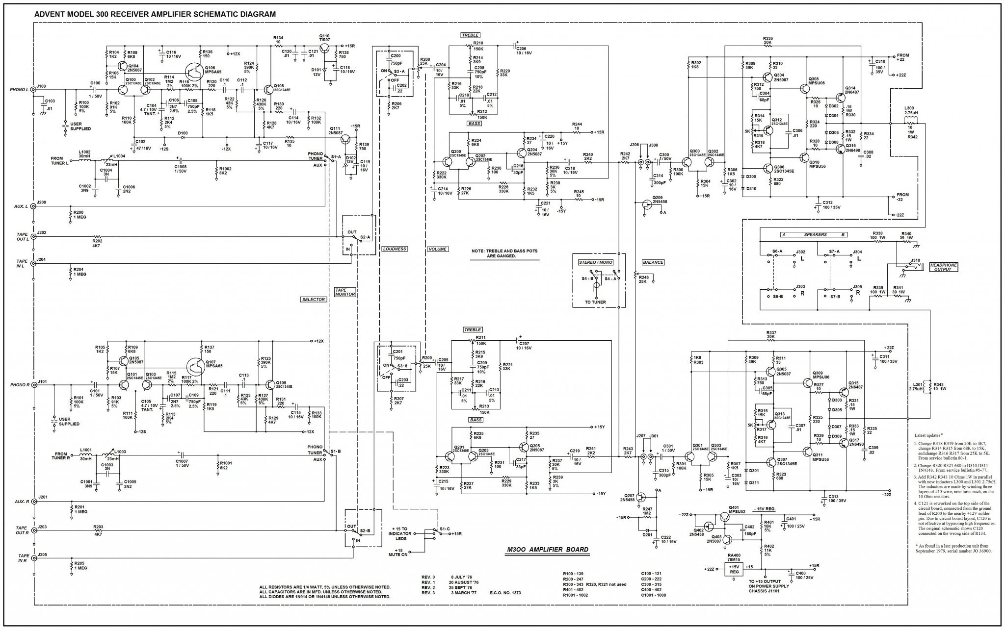

I think I might have had a minor breakthrough. I plugged the amp into the mains directly and within a few seconds the 3 amp fuse on the negative rail blew. That at least pointed me in a certain direction. There's a Mosfet (Q402) that according to the component list is "selected" and colour coded yellow. The paint on the top surface of the FET is cracked as if from overheating. There's a clue. So I'll remove it and check it out. Of course it may not be available these days....ho hum.
Q402 and associated parts are low power, unlikely to fail and even less likely to blow a 3 Amp fuse. Read post #20 again. You probably have a shorted output device, Q314 - Q317. Check with the Advent 300 unplugged from the mains and use a meter to measure resistance collector to emitter for each output transistor. If one or more devices are shorted, Mouser has replacements. Check the driver transistors too if an output transistor is shorted.
