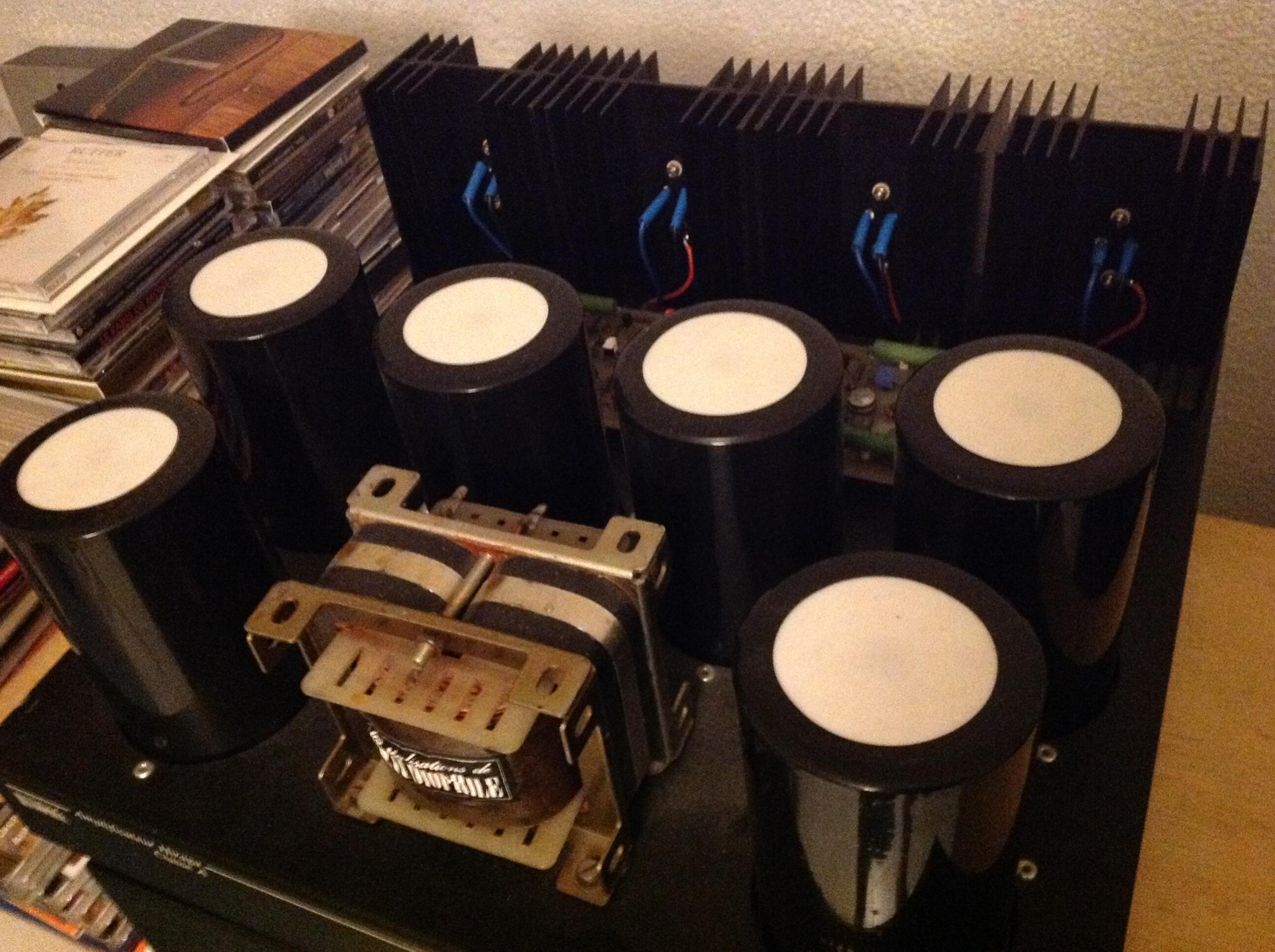

Do you have ready use 20 watts class A with such 1F caps in the psu ?
My are 450 000 uF for mono channel.
He play rock stable and solid sound have his subtle details charm as well.

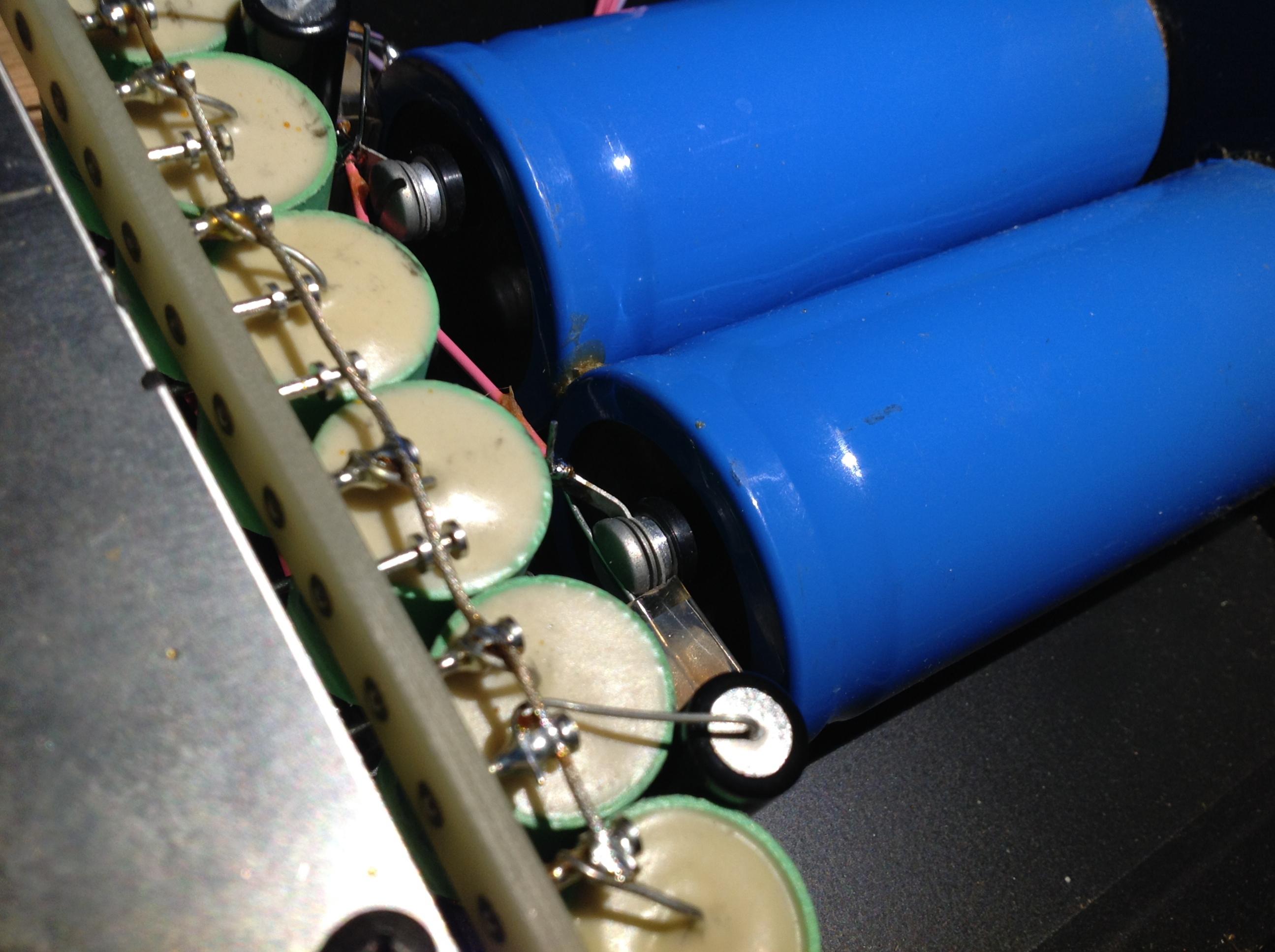

As a general rule smaller capacitors have higher ESR and less inductance, see random spec sheet here: http://www.vishay.com/docs/28342/058059pll-si.pdf
But if I am not wrong, if you parallel many small caps, also the ESR goes in parallel so if you put 10 of them, you have to divide by ten.
D
D
But if I am not wrong..
D
That's correct but don't forget the resistance and inductance of the connections between the caps. For an example of a poor implementation, six inches of 24 gauge wire is around 0.013 ohms or over half the ESR of a 10 volt 33,000 uF cap on that sheet.
It's doable, the details count.
I do and have recommend it on this Forum.Would anyone use 24 gauge wire in a power supply?
I wouldn't use anything smaller than 16 awg.
