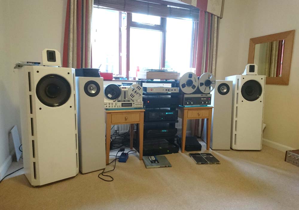

There are also a few designs (called monster miniOnken) where there are only cabinet drawings. Here an example of the miniOnken for the Goodmans Axiom 201 (next to Frugel-Horn XL).
